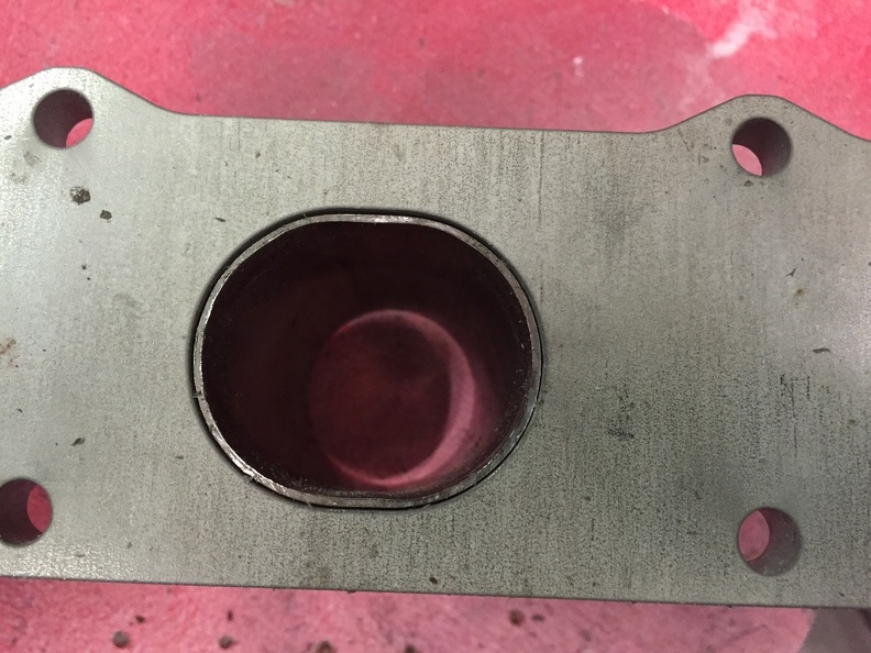

Derek Posted June 2, 2015 Author Share Posted June 2, 2015 (edited) They call him "Stubby" Very happy with the fit. Made a mandrel to form the ovals. Should make for a nice looking header. Remember kids good fabrication is all about joinery. The better the fit the smaller the weld. The smaller the weld the less the warp. The flange and header will be mill finish. Going out today to Xnke for fabrication. Edited July 7, 2017 by Derek Quote Link to comment Share on other sites More sharing options...
azcarbum Posted June 2, 2015 Share Posted June 2, 2015 looks perfect. Quote Link to comment Share on other sites More sharing options...
