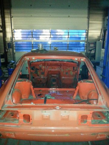

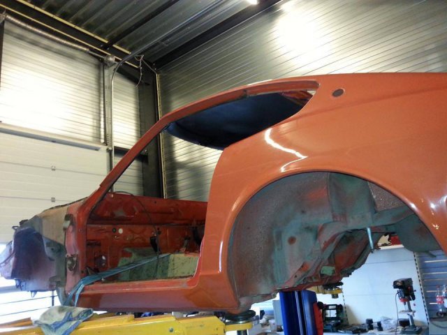

jos260z Posted February 26, 2015 Author Share Posted February 26, 2015 yes it would be a complete ground-up fabrication, with everything from the skyline R33like subframe, shocks, arms, rods everything.I have all parts in stock, but I was hoping that someone had already done a project like this.This is what we get now..... Quote Link to comment Share on other sites More sharing options...

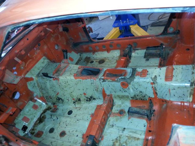

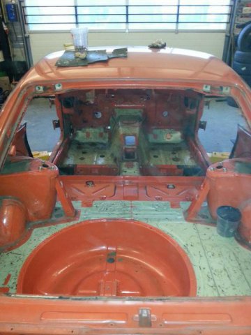

jos260z Posted February 26, 2015 Author Share Posted February 26, 2015 Inside, no rust Quote Link to comment Share on other sites More sharing options...

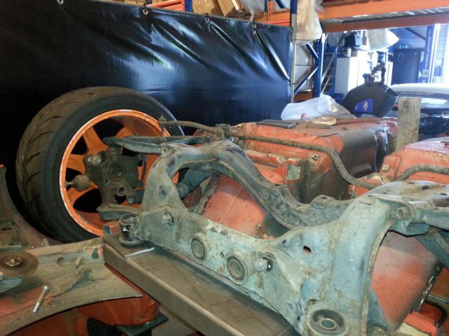

jos260z Posted May 10, 2015 Author Share Posted May 10, 2015 Just started, to fit my R33 Rear subframe into the Z Quote Link to comment Share on other sites More sharing options...

Phantom Posted May 13, 2015 Share Posted May 13, 2015 You certainly got a nice body. I haven't seen one that clean in a long time. If you start cutting on the unibody be sure to weld in some temporary bracing ahead of time. You probably already know to do that - but just in case - I wouldn't want the body to distort on you. Quote Link to comment Share on other sites More sharing options...
