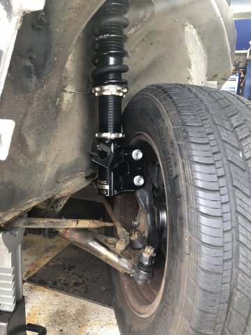

Jethoncho Posted October 30, 2018 Share Posted October 30, 2018 (edited) I’m doing a conversion to S14 front spindles, 5-lug hubs and brakes to my 280Z. BC was very helpful, they sold me a 280Z upper coilover that the fitted a S14 lower mount to. I have it all mocked up in the car but I am still looking for a solution to my tie rods being too long. Don’t want to hijack this thread but I wanted to mention BC was very helpful with this project...great tech support and customer service. They quoted me 4 weeks for the custom build, the coilovers arrived on my doorstep 4 days after I ordered. Would be great if other companies performed like this! Edited October 30, 2018 by Jethoncho Quote Link to comment Share on other sites More sharing options...
