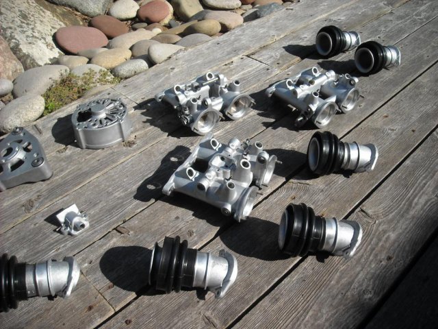

I got the throttle bodies torn down, cleaned and coated with Por15 Glisten, very tough stuff.

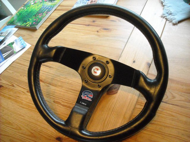

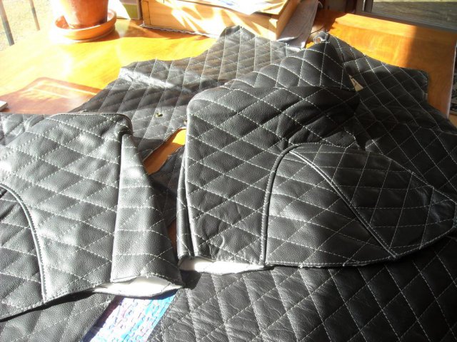

Found a 1981 MOMO steering wheel at a swapmeet, it will go well with the 350Z seats and leather interior.post-28202-0-00286500-1465771135_thumb.jpgpost-28202-0-12319600-1465771745_thumb.jpgpost-28202-0-17486000-1465771781_thumb.jpgpost-28202-0-16113200-1465771936_thumb.jpg

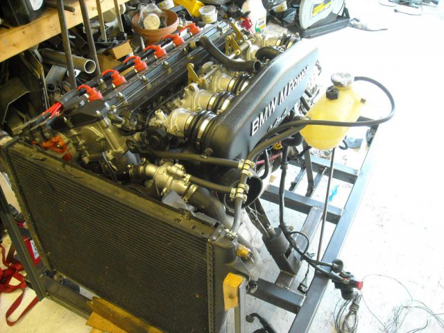

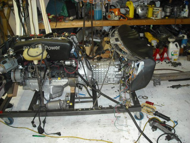

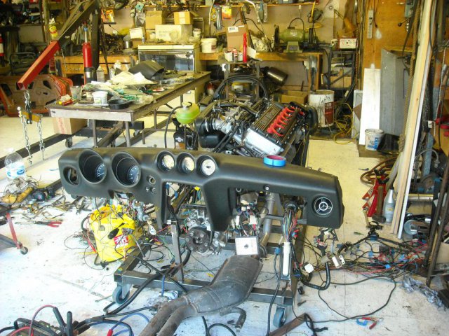

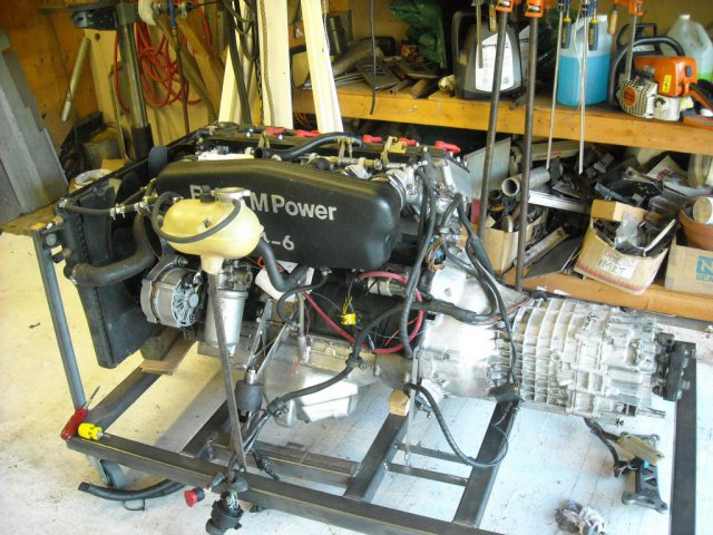

I got the engine test rig built and have almost finished the wiring to get the engine running then I'll need to integrate the Datsun harness so the two work together.

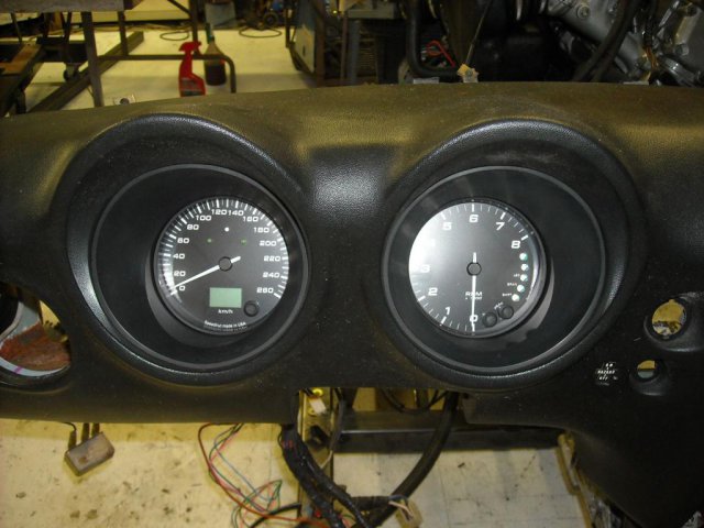

The Speedhut gauges arrived and they fit perfectly into the gutted housings of the gauges I am replacing.post-28202-0-40529800-1465772486_thumb.jpgpost-28202-0-24815100-1465772516_thumb.jpg

Smart work on the test rig, should save your back from a lot of pain, and streamline the wiring process quite a bit!
Thanks guys, you know even with the everything exposed on the test rig with easy access to every part and wire it's still a feat of patience and concentration to run through every wiring path and system. I think it would have a been a bit of a nightmare to have just dropped the engine in and then try and figure it all out. I think I may be able to start the engine up by the weekend, just have to wire the gauges in now .

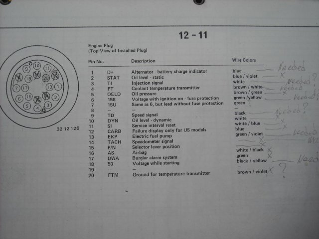

I got the engine turning over and figured out that a lost burglar alarm wire was preventing power from getting to the main relay but now the fuel pump relay is being difficult, I have pwr on #30 and pwr on #86 but not #87, I can jumper between #86 and #87 and the pump works fine, I have tried 4 known working relays with the same result,  I'm shaking my head. The last pic is the diagram of the bmw wires coming into the 240Z, now I'm thinking maybe that #3 Injection signal is connected to the fuel relay some how.
I don't have the bmw instrument cluster anymore so I not really sure why the injection signal in needed inside the cab.

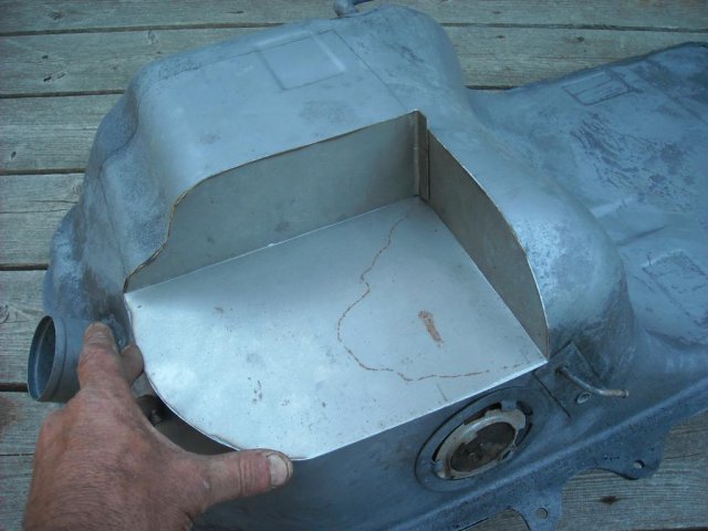

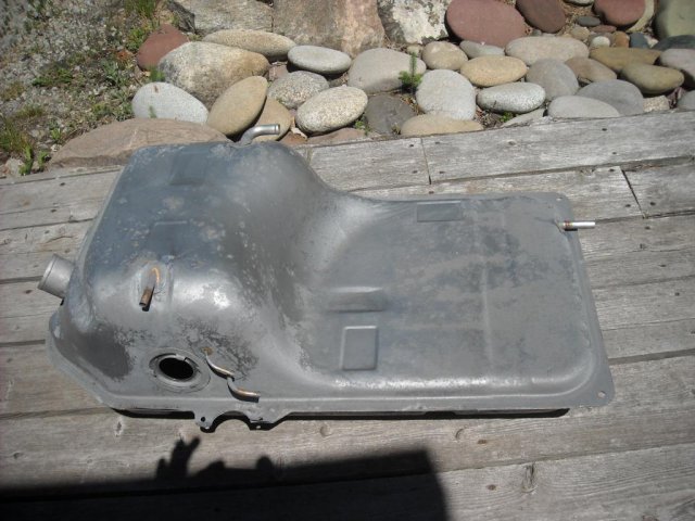

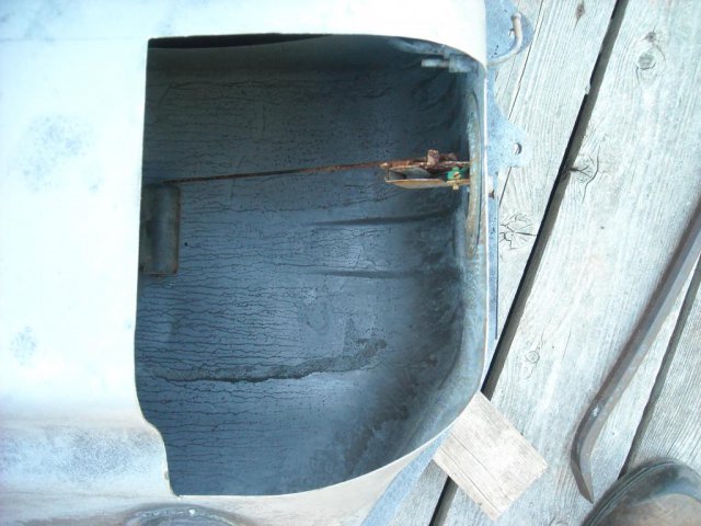

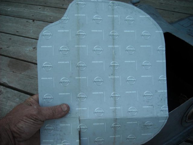

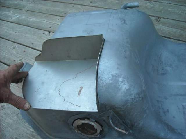

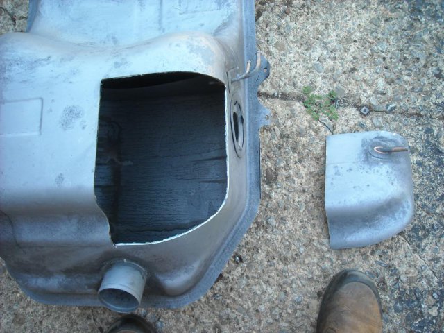

Not having much luck getting the M6 engine going, the ECU is not allowing the fuel pump relay to ground and even with a work around to get the pumps working the ECU is also not sending  the pulses to the fuel injectors or power to the Idle control valve. Hitting my head against the wall so I thought I would do something fun like cut into the gas tank. I got the tank back from the chemical dip place, they did a very nice job so now I need to weld in the seat for the bmw fuel pump.post-28202-0-61030000-1466808943_thumb.jpgpost-28202-0-45794700-1466808970_thumb.jpgpost-28202-0-72238300-1466808990_thumb.jpgpost-28202-0-75205300-1466809030_thumb.jpgpost-28202-0-74611100-1466809063_thumb.jpg
I even used Nissan cardboard for the template just to keep everything original :P

Here is the finished tank ready for install,

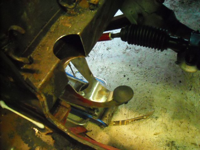

Have got a bunch of stuff done since my last post, installed the TTT offset tierods to compensate for the the lowered steering rack,post-28202-0-70938700-1476313764_thumb.jpg

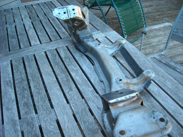

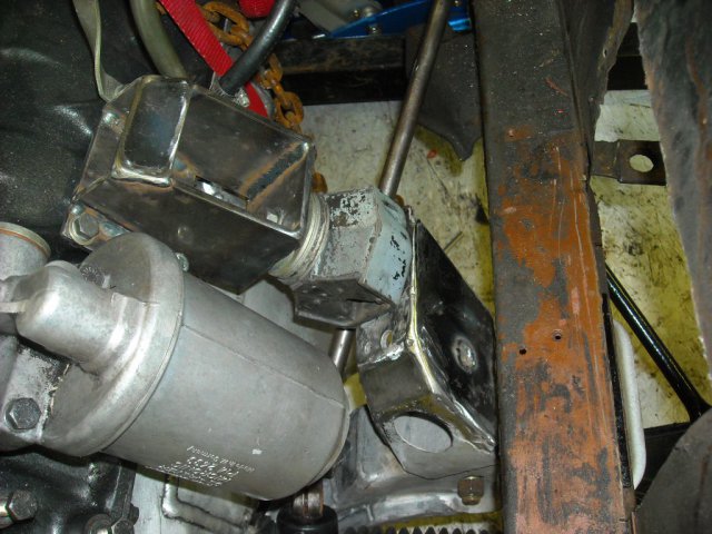

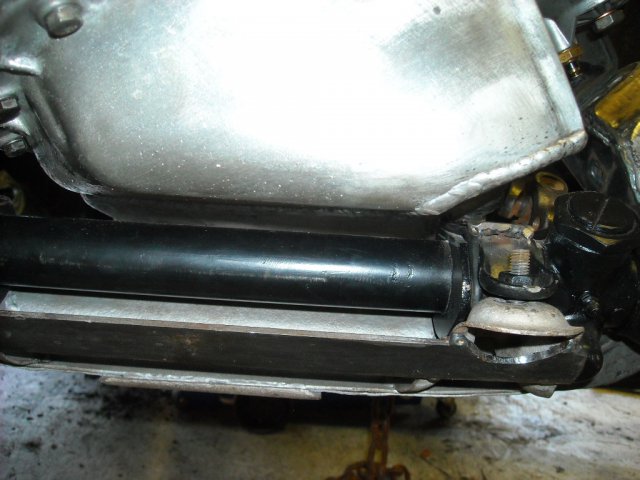

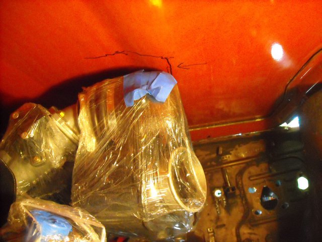

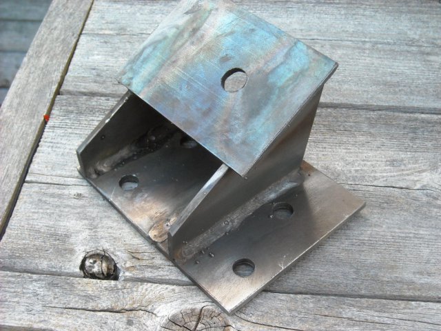

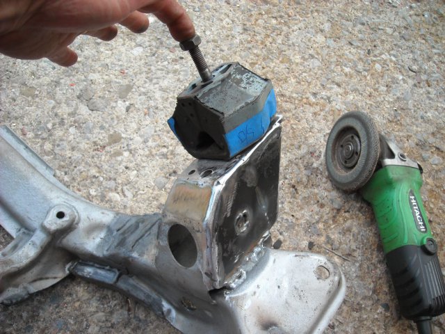

Built the engine and transmission mounts and modified the crossmember,post-28202-0-11519300-1476313882_thumb.jpgpost-28202-0-36844100-1476313909_thumb.jpgpost-28202-0-71490600-1476313946_thumb.jpgpost-28202-0-40099400-1476313996_thumb.jpgpost-28202-0-03541700-1476314010_thumb.jpg
So here is the room left to play with, about a 1/2" between the top of the engine and the hood and about the same with the oil pan and Xmember, post-28202-0-16827700-1476314044_thumb.jpgpost-28202-0-40919000-1476314108_thumb.jpg

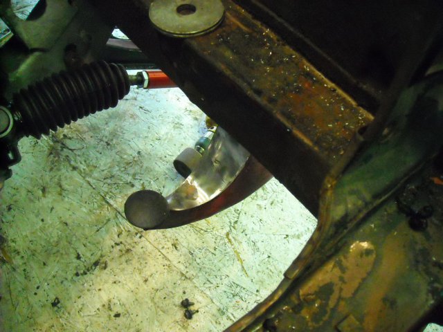

Built a skid plate to protect the oil pan, post-28202-0-55323800-1476314135_thumb.jpg

the gauges in that dash fit perfectly. Did you use 4.5" and 2 5/8"? Did you end up buying an electric power steering kit or did you find bits and parts, what made you want to go electric power steering?
Great work on fabricating everything up, great build so far.
Thanks, so far I'm really happy with the Speedhut gauges, they are 4.5" and 2 5/8th.

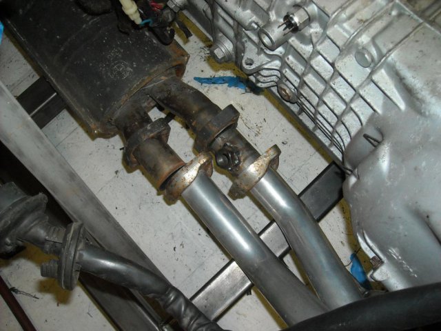

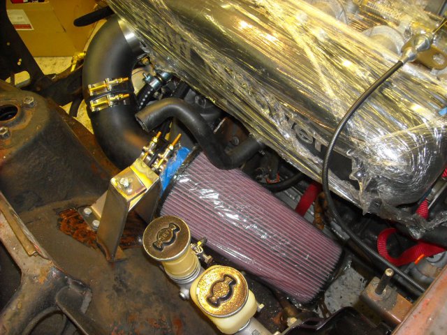

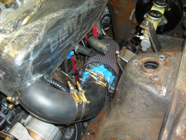

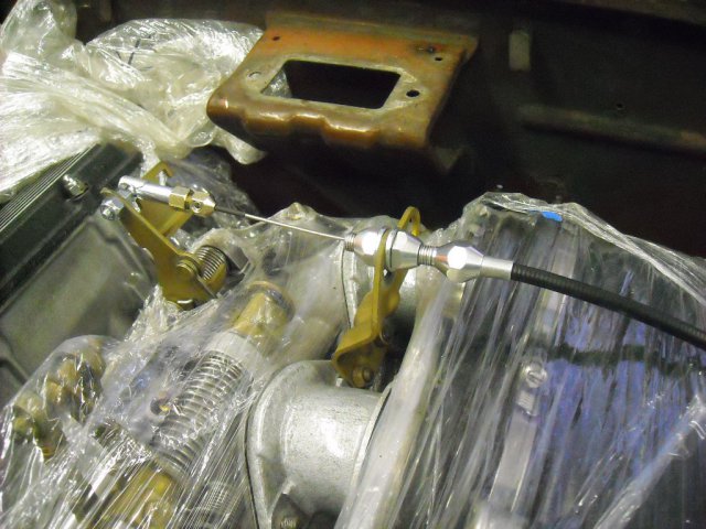

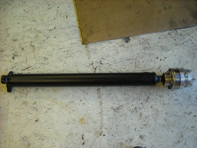

Well I have finally finish installing the drive line, engine mounts, transmission mount, drive shaft and diff are all in and I think, are perfectly a lined. As best as I can measure it I think I'm within half a degree in both axis. So hopefully the drive line will be vibration free :unsure:   Also got the oil cooler plumbed in, the accelerator linkage installed and air filter sorta finished. As much as I hate K&N filters I bought one anyway, after spending lots of money and time trying build or adapt a paper filter airbox that just didn't work.
The K&N filter will get me on the road until I can figure something else out.
This is the adapter I built to join the bmw drive shaft/CV joint to the Nissan rear end and it is as near a copy as I could make to the one Ron Taylor amde for his bmw/datsun swap.
Lokar cable,

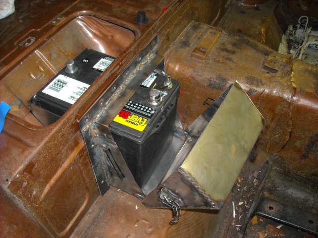

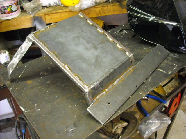

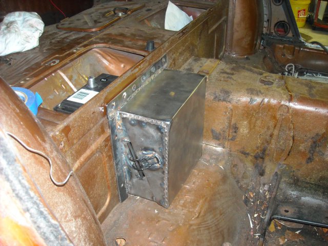

Finished building the battery box, post-28202-0-03262900-1479165511_thumb.jpgpost-28202-0-29028900-1479165545_thumb.jpgpost-28202-0-11792400-1479165565_thumb.jpg

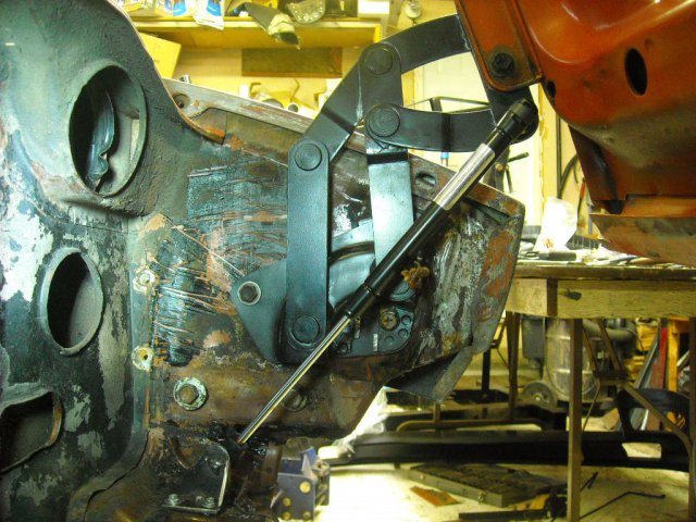

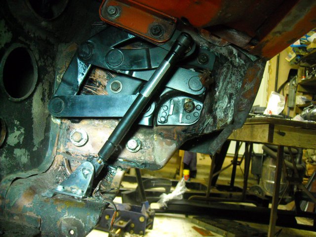

Got rid of the torsion spring hood opener and installed hydraulic springs, post-28202-0-44719100-1479165603_thumb.jpgpost-28202-0-95726600-1479165645_thumb.jpgpost-28202-0-26370700-1479165669_thumb.jpg
