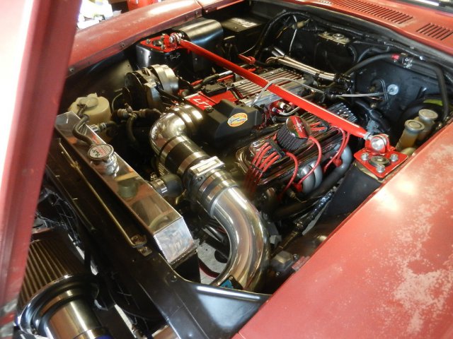

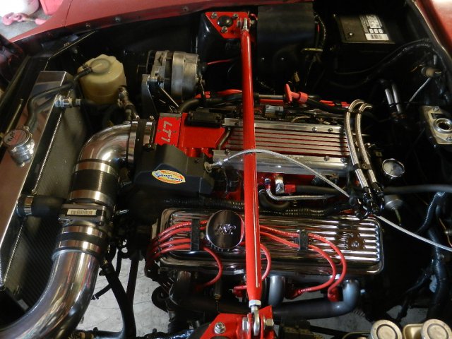

deja Posted February 1, 2016 Share Posted February 1, 2016 There is nothing about the new LT1 that remotely compares to either version of the two older LT1s. Chevy for some reason just likes the name! There was one in the early 1970s, redone in 1993 with very few if any interchangeable parts and now the new Corvette version which is totally new. I have been running my 280Z with a reworked '95 LT1 for 10 years and over 40K miles with no issues. Quote Link to comment Share on other sites More sharing options...
deja Posted February 1, 2016 Share Posted February 1, 2016 Boosting the LT1 could be tough considering its compression ratio. Plus unless you get a Corvette version you get a 2 bolt main bottom end. There is not a lot of speed equipment for the LT1. If you want 500 - 600HP it would be much easier to go the LS route. I love my LT1/4L60E but if I were going to do it again I get a LS3. Quote Link to comment Share on other sites More sharing options...
