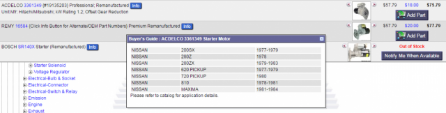

The 78 and on starters are gear driven, with an offset drive motor.  They seem to be reduction starters, but I've never actually seen the gears or a description of their ratios so can't say for sure.  They're not direct though, and it would be kind of pointless to offset them without taking advantage.  It should lessen the voltage drop allowing more juice for spark and other electronics, as noted above.  Never heard of the turbo car gear reduction starters, and the 78 + starters weigh less than the big motor direct drive pre-78 starters.  So it looks like three different types are out there.
At least one manufacturer describes them as gear reduction, for what it's worth.  Picture from Rockauto site.  Just a few more factoids.
