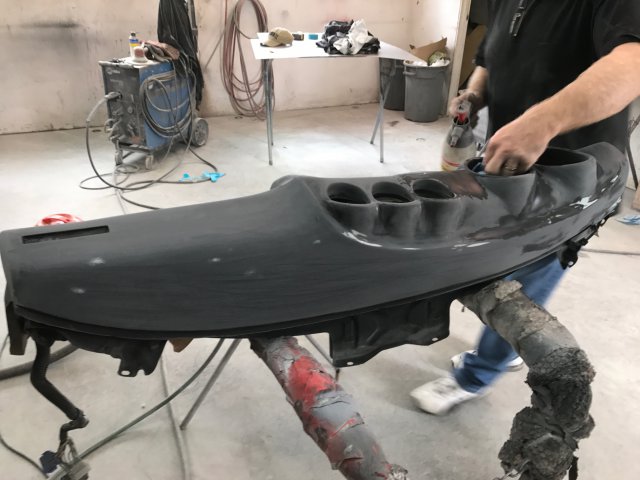

Derek Posted October 12, 2017 Share Posted October 12, 2017 Here is how I did mine. 1 Quote Link to comment Share on other sites More sharing options...

Derek Posted October 12, 2017 Share Posted October 12, 2017 Caps get a bad rep because they don't fit perfectly and then they are installed poorly. If you look at what I had to do in my thread in order to get it to fit you'll see that there is a ton of material that needs to be removed. Quote Link to comment Share on other sites More sharing options...

Derek Posted October 14, 2017 Share Posted October 14, 2017 On 10/14/2017 at 2:37 AM, jkelly said: Nice. I had just read through your post before posting. I'm kind of leaning towards grabbing a full cover from MSA and going that route. Yours looks really good. Do you have any more pics of the finished dash? Expand Those are all the pics I have. I will say that it is still in perfect shape with no de-lamination and up until I blew the motor it was parked out in the Florida heat every day. Realistically I'm thinking it's better than stock as far as longevity goes. I did the SEM fill the crack method and it just cracked in another place. Anything you paint on is a temporary fix. My experience thermoforming speaker panels made me realize the problem isn't the quality of the cover but the stresses put against it when you install it. Quote Link to comment Share on other sites More sharing options...
