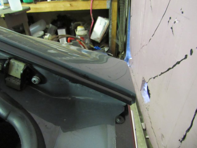

grannyknot Posted May 14, 2018 Share Posted May 14, 2018 Where to start? There is so many possibilities, I'm sure I can come up with a few for you but I'll start with this one, this is a mod I wish the factory would have done, there would have been a lot less rust in the rear of the Z's'. I just welded a 4" lip to the rain gutter on both sides, now instead of water pooling on the back deck lid it runs right off. 1 Quote Link to comment Share on other sites More sharing options...

jkelly Posted May 15, 2018 Author Share Posted May 15, 2018 All great ideas guys. I might start adding your ideas to the original post and link to each post. On 5/14/2018 at 5:37 PM, ZHoob2004 said: I'm in almost the same state and I'm taking the opportunity to replace (and simplify) the electrical system. Expand Did you end up going with an aftermarket wiring harness? On 5/14/2018 at 10:13 PM, grannyknot said: Where to start? There is so many possibilities, I'm sure I can come up with a few for you but I'll start with this one, this is a mod I wish the factory would have done, there would have been a lot less rust in the rear of the Z's'. I just welded a 4" lip to the rain gutter on both sides, now instead of water pooling on the back deck lid it runs right off. Expand Great idea! Does the original weatherstripping (or replacement) weatherstripping cover that extra 4" piece like picture or did you have to buy a different piece of weatherstripping? Quote Link to comment Share on other sites More sharing options...

grannyknot Posted May 15, 2018 Share Posted May 15, 2018 On 5/15/2018 at 2:11 PM, jkelly said: Great idea! Does the original weatherstripping (or replacement) weatherstripping cover that extra 4" piece like picture or did you have to buy a different piece of weatherstripping? Expand Not sure I remember, I think the replacement strip had extra length compared to the original. Quote Link to comment Share on other sites More sharing options...
