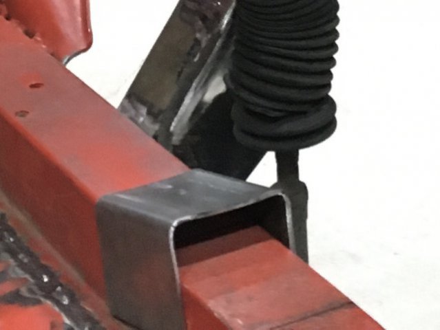

Started in on the chassis stiffening base plates.  Formed up some brackets/base plates made of 12 gauge (0.101") to slip over the frame rails to support the roll bar area and to wrap the top portion of strut towers.
412C12BA-1E58-4196-A0D4-1EE1607BEA81_1_201_a.thumb.jpeg.8c07d6b9328f267ea6cd83517d836357.jpeg
I tack welded the plate on then muscled them a bit to start wrapping around tower.  After about 30 degrees of wrap needed a BFH to wrap to a point where a clamp could finish drawing the plate to the tower.
