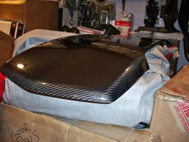

RB26powered74zcar Posted December 22, 2012 Share Posted December 22, 2012 I was going to put this one on but decided not to. It's the only CF piece in existence... Quote Link to comment Share on other sites More sharing options...
ZT-R Posted December 22, 2012 Share Posted December 22, 2012 I think I'm trying to hold out for Z force to make the 1 piece hood. I think it will flow much better. Quote Link to comment Share on other sites More sharing options...

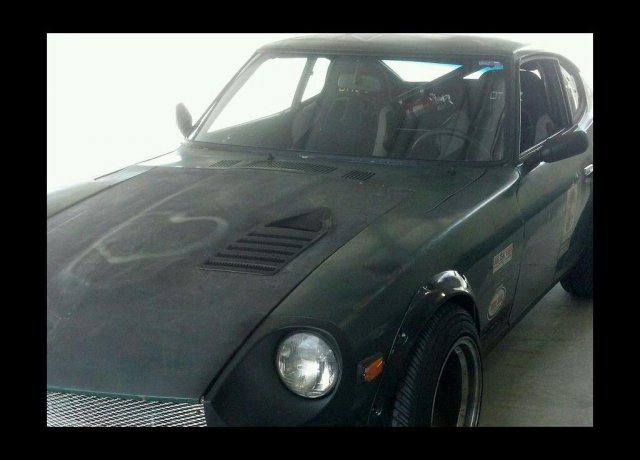

duragg Posted April 8, 2013 Share Posted April 8, 2013 (edited) Finished my hood scoop. My only goal was to assist in getting hot air OUT.. 280ZX turbo scoop in reverse with slight mods. I beat to my own drum, so don't get bent around the venturi with the effectiveness of reverse submerged NACA extractor coefficient .. We think it looks neat. Edited April 8, 2013 by duragg Quote Link to comment Share on other sites More sharing options...
ZT-R Posted April 8, 2013 Share Posted April 8, 2013 I like that duragg. What if you put a small little lip/angle just before the "extractor" part, that might help create a vac... Maybe... Quote Link to comment Share on other sites More sharing options...
duragg Posted April 8, 2013 Share Posted April 8, 2013 I like that duragg. What if you put a small little lip/angle just before the "extractor" part, that might help create a vac... Maybe... Yes, yes. I was thinking the same thing. I will do that tomorrow and repost Tj Quote Link to comment Share on other sites More sharing options...
AZGhost623 Posted April 8, 2013 Share Posted April 8, 2013 LOL you know... I think most people who see this for the first time are going to think you were drunk. Are you sure you weren't overly embellishing the alcohol on this one a bit, and then realized you put it in backwards? Is that a heart on your hood too? Peace and love were definitely on your mind with this one huh.... Quote Link to comment Share on other sites More sharing options...
AZGhost623 Posted April 8, 2013 Share Posted April 8, 2013 I was going to put this one on but decided not to. It's the only CF piece in existence... facebook_-143077172.jpg Why not? It looks great on mine, but its not CF tho. I did cut the hood up so its functional. Quote Link to comment Share on other sites More sharing options...
duragg Posted April 8, 2013 Share Posted April 8, 2013 LOL you know... I think most people who see this for the first time are going to think you were drunk. Are you sure you weren't overly embellishing the alcohol on this one a bit, and then realized you put it in backwards? Is that a heart on your hood too? Peace and love were definitely on your mind with this one huh.... Nothing as exciting, sorry. I gave the order and VanManSam did the cutting and install. The heart was spray painted by a certain fellow pilot we call Weasel months ago; he'll pay for that. Quote Link to comment Share on other sites More sharing options...
ZT-R Posted April 8, 2013 Share Posted April 8, 2013 Video a yarn test on that thing duragg... Quote Link to comment Share on other sites More sharing options...

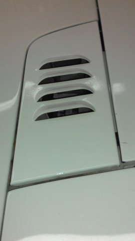

1 tuff z Posted April 9, 2013 Share Posted April 9, 2013 Do you guys think the louvered inspection lids will be effective to reduce under hood pressure? Quote Link to comment Share on other sites More sharing options...
ZT-R Posted April 9, 2013 Share Posted April 9, 2013 I just put some on mine. I see heat pouring out of it at idle, so cant hurt... probably need to vent more than that though... Quote Link to comment Share on other sites More sharing options...

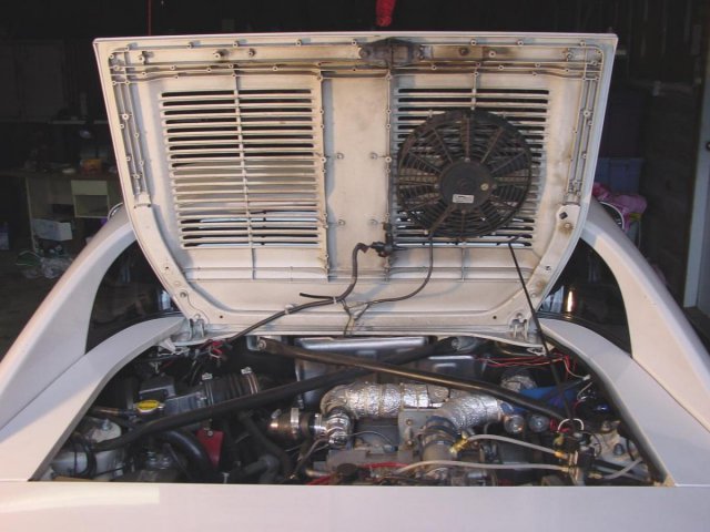

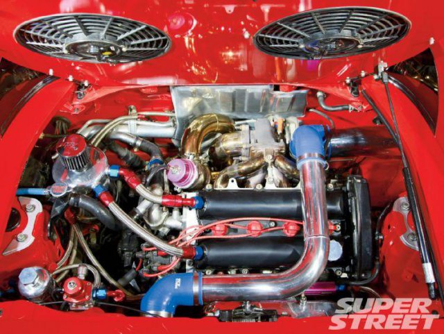

Miles Posted April 9, 2013 Share Posted April 9, 2013 CFM in = CFM out Do the math. One unique approach is to use under hood fans - see picture. Quote Link to comment Share on other sites More sharing options...
ZT-R Posted April 9, 2013 Share Posted April 9, 2013 Mr2's are a bit different as far as airflow over the engine though. But yes, what doesnt pay rent, must get out... Quote Link to comment Share on other sites More sharing options...
