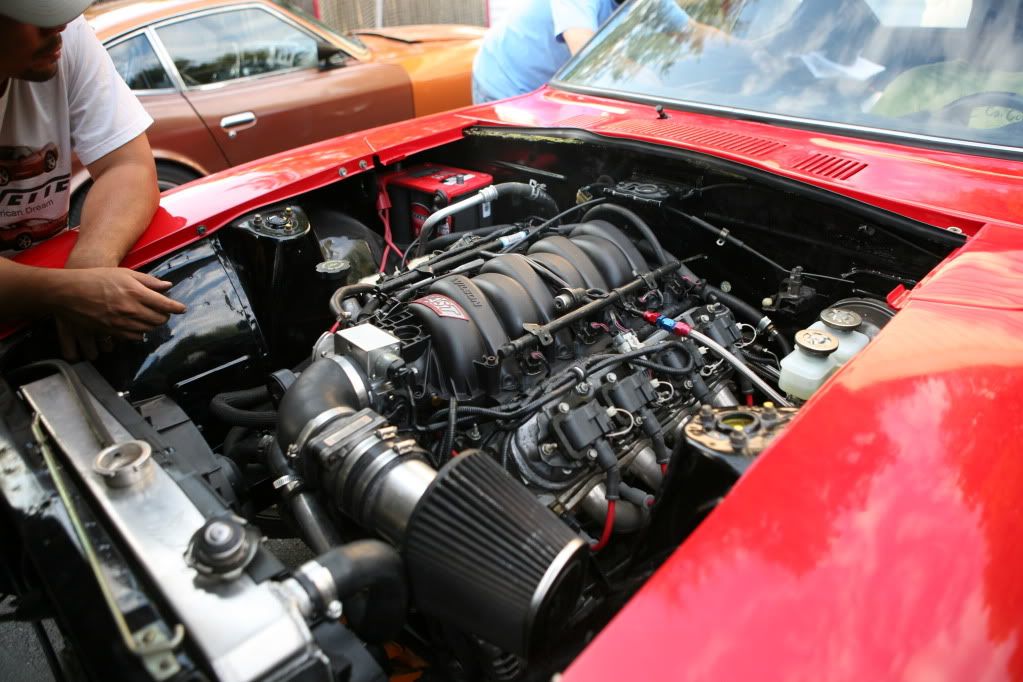

Bolts finally came in, so it was time to install the Fast 90/90. Really like the way it come out, just needed to plug a hole in the back of the manifold where the PO drilled and tapped it.
Still have to do more trimming on the fenders and air dam for clearance for the front wheels.
This is my update for now...o yeah...she started back up!

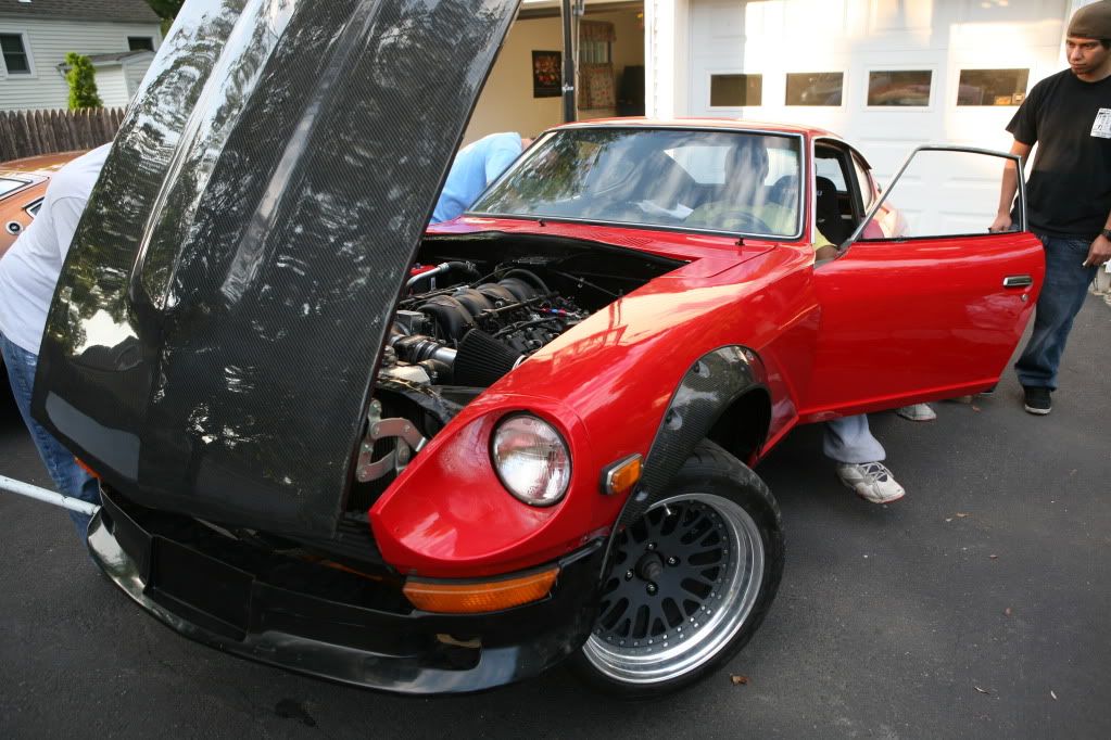

Front bumper mounted today.....rear bumper finally came today!....all gauges work! Glass was installed front and rear. I plan on towing the car to the shop to nut and bolt it because I found a few nuts and bolts loose from few months back when I was swapping from the old car. First drive is coming soon.
I have to thank, Joe...Jeff...Amiel...and Alex for coming by on Friday and lending a hand. I know Cygnusx1 (Dave) is coming by tomorrow to lend a hand with the hatch.
I'll be there in the PM. Got a big car show in the AM. We will need a grinder, hacksaw, drill, metric taps, hammer, torch...drinks....food. My fenders were pin straight for six years after the paint. Then came the turbo swap...now they look like a mogul run at Killington. When they get bad enough, I'll cut some fender louvers into the fender tops like the old race cars had.
Ok, so we took a little longer than Dave thought (not 15 mins a side) but here is another Z note for everyone: the reason my first mounts didn't have enough material vs the one Bartman had in his hatch write up is.....I cut the mounts from a series 1 240z hatch and the mounts needed needs to be from a later hatch. If you ever get two of them side by side, you will see exactly what I am talking about.
Anyway this is what we came up with today:
Little gap on top of hatch
I think that is caused from the CF hatch molding and not much I can do there...mounts and all are slotted. Last idea I have is to slot the hinge itself that mounts to the body.
Pasn side, little bit of a gap too:
Overall I guess the hatch isn't too bad. Not going to fit like factory but we shall see how close I can get it.
New look with the front CF bumper mounted:
Another update to follow.
