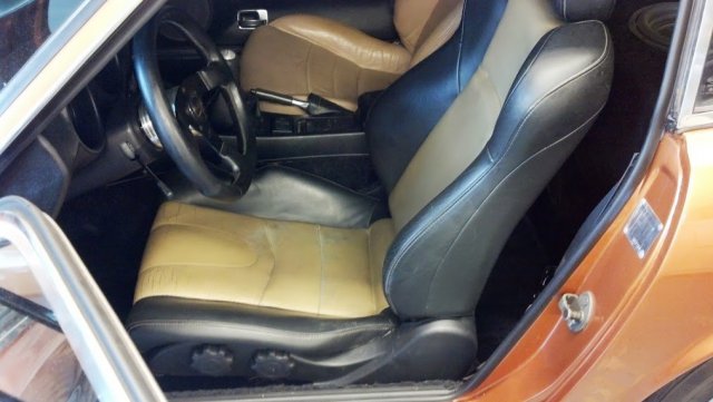

rags Posted July 4, 2013 Share Posted July 4, 2013 Well after a few years I've decided to pull the S2000 seats and install power 350Z seats. Got the drivers side in and all hooked up. I like it! If anyone is interested in the S2000 seats I'll let them go for $300 plus shipping. Quote Link to comment Share on other sites More sharing options...

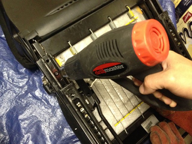

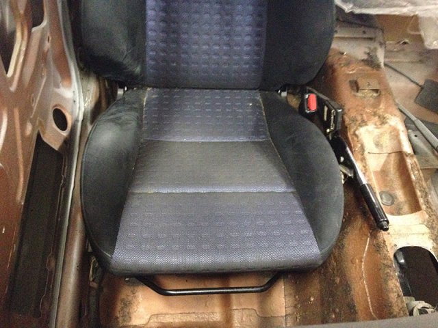

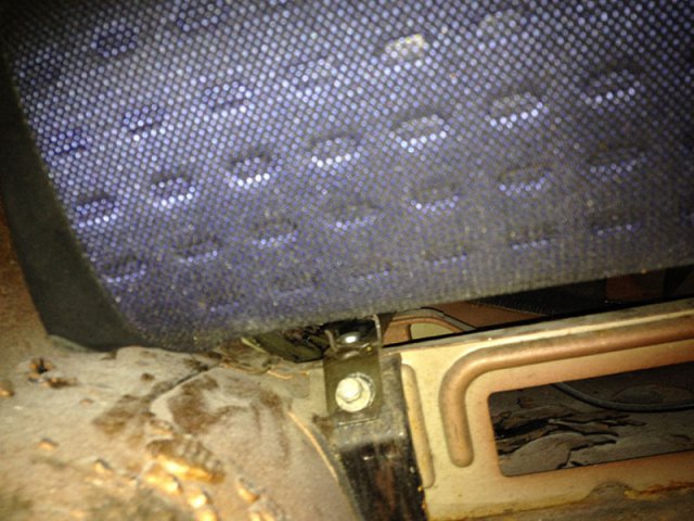

tamo3 Posted November 19, 2013 Share Posted November 19, 2013 I'm working on installing EVO8 seats onto my '75 280z. Passenger's side is no problem. Driver's side is the problem for 280z. The tranny tunnel/Exhaust tunnel is hitting the seat. I hit the floor by hammer hell out of it like a Barbarian, to create the clearance. In order to remove the original rail, I used heat gun the loosen up the loctite. It's so hard to remove screws. Quote Link to comment Share on other sites More sharing options...

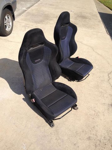

missinglink Posted November 27, 2013 Share Posted November 27, 2013 I am running Evo 8 MR seats from a Jap Import in my 240Z with a half cage. The Jap import seats seem to be a little narrower than the export seats (like Australia for example). I have used the sliders that came with the seats and redrilled the front seat mounts of the Datsun to suit. The rear seat mounts are custom and have been lowered to drop the seat height. I am only 5'6 so not such a big issue for me. With my race helmet on I have about 40mm of headroom. Quote Link to comment Share on other sites More sharing options...

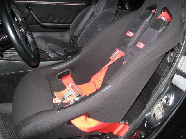

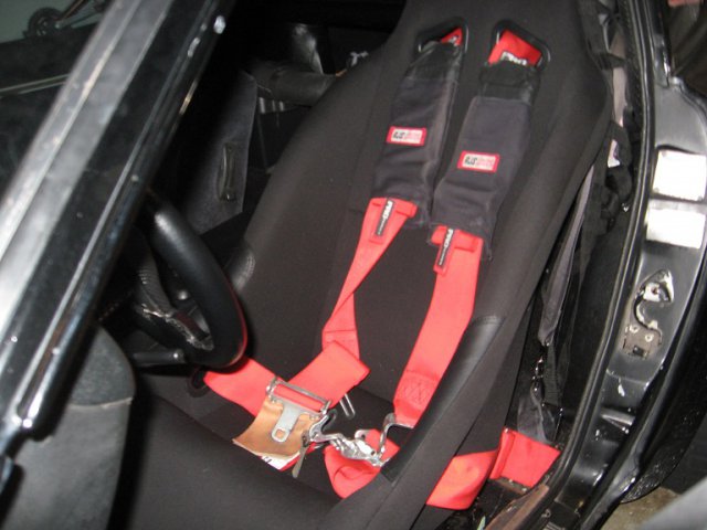

jhm Posted March 24, 2014 Share Posted March 24, 2014 (edited) This is the Corbeau Clubman installed in my late '74 260. Easiest seat install ever....the seat is narrow, non-reclining, and I did a "fixed-mount" installation (i.e. no rails). Fabbed mounting brackets from 1.5" flat bar, shaped to mimic the lower portion of the stock seat sliders. I plan on using this seat during the racing season, and then swapping my Recaro knock-offs back in for street use during the off-season. Edited March 24, 2014 by jhm Quote Link to comment Share on other sites More sharing options...
