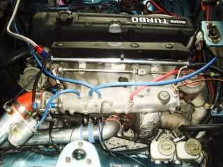

jacob80 Posted February 9, 2010 Share Posted February 9, 2010 It's a garrett t3 a/r 42 m24. Would this put me at 300hp at least? Thanks! http://smg.photobucket.com/albums/v160/simpleaznx/?action=view¤t=IMG_0009.jpg Quote Link to comment Share on other sites More sharing options...
