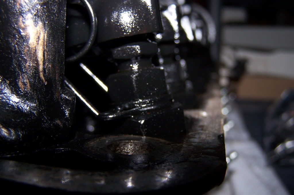

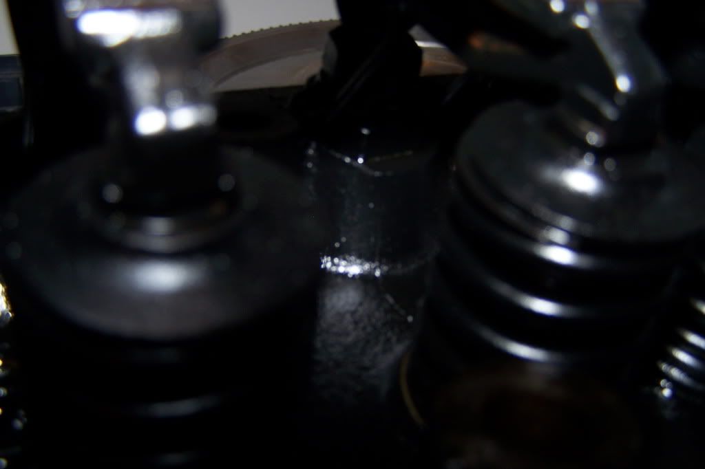

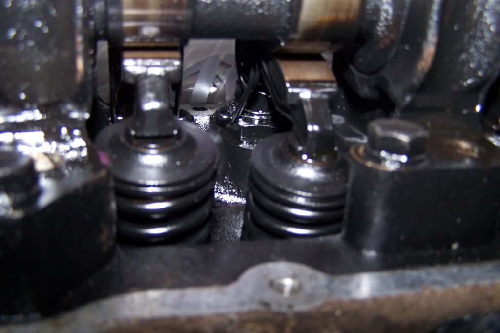

No, its an '82 and I've heard so many things about whether its possible you may or may not have solid lifters regardless of P90 or P90A. Just doing a double check!
I don't think hydraulics came with the mouse trap springs on them, however the rockers still had the groove for them to be used. Solid lifters should have in the order, the 6 sided hex to screw the lifter into the head, its a big 20mm or whatever, then a smaller 17-ish mm hex head for the lock nut, and then finally a 14mm hex head to adjust the height of the lifter. If you have hydraulic, you will only have the big 20mm that screws the lifter into the head. What you have is solid because there are three sections to fit a wrench onto. If its a P90A check for inserts. Just be prepared to let some head bolts loose one at a time because the lifters right next to the cam towers, you can get a socket over the hex head fully due to the washer under the head bolt. The hex head for to tighten the lifter down with is thin so you can't get a very good grip on it either way.
