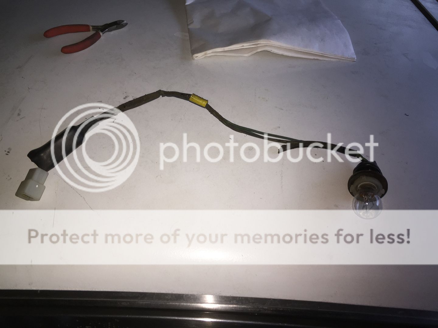

Snowman1771 Posted June 21, 2014 Share Posted June 21, 2014 (edited) Wiring of the turn signal switches, Now that is a special kind of Hell. Who thought it was a good idea to run everything through the effing hazard switch including the brake lights!?!?! I just finished rewiring my entire tail light panel, tempted to just rewire damn near everything. For a grill you could do what I did and go Fairlady style, I made it for about 50 bucks and run no bumper. Good luck with the move. Edited June 21, 2014 by Snowman1771 Quote Link to comment Share on other sites More sharing options...

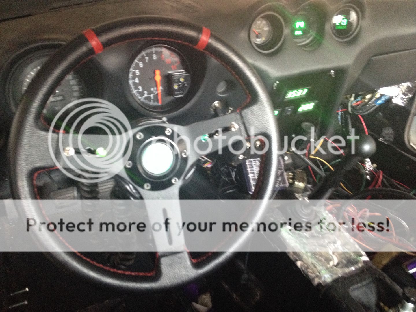

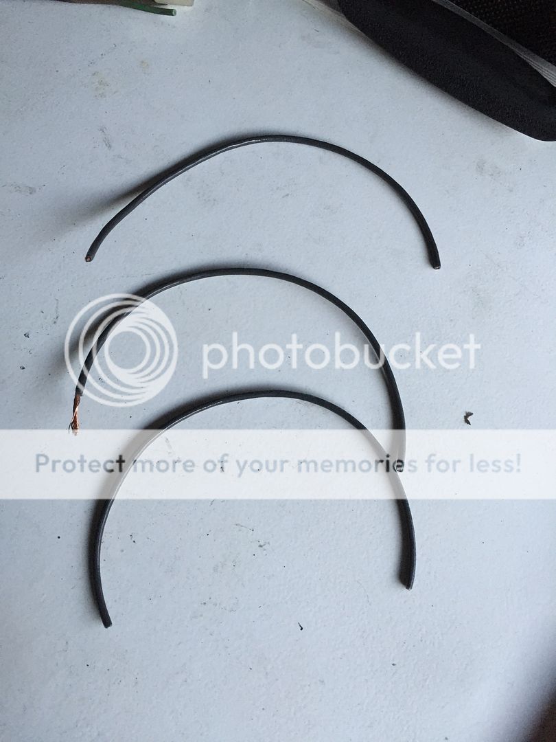

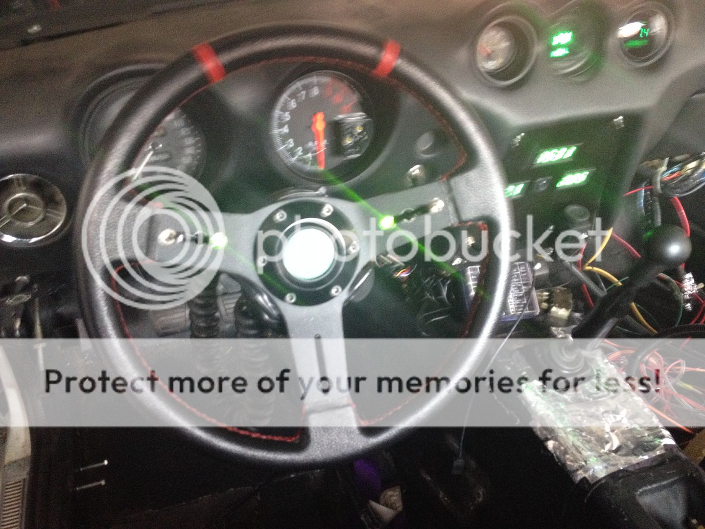

seattlejester Posted July 21, 2014 Author Share Posted July 21, 2014 (edited) Definitely considering a removable hub down the road, not really a necessity but if I add door bars again it will really be required to get in and out of the car. Plus in all honesty it is a small fantasy of mine. Managed to rewire up the steering wheel, used a much thicker heavier duty cable with 18gauge wires and used the the old cable and twisted it into one to run just the horn. Sorry for the bad pictures, but I think the idea is pretty apparent, please don't mind the wiring mess, I had to pull all my wires out to get to my megasquirt and wire in the new fuse box, it cleans up really nice when it is put away. Ignition on Left turn blinking The wiring was kind of a whole fun ordeal. Given how the stock switch is wired (turn signals are actually part of the braking circuit) had to incorporate some diodes to regulate the flow. At some point I wanted to add a quick disconnect cable and spent an hour or so soldering all that together when I realized I could just get a hook and hang it as the coiled cable would stretch a good 6-7 feet. All in all I think it turned out great, I just want to change out the old flashing units and I believe I will be golden as right now they click very slowly. The new sensor came in, trying to figure out the best way to mount it. Will have to find some space at a friend's to do most of the work and tack in the piece in my storage locker and finish elsewhere. Definitely finding a pool of oil under the car, I replaced the valve cover gasket and grommets which seems to have taken care of the dangerous oil onto exhaust problem, my thought is that my oil relocation kit is leaking. The lines are never covered in oil, but the relocation bracket always seems to have a bit of oil on top of it and that is sitting on the chassis rail. I've read that the casting is not that great so will have to take a look at that when I get the car to the exhaust shop. To finish it off, picture of the engine bay I have the cable wrap for the wires, just have to install once everything is finalized, and would like to try and get my hands on a 7mge valve cover so I don't have the silly studs sticking out. Almost there . Edited July 21, 2014 by seattlejester Quote Link to comment Share on other sites More sharing options...

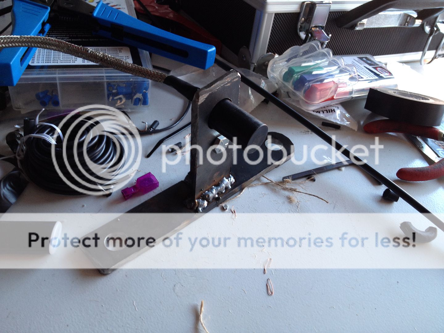

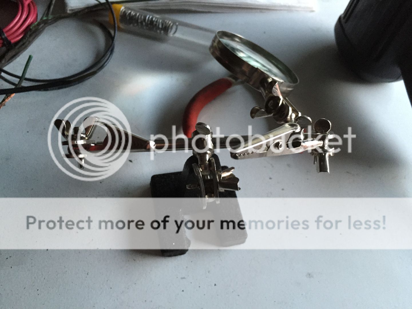

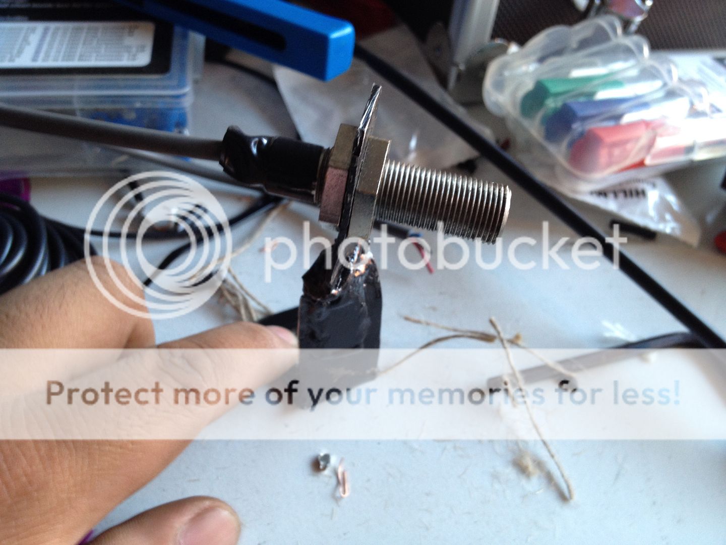

seattlejester Posted July 27, 2014 Author Share Posted July 27, 2014 So made some progress today. The newer version of the hall effect sensor came in. The first iteration I made was just a temporary solution. It really lost a lot of integrity when the wheel kinked and hit it and bent the thin metal. At the time, time was a concern so I just added some reinforcements and moved on. This time I really wanted to make a decent mount. I went over to a friends place who let me use his space to make up some pieces I needed. Mocked up the piece, tacked it in place, then made sure the wheel had enough clearance and put a brace and a weld on it. Please excuse the welds, I was working in a small storage locker without a real power supply, I was stealing power from a light socket and it was all just fiddly. Basically speed to high, amperage too low, and at first the gas wasn't on. If there ever is a Mark III it will truly be a piece of work I promise . I had not expected to get so far so I did not bring my laptop, but I wanted to see if the car would catch and the car ran. It was missing a bit which was slightly perturbing, but now that I think about it I did move the sensor quite a bit. The ECU will have to be retold how many teeth btdc the actual sensor is at. Once that is determined hopefully I can break the 4k limit I have been experiencing, and put it to the local exhaust shop for a once over and some exhaust work. Quote Link to comment Share on other sites More sharing options...
seattlejester Posted August 25, 2014 Author Share Posted August 25, 2014 (edited) So finally got the car revving past 4k, I threw in the towel and called a local tuner. We went through all of my settings, played around with my pots, and tried some noise elimination algorithms to no avail. Turned out it was just the sensor being too far away from the wheel. A little twist here and a slot there and bam, revs right up to 7k. Unfortunately, the engine is slightly apart again. A pet peeve of mine is a leaking engine, I can't explain how much that bothers me, I don't know why but it really does. The oil level was not dropping noticeably, but after every start there would be a small puddle afterwards. I finally had some time to track it down and found it to be the turbo drain pipe. There really does need to be a special place reserved in hell for the engineer who decided to run a stiff pipe at a 90* angle to studs on the block, and also studs to the turbo. After a couple hours, I decided that the best course of action would be complete removal of the exhaust side as the turbo refused to separate from the manifold. Hopefully I don't strip out any more of the exhaust studs as this motor is prone to do. I replaced the questionable ones with helicoil's but memory says that a few were not replaced as they seemed ok...so hopefully no problems. New gasket set ordered to replace the leaking gasket, will definitely RTV it as well as machine the mating surface to ensure a good fit. A friend I welded a muffler for offered to let me use his driveway, so I ordered up some pipes and mandrel bends and v-bands. Pretty excited to get my welder out again. Only problem is that my transmission being much larger, and the associated mount seems to run a bit too close to the tunnel, and I do not plan on having the exhaust hang low at all, so I may either need to bash the tunnel in a little bit, or perhaps play around with oval piping to pass through the thinner portion. The only other few things to address include the clicking noise coming from either the transmission or the rear of the car, definitely RPM based, but only during loaded driving. Something is clicking against the drive shaft/wheel/half shaft. And a slight ring of moisture around my hydraulic brake is something I have been keeping my eye on, new bolt and washers ordered, but have not noticed a dip in fluid and the brakes feel solid, so not sure if I want to go through all the trouble of bleeding the setup, will have to see. Edited August 25, 2014 by seattlejester Quote Link to comment Share on other sites More sharing options...

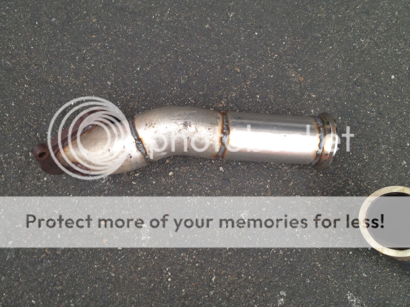

seattlejester Posted October 10, 2014 Author Share Posted October 10, 2014 (edited) Welding is really fun, especially if you can get pretty consistently good at it. We started with a 4 foot pipe and 1 u-bend and a few hours later we had an exhaust, friend's dad popped out to the garage and quite literally said "holy shit" which was about a nice a complement as I could hope to expect. I believe new knocking sound is the exhaust hitting the chassis again. The exhaust shop cut up my exhaust to fit the v-band and their mount and in the process I think they moved one of the bends a bit too close to the chassis. Will need a visit from the hammer fairy I think. Local speed shop is having a sale right now on sparco seats, and I am hard pressed to prevent myself from buying a couple R100s to go along with me new to my schroth harnesses. Either that or I can start saving for coil overs. Decisions decisions. Edited October 10, 2014 by seattlejester Quote Link to comment Share on other sites More sharing options...

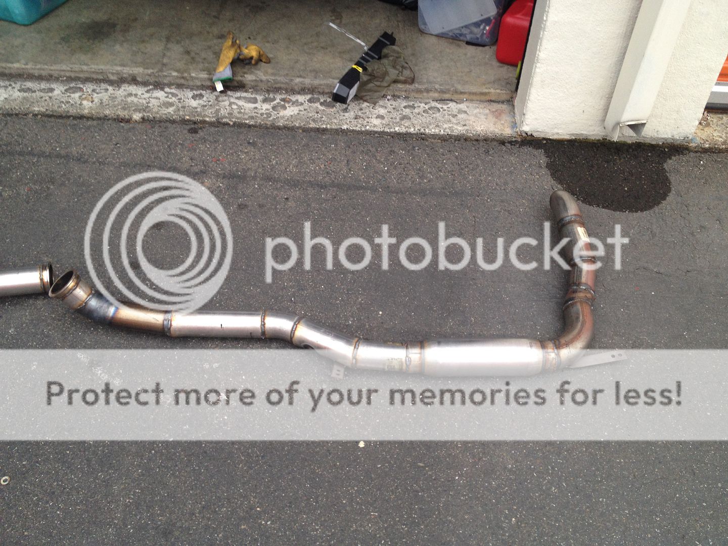

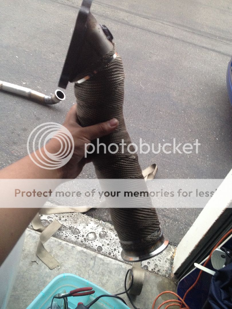

seattlejester Posted October 13, 2014 Author Share Posted October 13, 2014 (edited) Wanted to take the down pipe off to wrap so I figured I would put up some exhaust related things. Downpipe Wrapped Exhaust Exit location Believe it or not, the exhaust is actually mounted in the shot above. The DEI titanium wrap was real easy to use, followed their video on youtube and had it wrapped in a couple minutes very securely. The exhaust shop did a great job with tucking the exhaust tip in the back. It does rattle a bit as it pretty much touches the chassis where the tip is, but it is completely stealthy, the entire exhaust sits above the frame rail to boot even with the massive R154 transmission sharing the same space. Even idling, there's no hint of exhaust fumes. Exhaust vid Completely different from previous engine and exhaust Kind of makes me miss the old engine. Edited October 13, 2014 by seattlejester Quote Link to comment Share on other sites More sharing options...

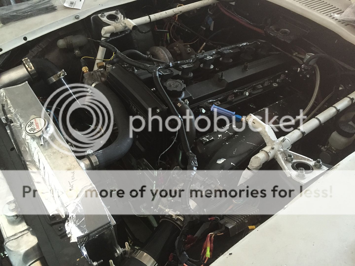

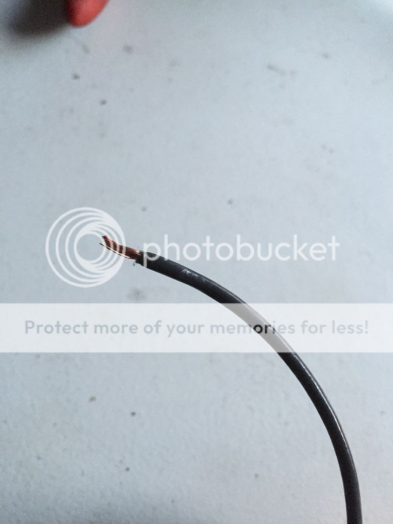

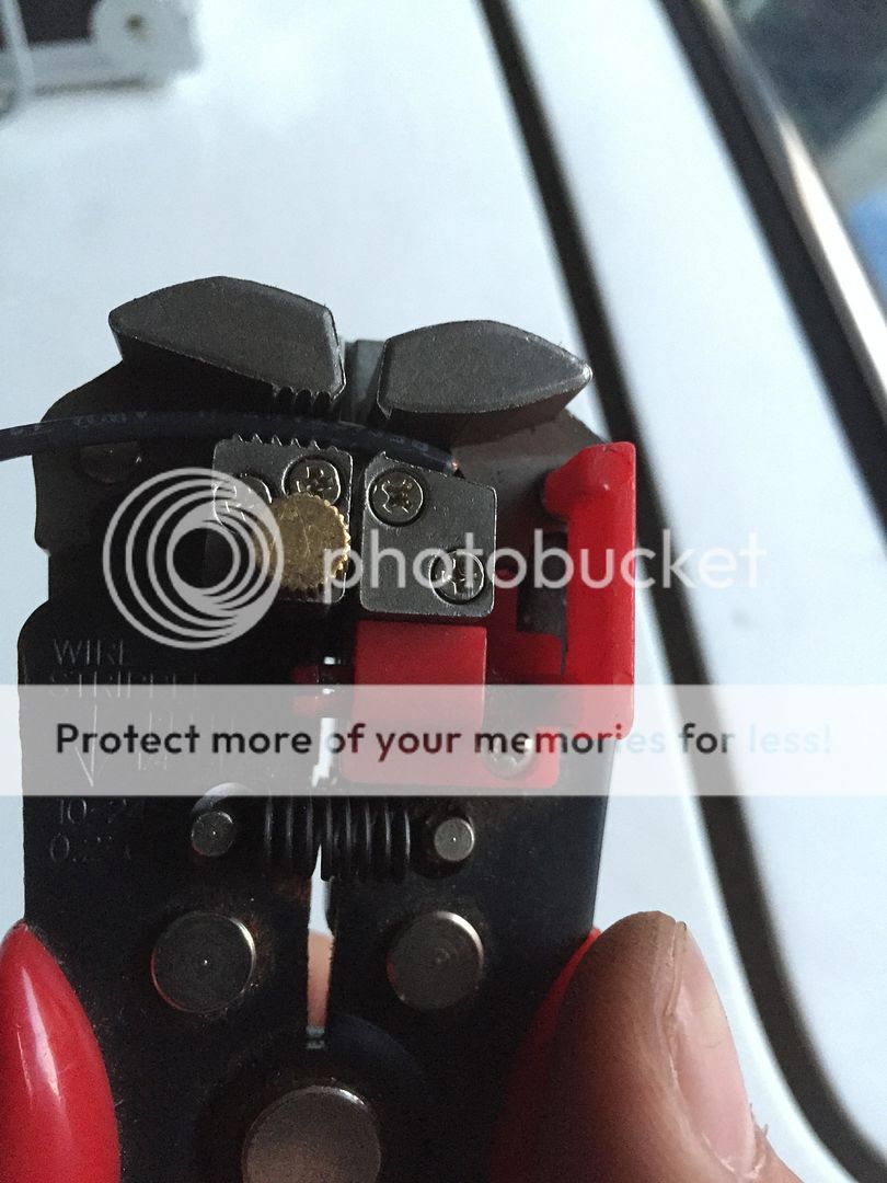

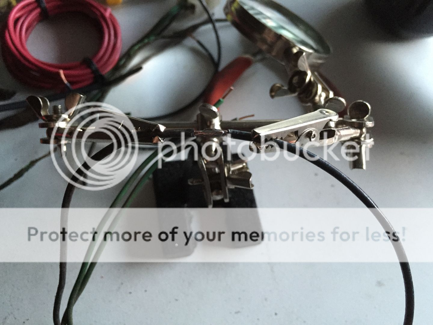

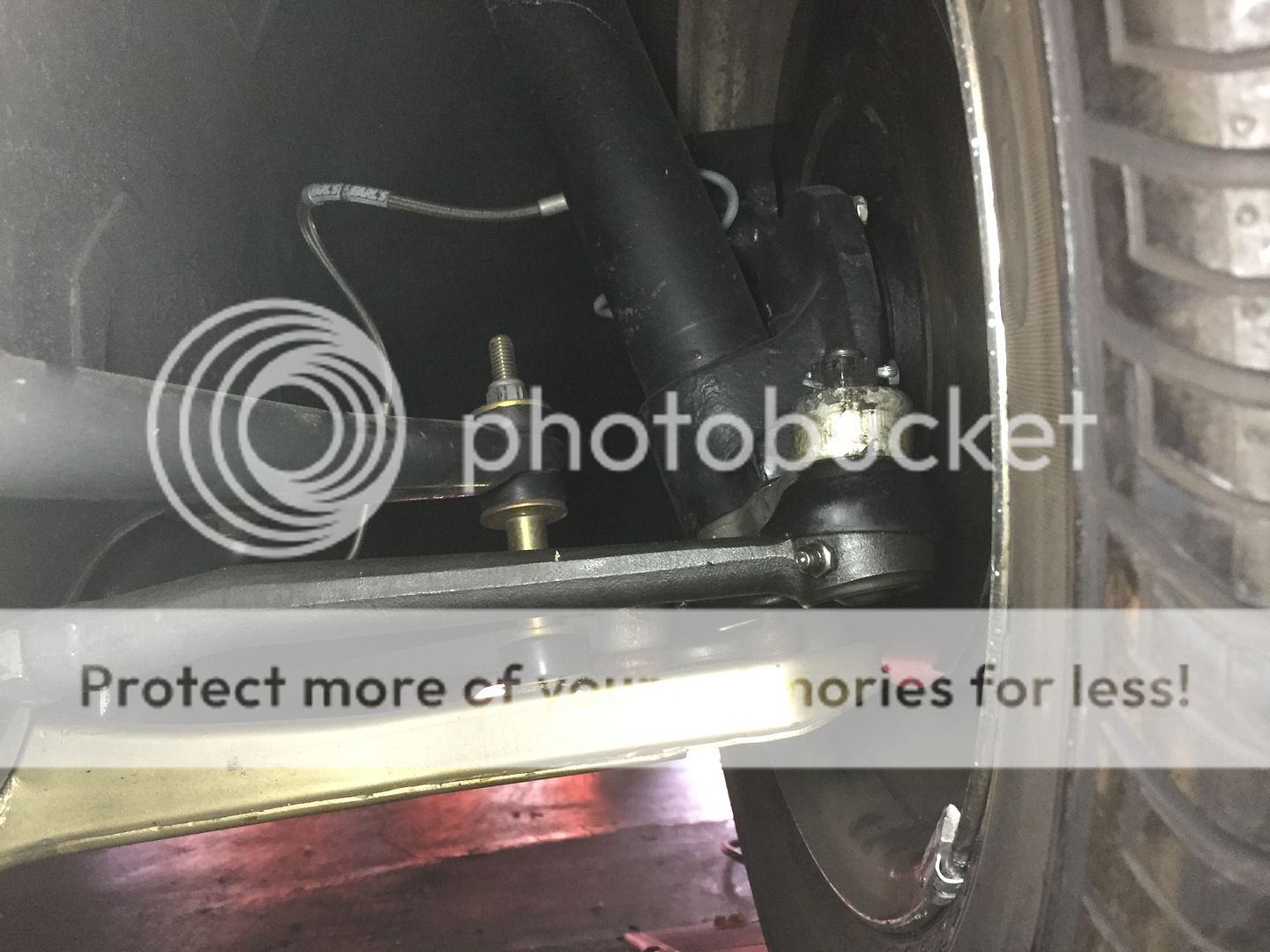

seattlejester Posted December 29, 2014 Author Share Posted December 29, 2014 More wiring done, I think if I revisit it two more times (once for length and routing, once more for fancy molex or weatherproof connectors) I'll be happy. For now I think it's a much bigger improvement. To this Noticed the tie rod boot had ripped, so I ordered a new set of rods, but thought I might as well try out one of the poly boots. Not sure how I like it, but we'll see how it holds up. Now onto the public opinion poll. I'm willing to take thoughts on how I should mount my tablet. Options are... HUD, would need to apply a bit of black tint to increase the daytime usage. Speedo/Tach location Would either just find a way to mount it or for a more permament install would have to cut out the bezel and make a box High mount, next to rear view mirror Center panel, would have to remove my temp, voltage, and time readouts. I'm leaning towards just boxing up the tablet and cutting a square out of the dash where the tach and speedo sit, both the gauges don't work anyway it seems to be the most logical spot. HUD would be nice, but I fear it would be fairly faint during the day, and any person walking by could decide they want a tablet. The other options I haven't really tried. Would love to hear some thoughts on the matter. Quote Link to comment Share on other sites More sharing options...
