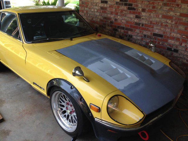

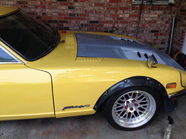

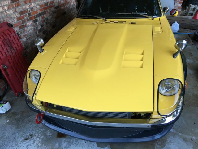

ZT-R Posted August 14, 2015 Author Share Posted August 14, 2015 Been busy, haven't had much time for it. Hopefully have the hood done tomorrow. Lots of finesse, mainly on the underneath. Quote Link to comment Share on other sites More sharing options...
RB26powered74zcar Posted October 19, 2015 Share Posted October 19, 2015 Did you get around to finishing the hood yet? Quote Link to comment Share on other sites More sharing options...
ZT-R Posted October 29, 2015 Author Share Posted October 29, 2015 Not 100% done with it but close enough for now. I have little patience for aligning body panels. With the hood being so light and no spring the front will ride up so it looks like it doesn't align more but thats cause i can't run a hood spring with my intercooler and condenser in there. Quote Link to comment Share on other sites More sharing options...
98blackbell Posted October 30, 2015 Share Posted October 30, 2015 Looks good Quote Link to comment Share on other sites More sharing options...

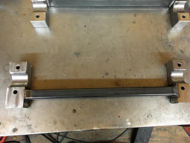

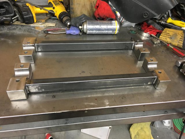

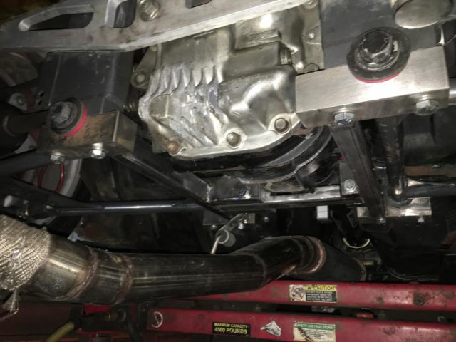

ZT-R Posted December 21, 2015 Author Share Posted December 21, 2015 Some progress. Lots of milling to make the end caps but they turned out good i think. Heavy but rugged for sure. Quote Link to comment Share on other sites More sharing options...
98blackbell Posted December 25, 2015 Share Posted December 25, 2015 Hmmmm, lets see it bolted up. Looks stong enough. I know our little 250hp moves the motor and tranny around alot. Cant imagine 600+HP! Quote Link to comment Share on other sites More sharing options...

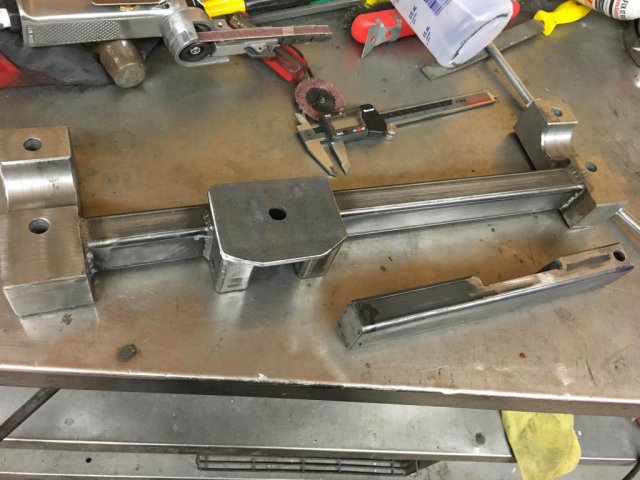

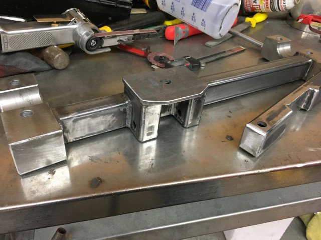

ZT-R Posted January 3, 2016 Author Share Posted January 3, 2016 Haven't had much time to work on it, but slowly making some progress. Turning out well i think. I decided not to make it all one piece, it will be 3 piece with a removable cross brace and i might put an adjustable helms on the rear part just cause i have some helms joints laying around. Quote Link to comment Share on other sites More sharing options...

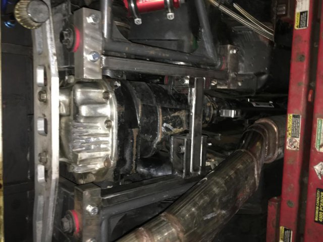

ZT-R Posted January 8, 2016 Author Share Posted January 8, 2016 Well, the mount is hella stout... still found some issues... That soon will be corrected... Quote Link to comment Share on other sites More sharing options...

ZT-R Posted January 10, 2016 Author Share Posted January 10, 2016 This one is very car specific, like .0020 thousands tolerances, thats why its been taking me so long, ha. Quote Link to comment Share on other sites More sharing options...

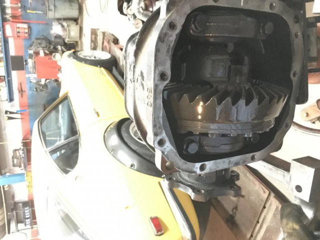

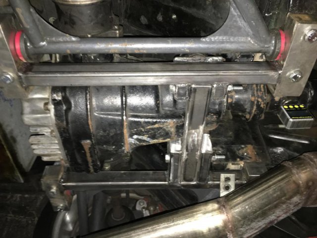

gmac708 Posted January 16, 2016 Share Posted January 16, 2016 Nice job Lee. I was thinking a brace across the back to hold the two aft lower control arms together. The Arizona Z setup has a billet bracket that tie the two together. With all the torque your producing, those two must be trying to pulling themselves apart. A simple strap across the bottom, picking up the two bolts on either side would really box everything together. Your pinion mount is making my brain think of way to correct an alignment issue I have with my car. Good luck with the test drive! Gord Quote Link to comment Share on other sites More sharing options...

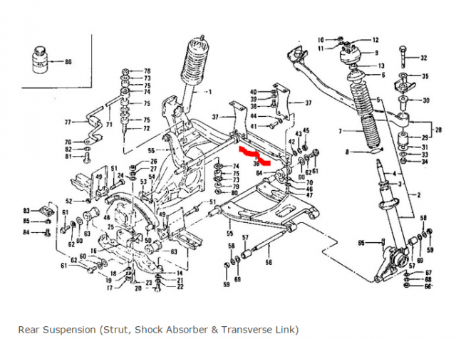

ZT-R Posted January 18, 2016 Author Share Posted January 18, 2016 I don't have it pictured but i drilled and tapped the rear and front so i can do exactly that with some helms joints and a bar. T3 does have what they call a "Dog bone bar" or something like that which does the same thing, but slightly lower than the mustache bar if you look close you can see it in this picture, its black. I have 1/2" helms joints and 1" round aluminum bar I'm gonna use to make the bars. Quote Link to comment Share on other sites More sharing options...

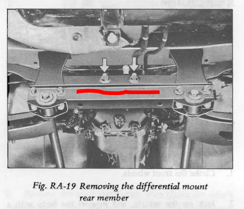

NewZed Posted February 7, 2016 Share Posted February 7, 2016 Seems like you did kind of leave an original factory part out. The hanging braces are working extra hard without it. You've left 'em hanging. Quote Link to comment Share on other sites More sharing options...
