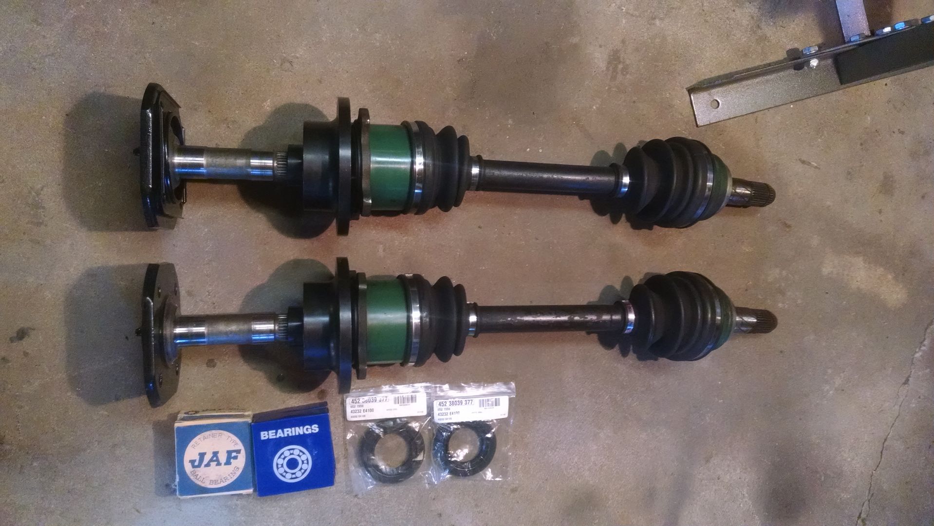

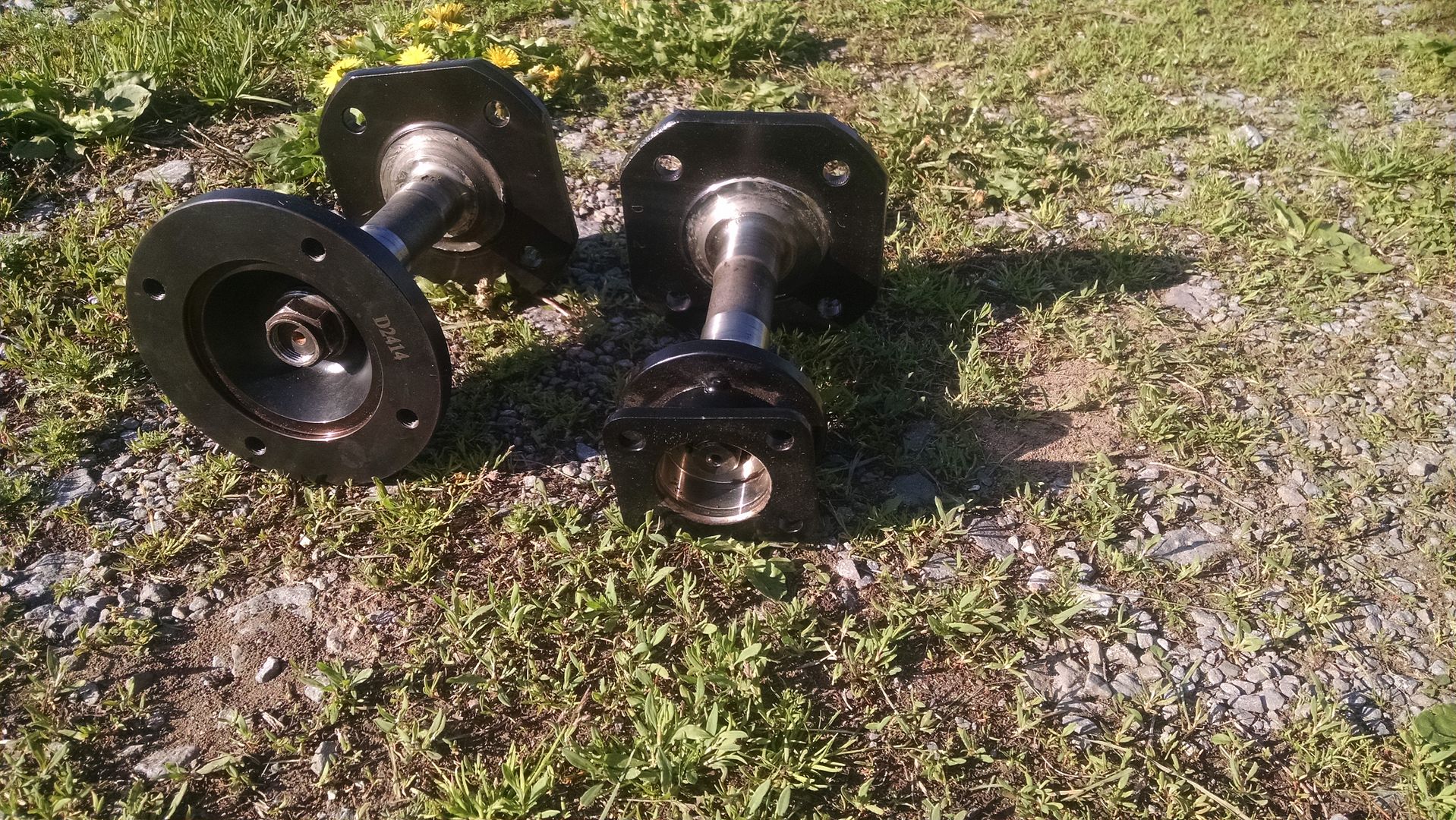

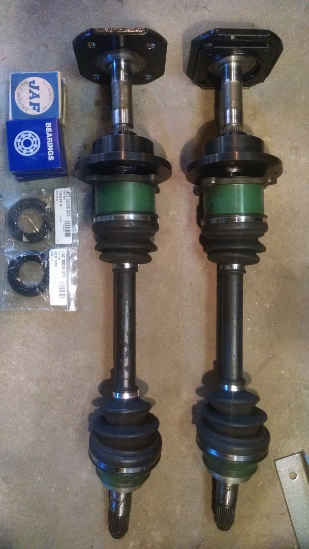

Z31 axles and Whitehead performance billet companion flanges to make everything cooperate. I got a killer deal. ($650 for the axles, adapters, and a spare set of 27 spline stub axles.)
Here's the link to the axle adapters if anyone is wondering - Probably not though, as these are fairly well known. Regardless.
Available: http://www.whiteheadperformance.com/products/whp-billet-cv-300zx-z31-turbo-axle-companion-flange-adapters-27-spline-datsun-280zx/
OEM companion flange (left) vs. Billet z31 adapter.

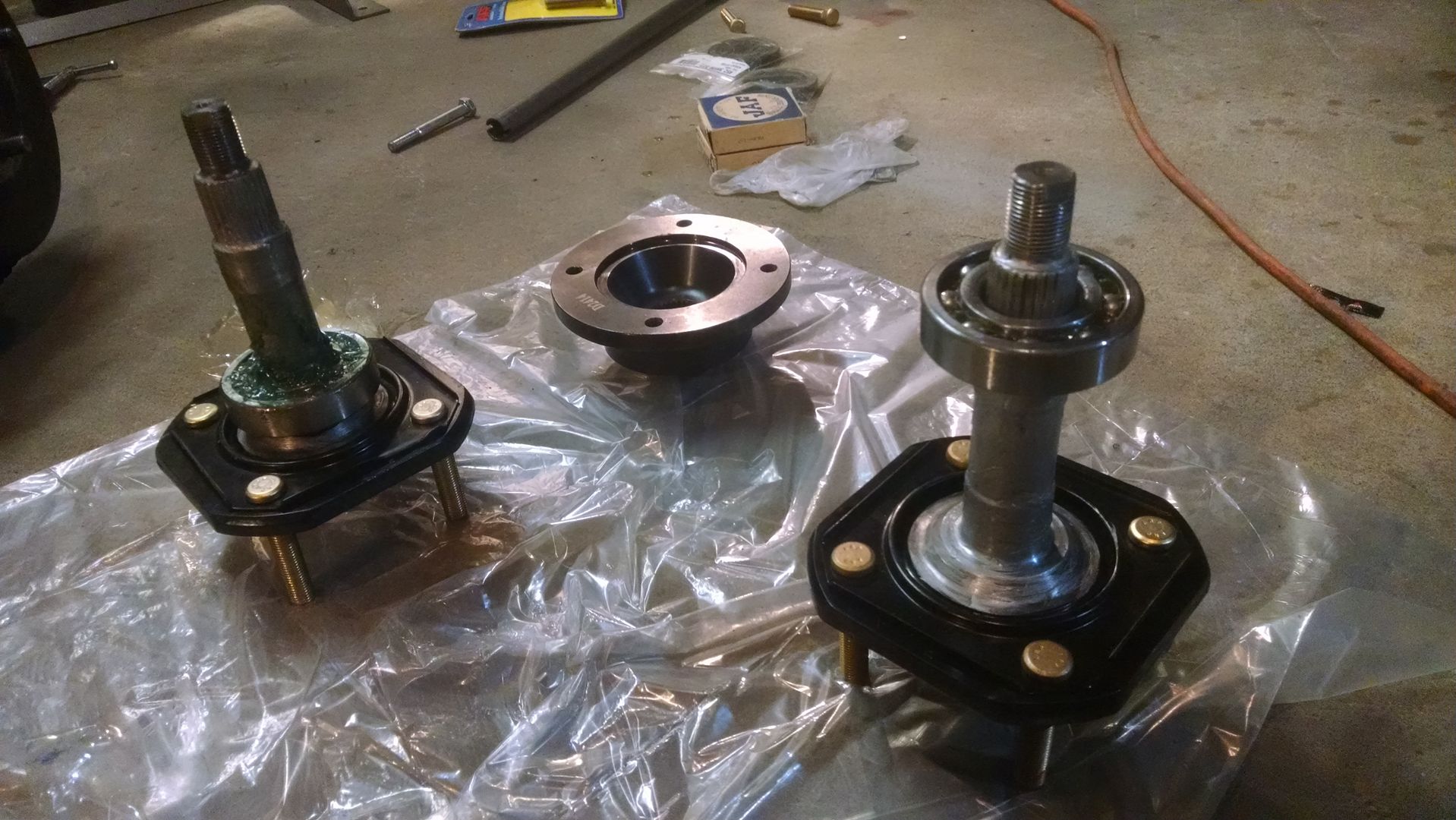

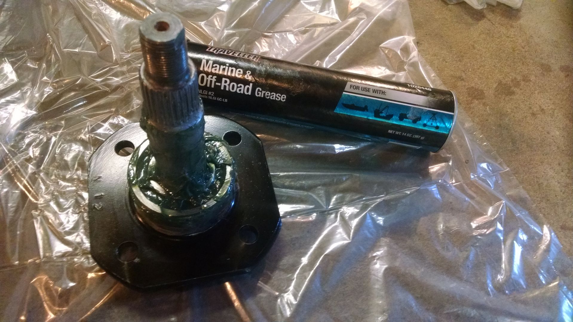

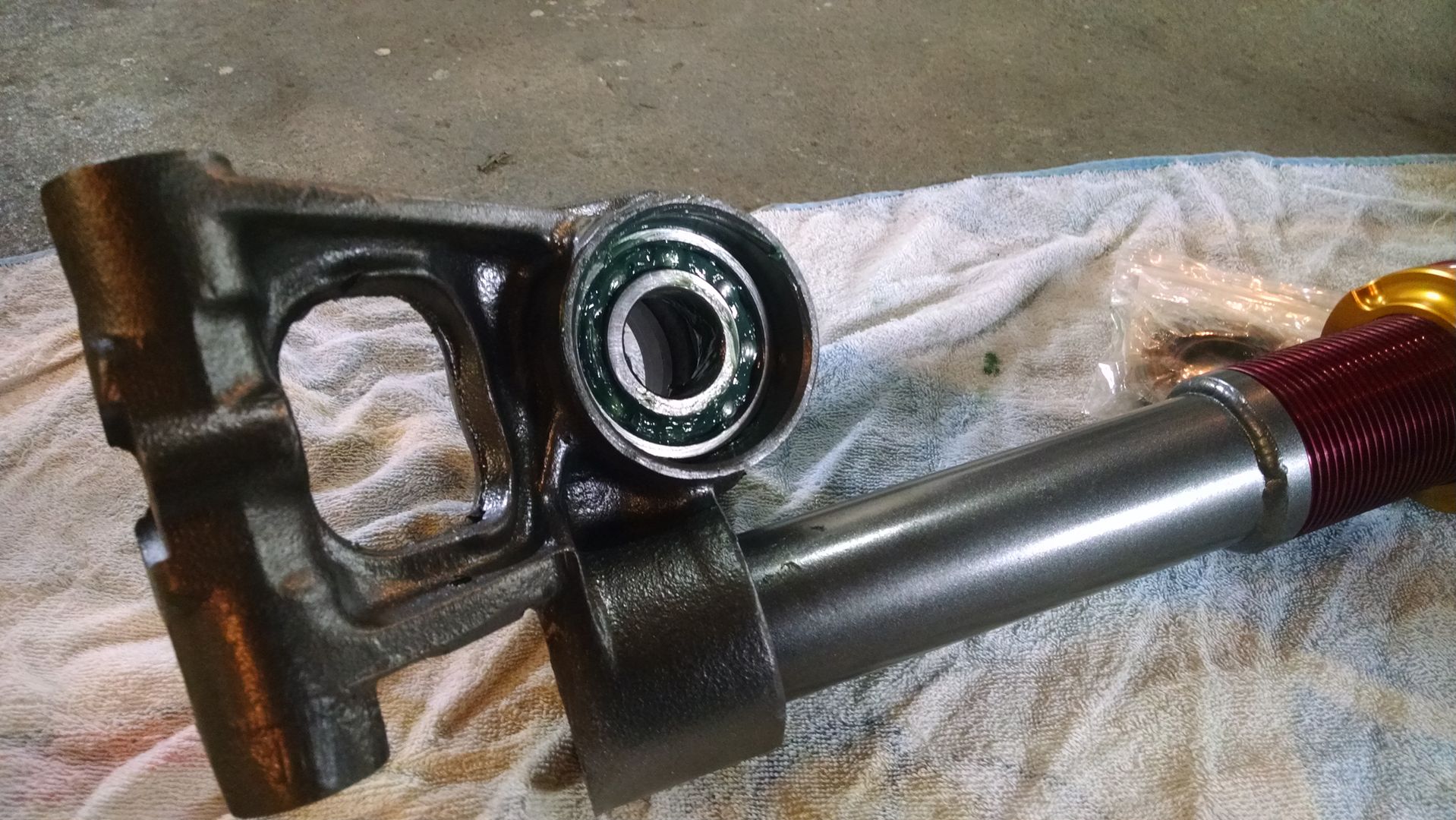

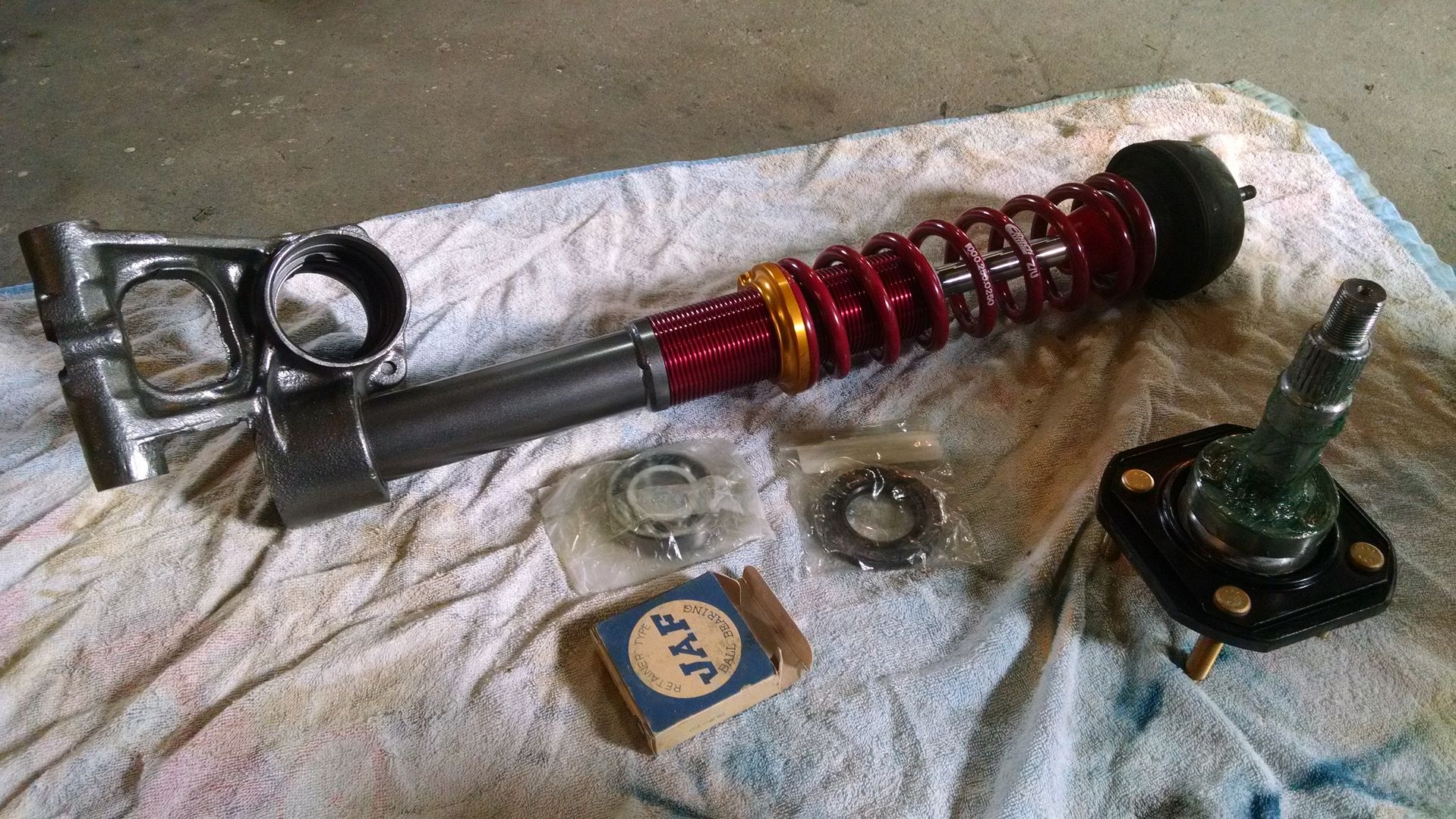

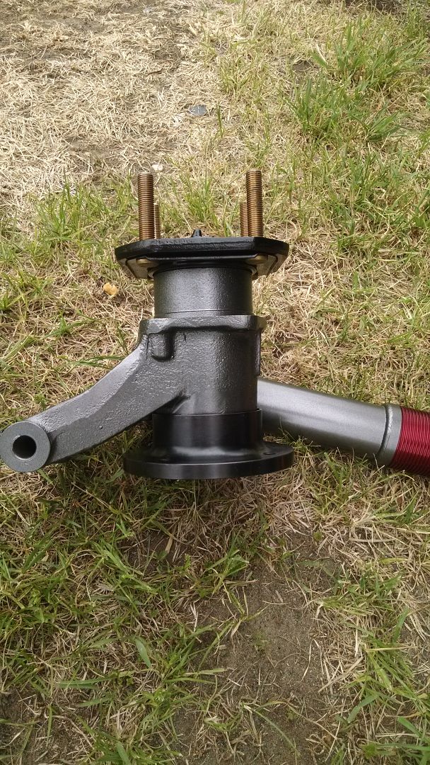

Time for the rear bearings!
 Marine grease...mmmmmm. For use with: Racecar!

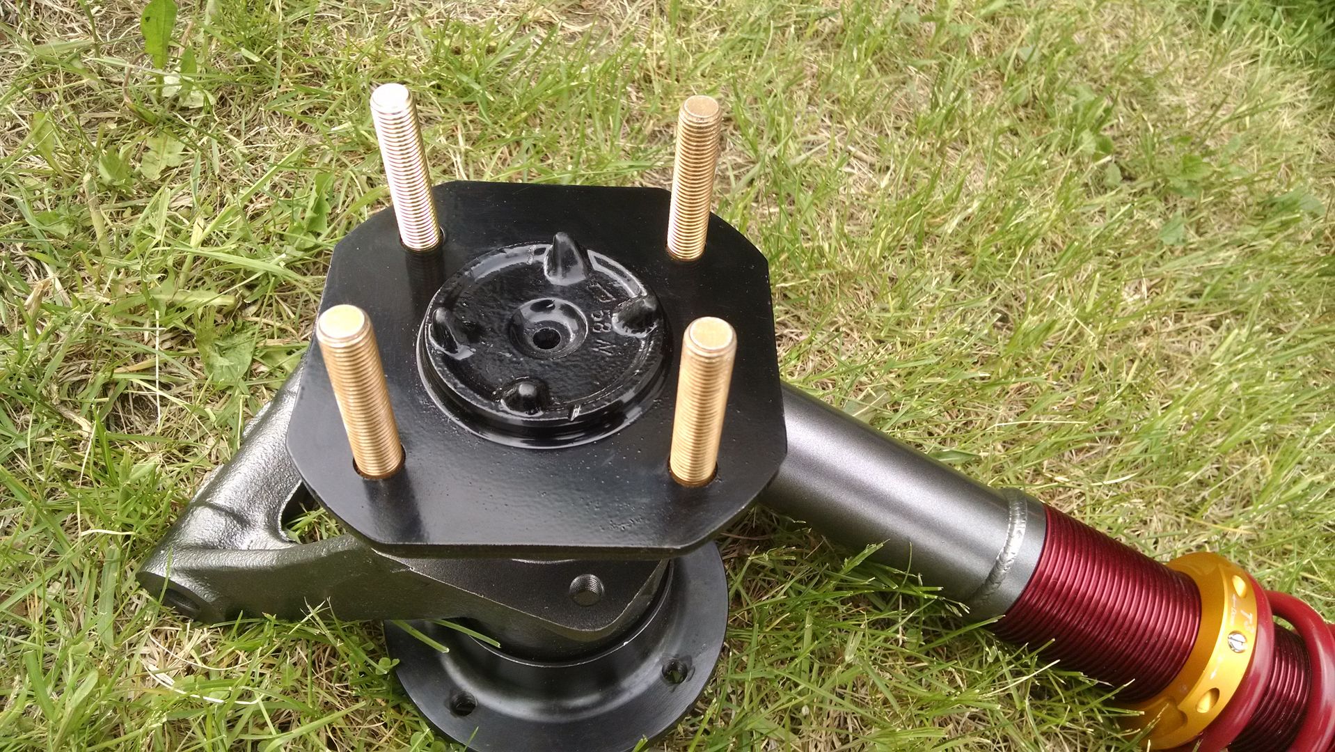

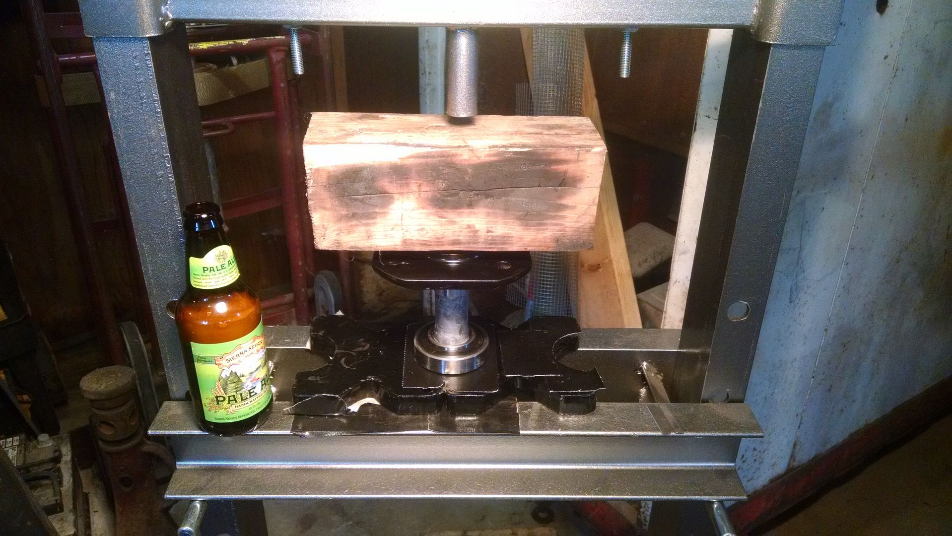

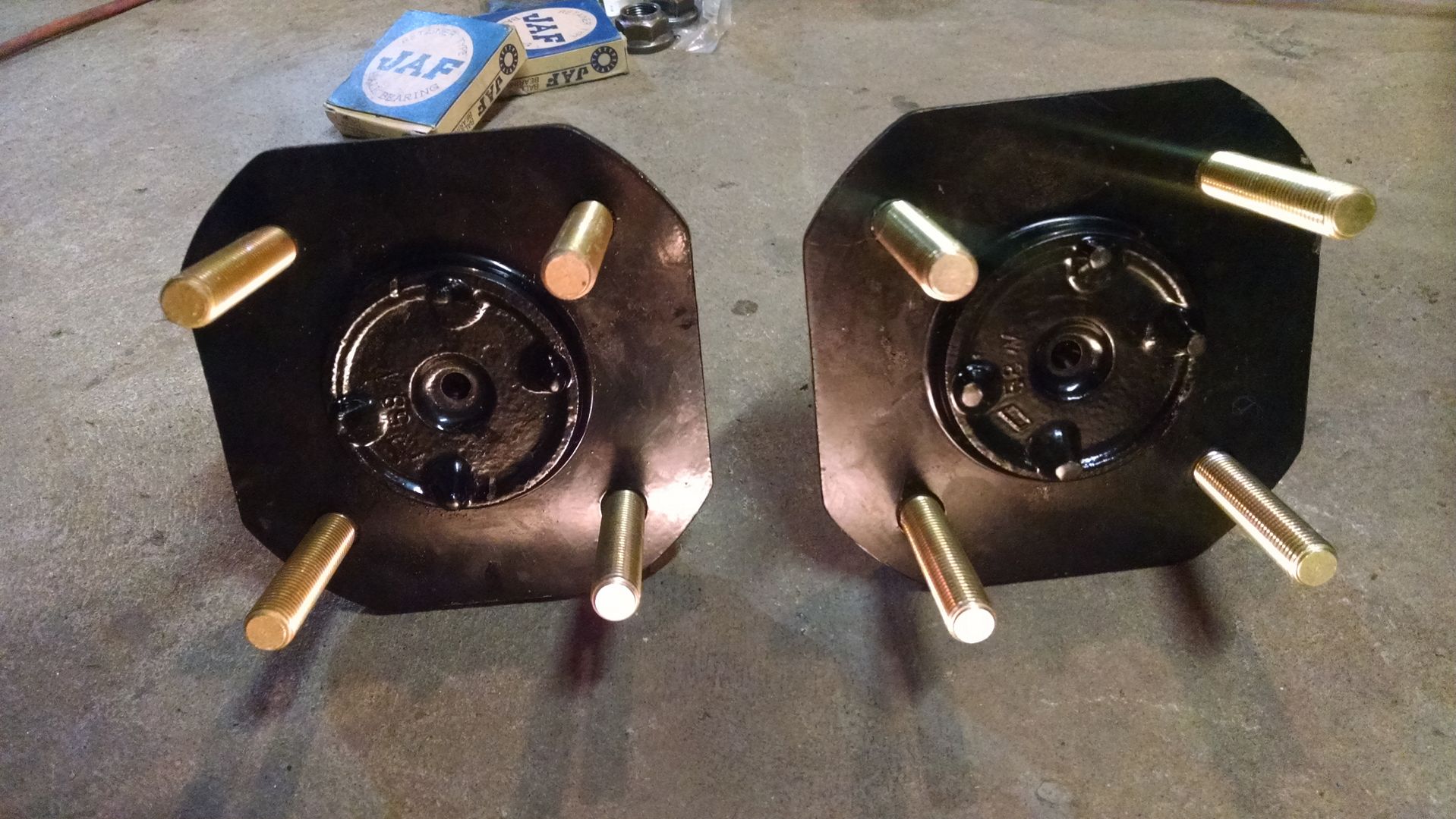

ARP Studs: pressed those in place.
Outer bearings installed and packed. Tomorrow I will install the inner bearings, seals and pop these babies in place.

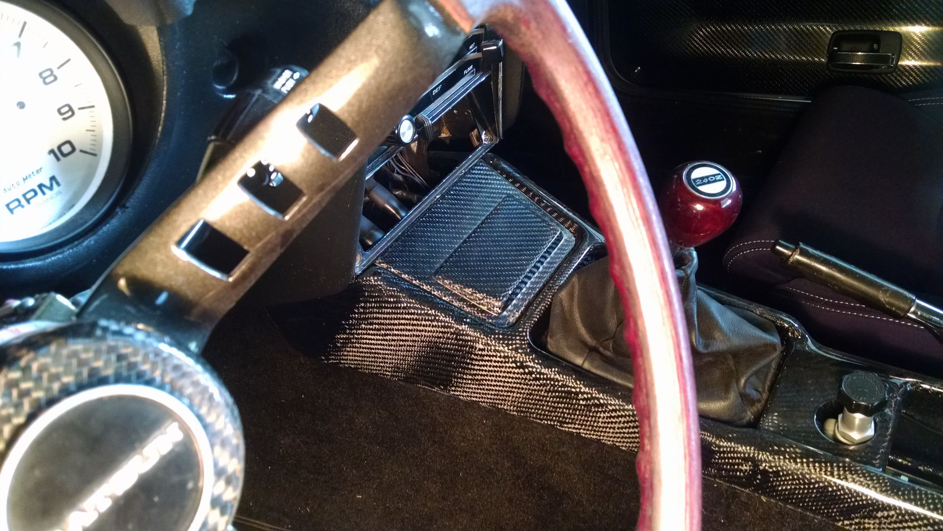

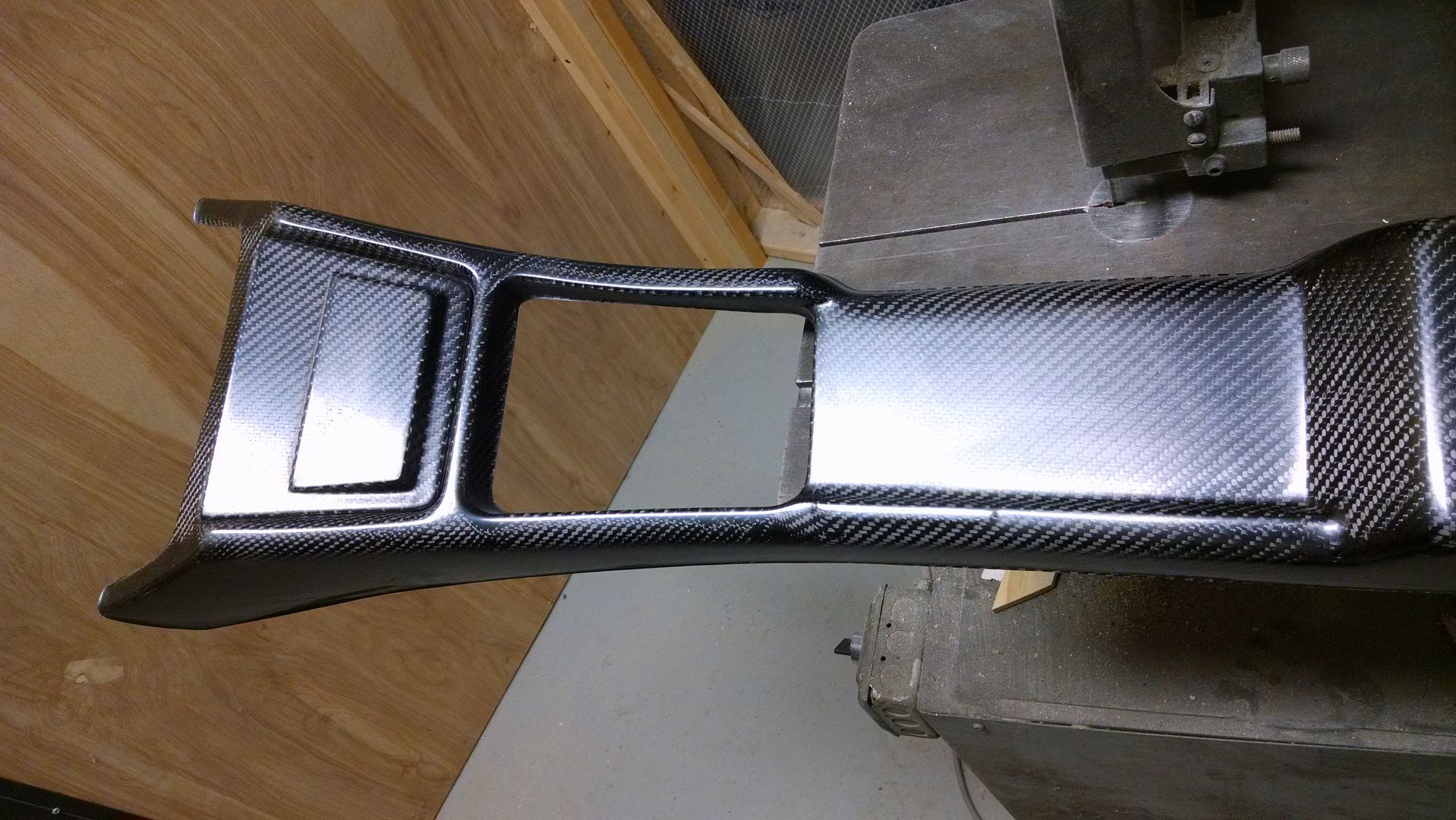

Also, bonus revised console plug. Ash tray delete. Lookin' purdy.

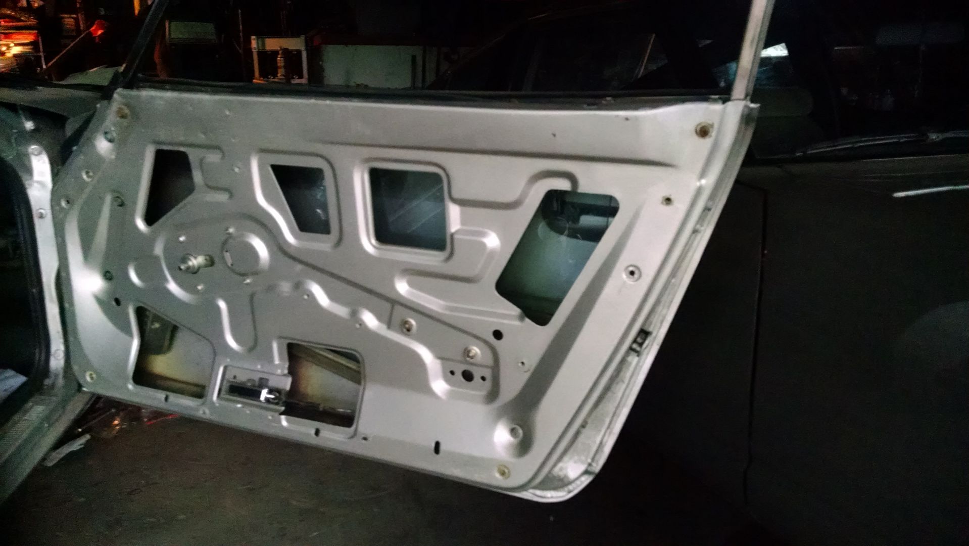

Thanks Keith! we're still finishing up the details on the one pieces. Basically exactly what you mentioned. The top window weatherstrip. Attaching the fuzzy strip is proving slightly more difficult than anticipated. The OEM strip is fairly straight, and unable to bend in the Y axis (up and down) to match the gentle curve of my adaptation. That's basically the last detail. I'm looking at all options, and am very open to suggestions - should anyone have any thoughts.
I'm also slightly worried about door panel "smush" on the door seals. My doors have always shut hard, due to aftermarket, very "plush" seals (and 40+ year old hinges). The one piece design, like the OEM does, in MY car smushes on the door seal. If I remove that section of the door seal, with any of the door panels (OEM included) the doors shut much easier.
I just don't want people who potentially purchase the one piece design, all of a sudden, not able to shut their doors without slamming the bajesus out the them.

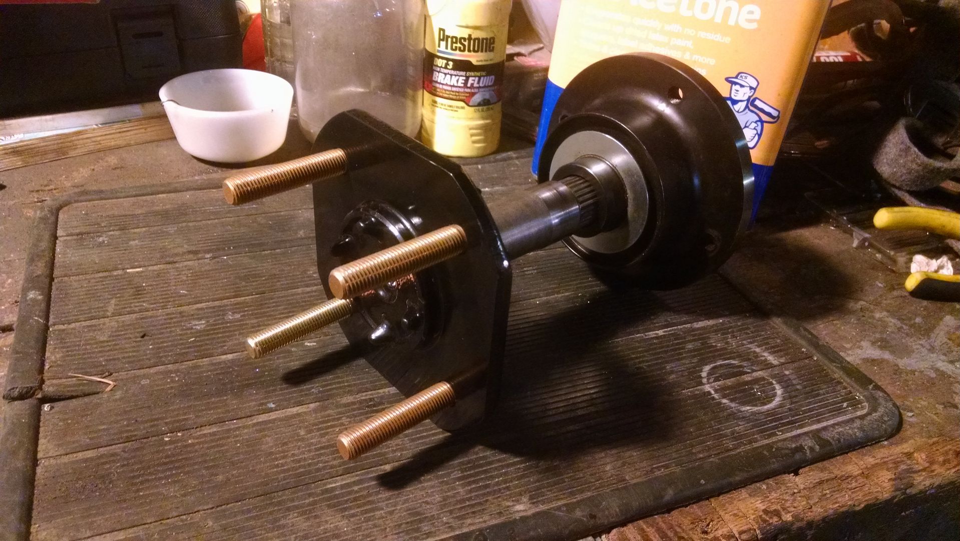

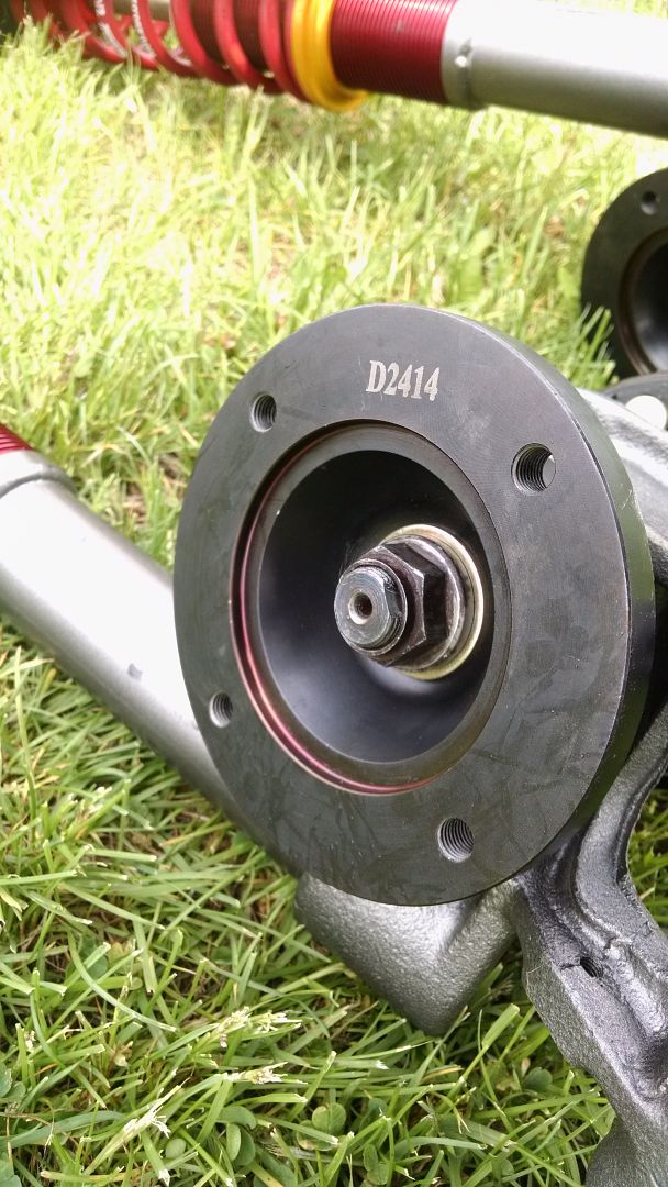

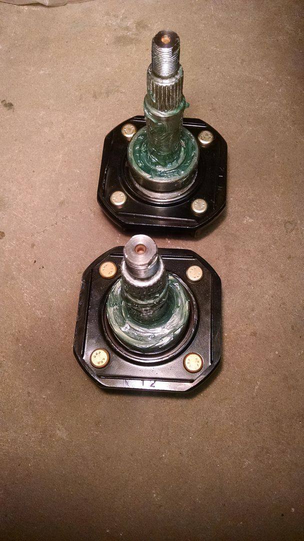

Finished up the rear wheel bearing install last night/this morning.
Installed the inner seal - The bearing spacer (never pictured) then the companion flange.
They spin like a dream. Cross that off the list - One step closer to wheels on the ground.

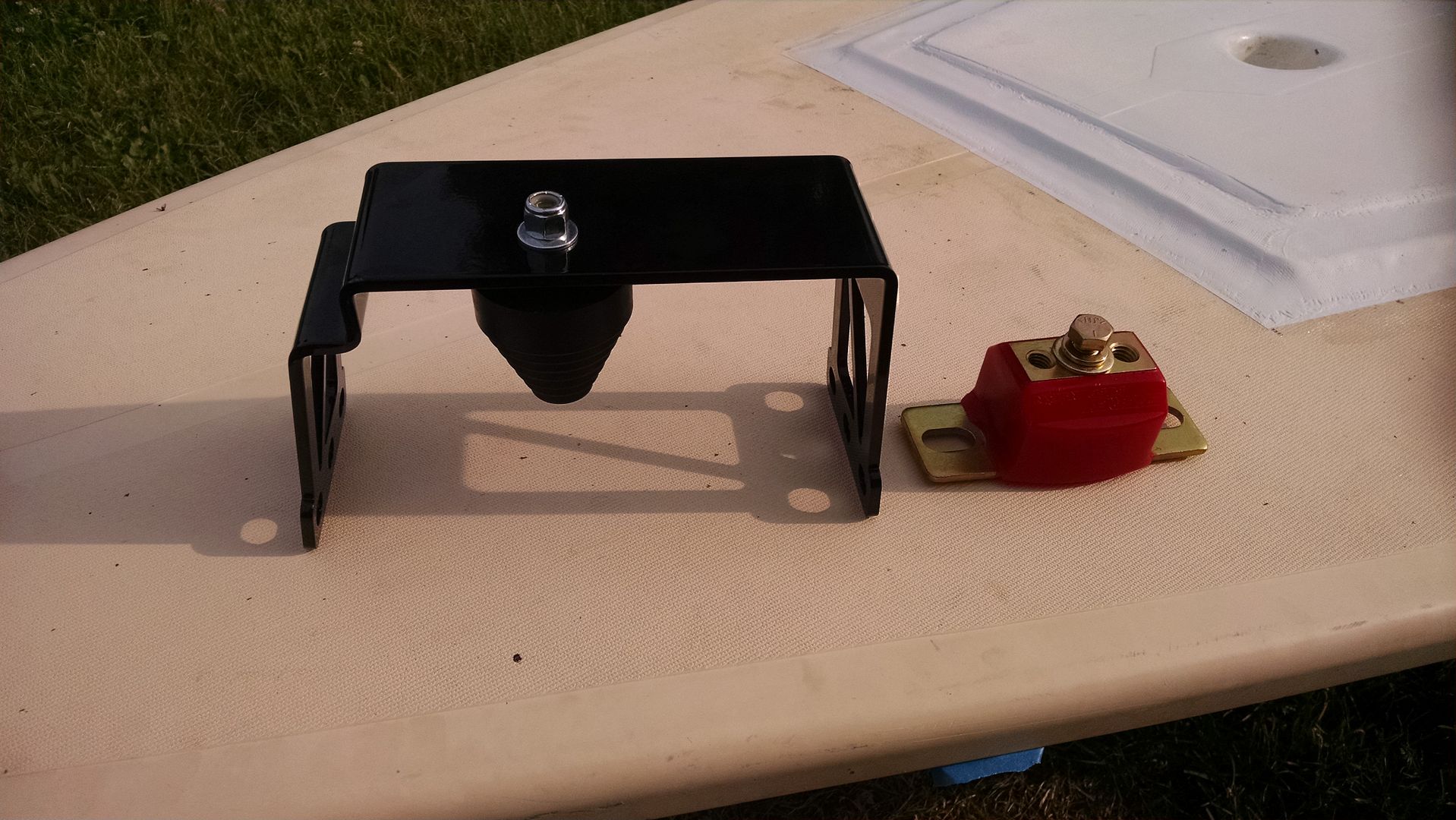

Differential mount stuff.

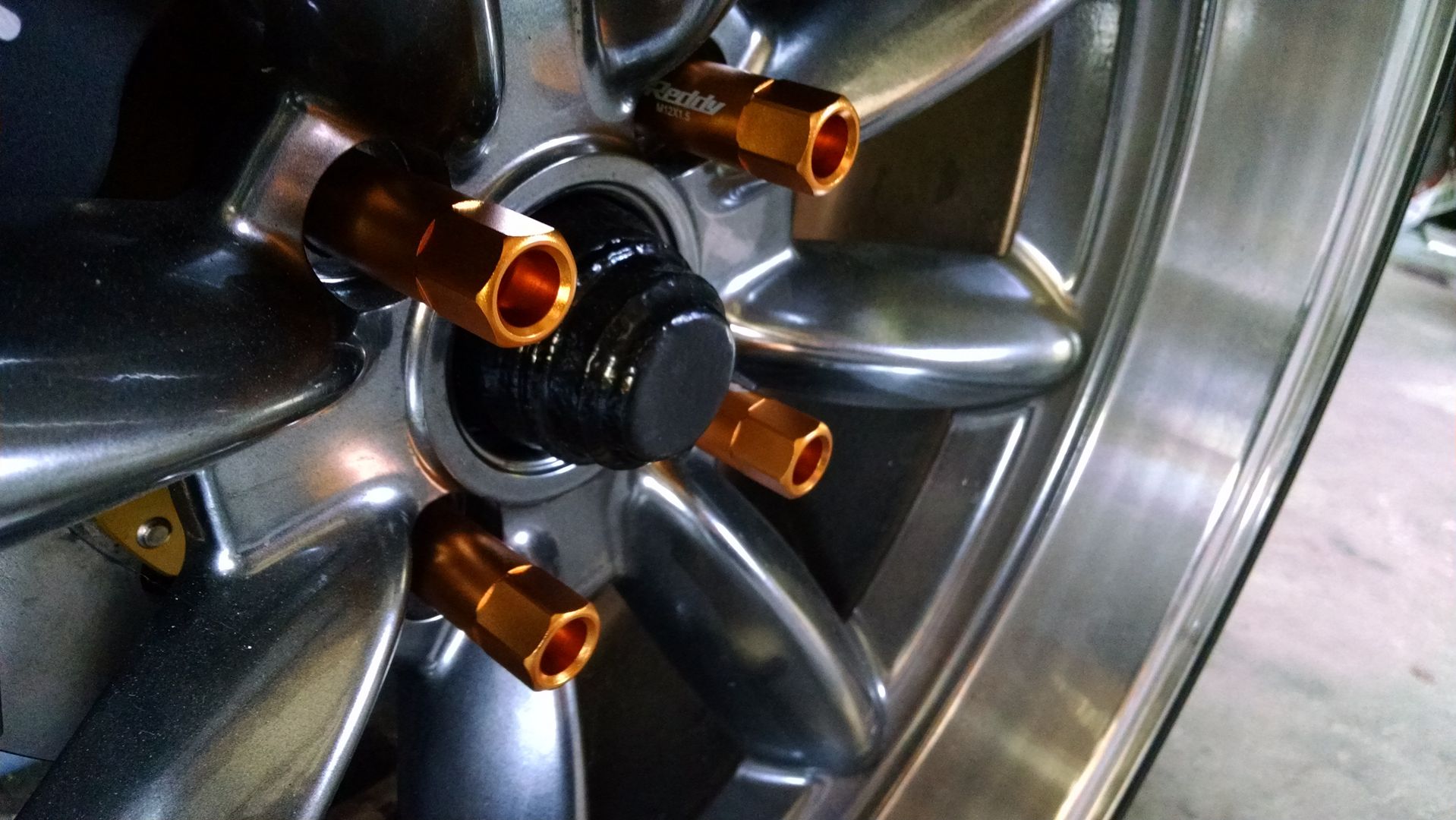

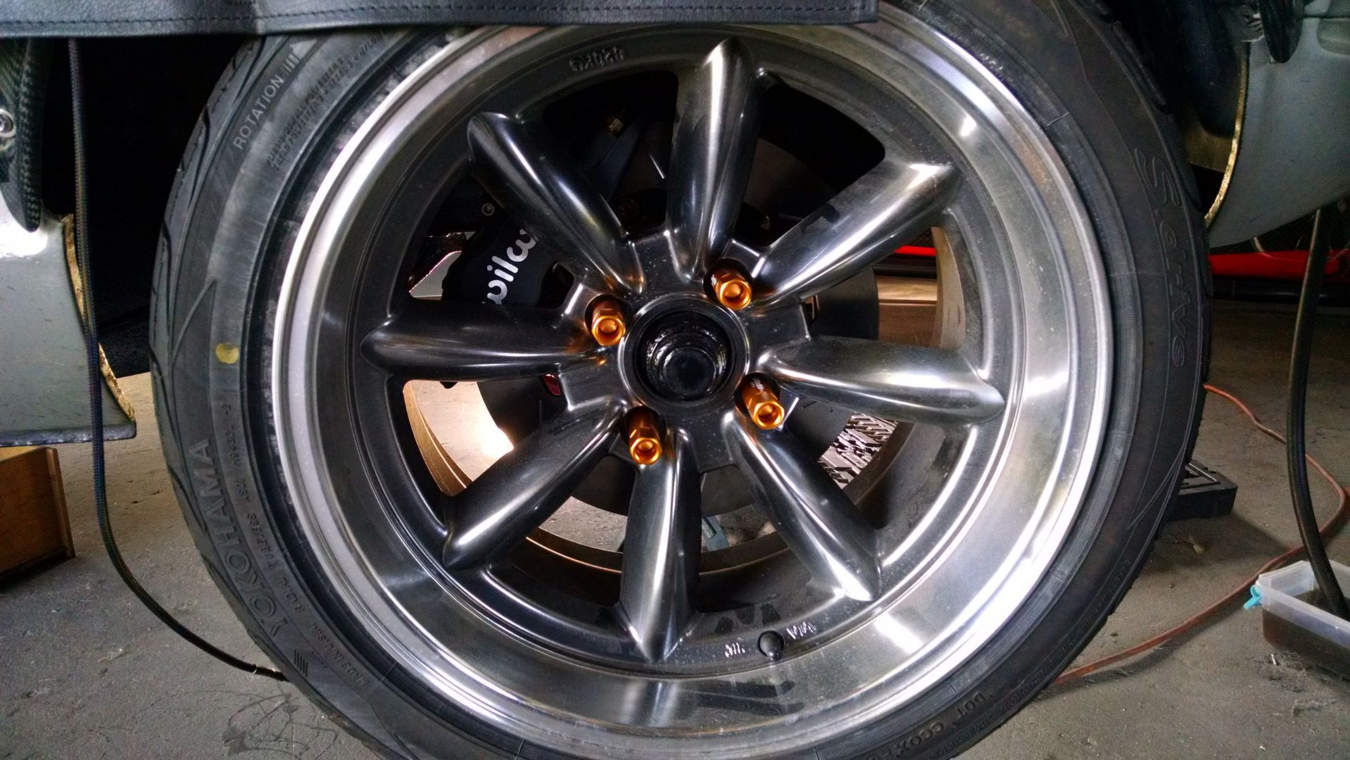

Lug nuts - gambled on the Gold. Not 100% sold on the color, I think I like it, though. Too soon to tell for sure, but either way they're staying for a while. For $113, yeah, they're staying. :laugh:

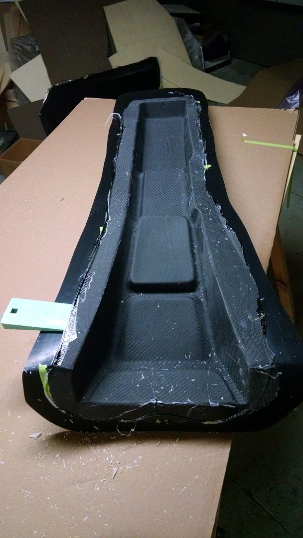

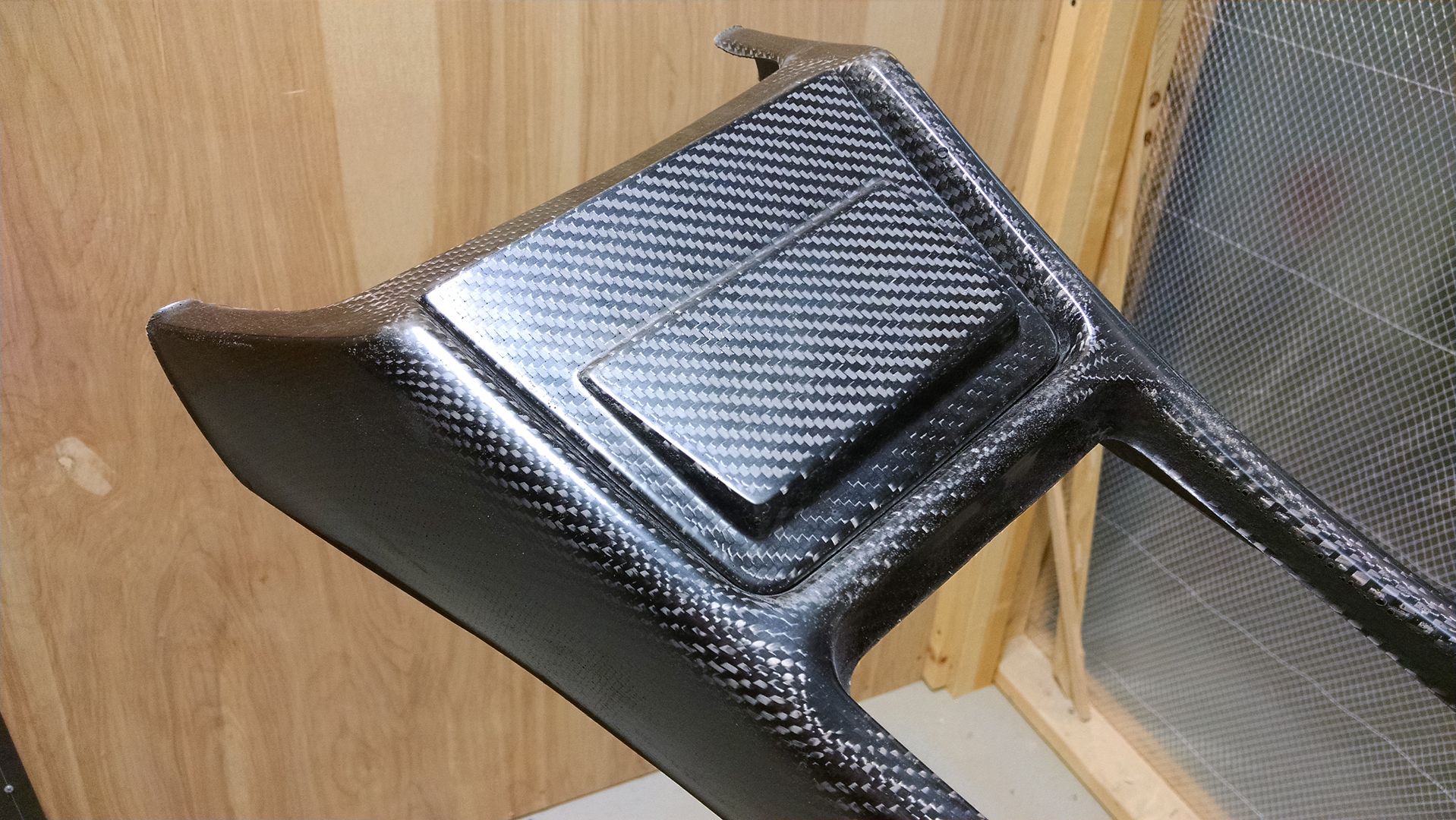

Finished up the Console v2.0 mold. No more ash tray.
And made a widget - fuse box cover.
plug
mold
part
Good, it'll work. That's good news, considering I sacrificed my cover to make the plug. Always a plus - replacement value

Also about the CV conversion. The Z31 axles are a touch to long and could grind away your ring and pinion. I ended up shortening mine with nothing more than an angle grinder, it's in the driveline area where I did a write up. I've got about 1k miles on them so far with zero problems. Just thought I'd pass this along!
Awesome work!!!
Thank you, and yup,  I am aware of the length issue.
I have adjustable Lower control arms on all four corners. I should be able to space the axles appropriately....At least from my research. The axles were basically free in my transaction.
I'm still way ahead (money wise) on my CV/ companion flange purchase. So even if I have to buy shorter CVs down the line (or modify mine), it wouldn't be a big deal.
Getting the companion flanges was my main concern at that moment.

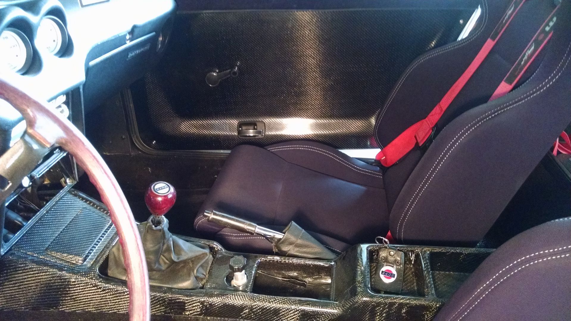

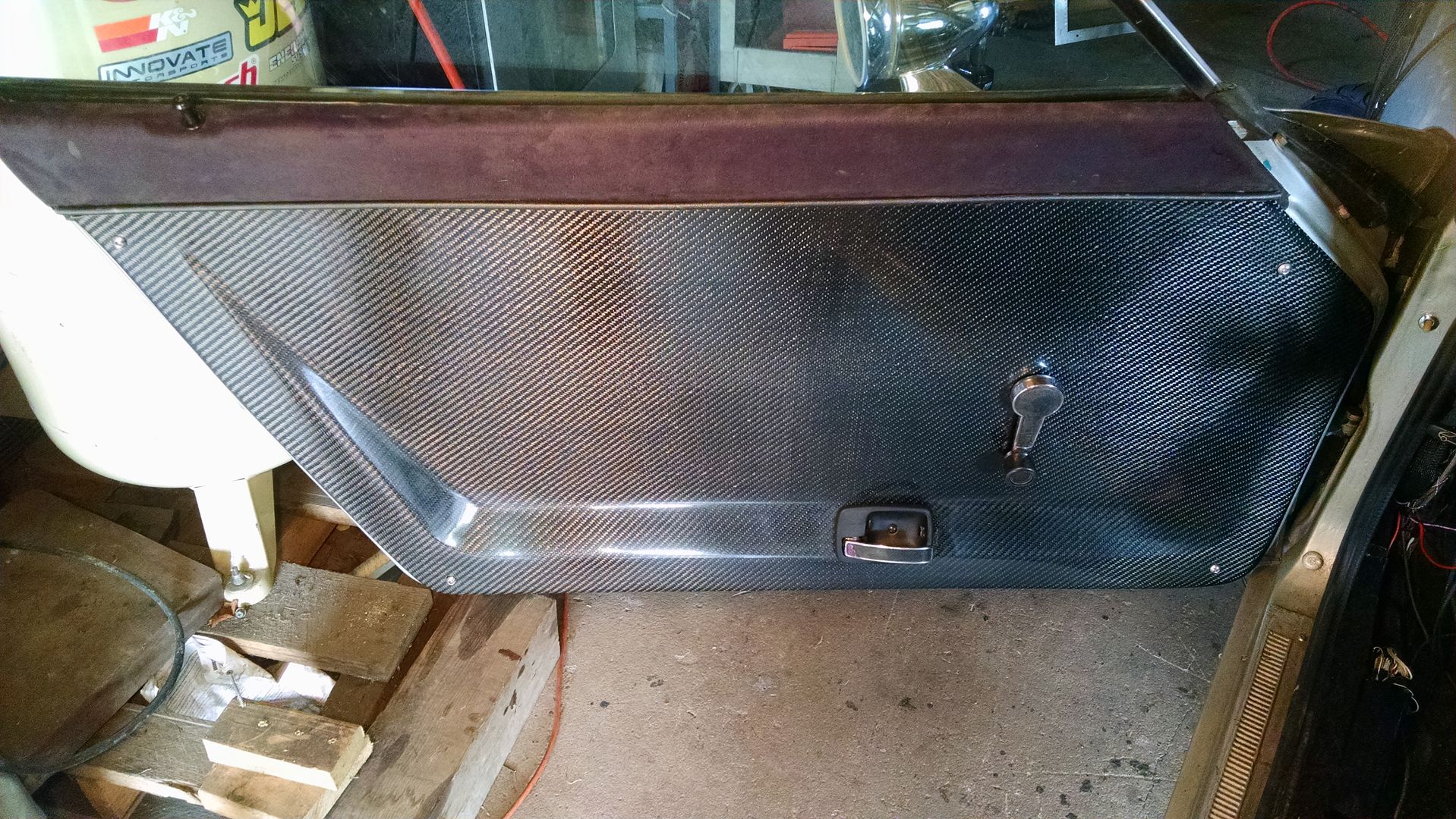

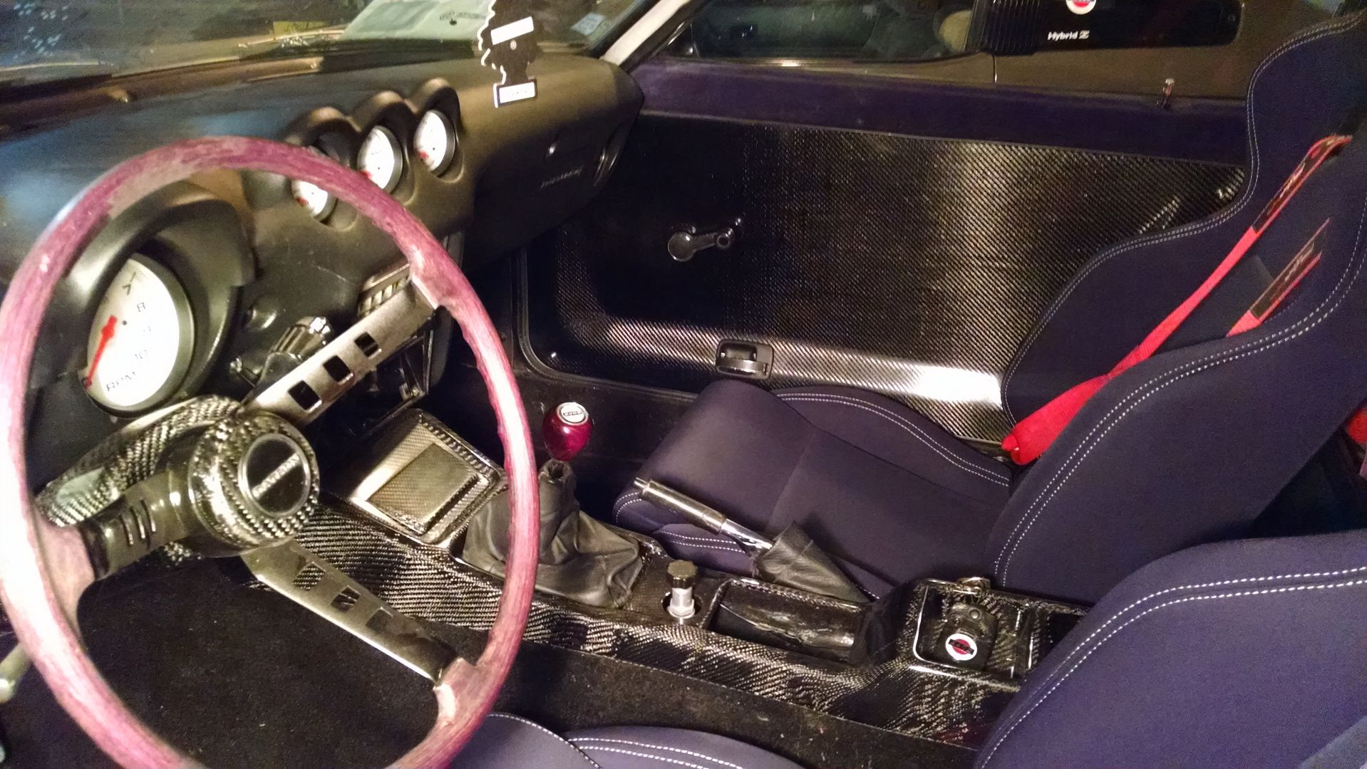

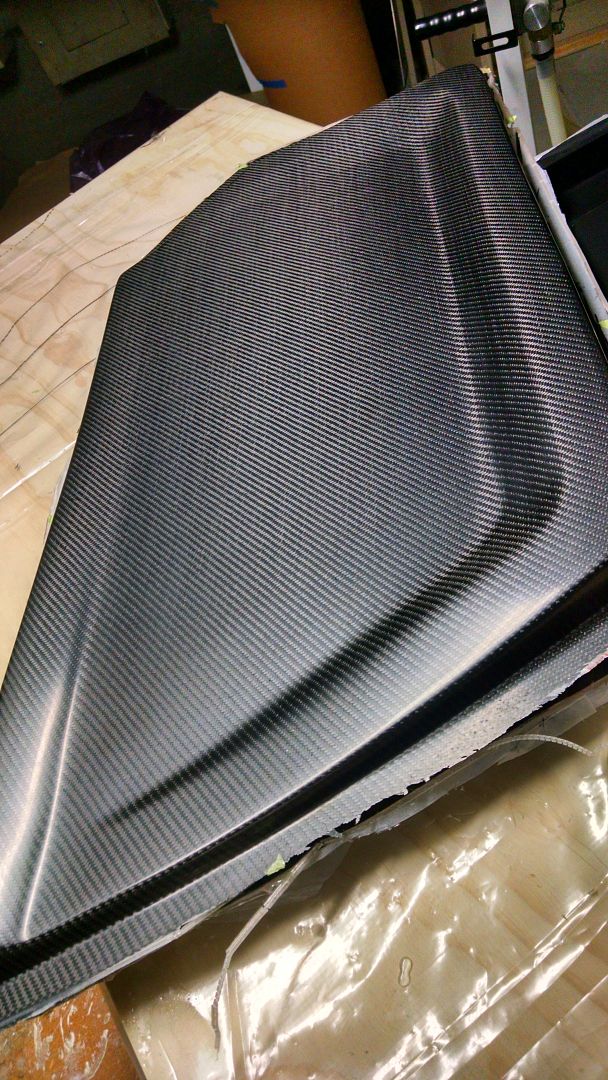

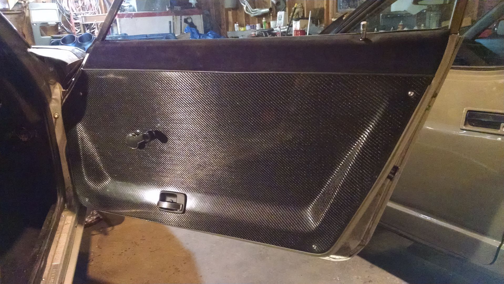

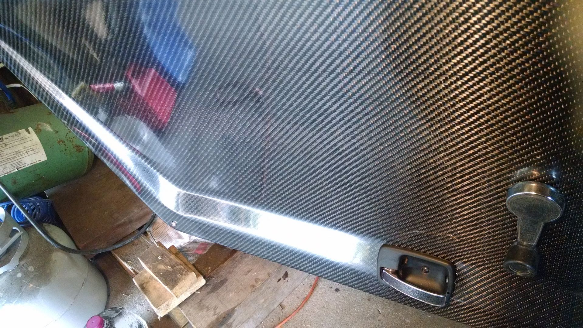

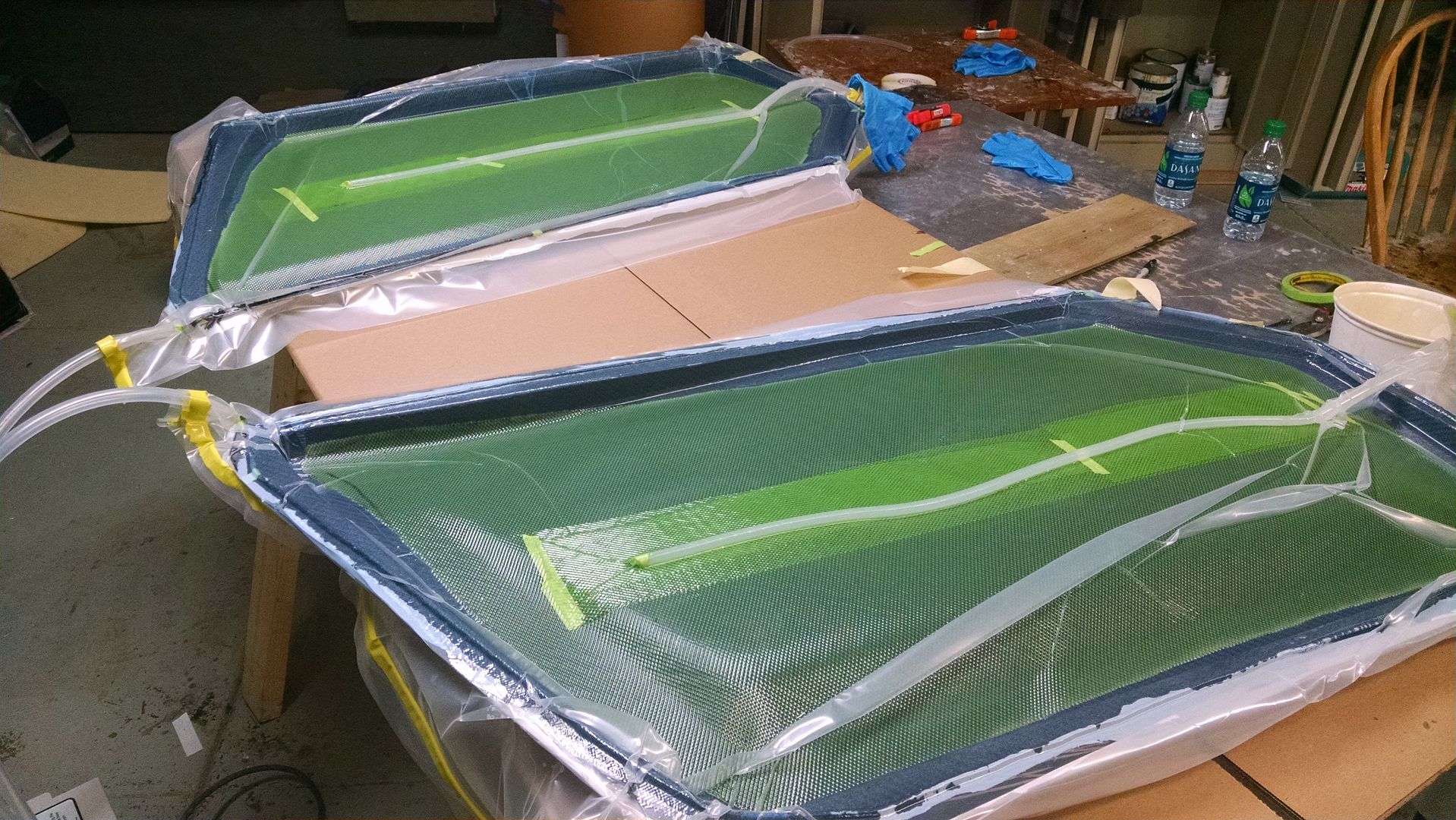

Minor updates. I made a set of half door panels for MY car.

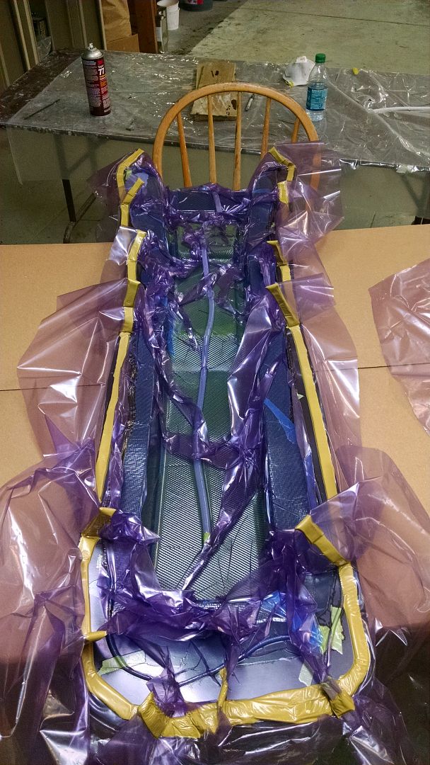

Infused.
Popped.
IMG_20150608_111146071_HDR_zpsmhe7q9ag.j
Mounted. I NEED to see the car outside...Taking low light indoor pictures of this stuff is beyond tedious.

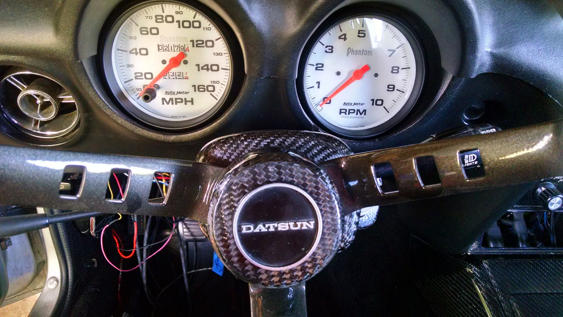

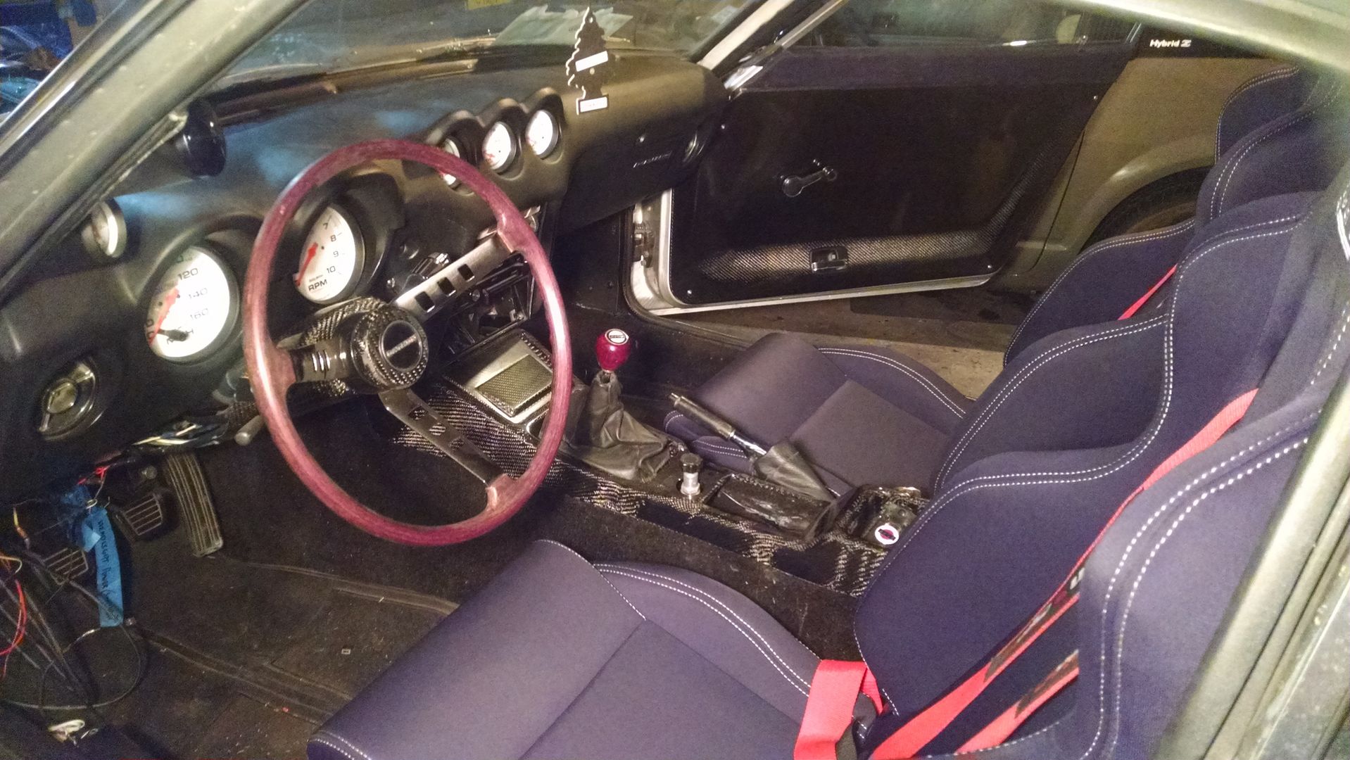

And a small look of the theme I've created for the interior.
Even with the janky #001 console, and gorrilla taped clamshell it looks decent. Once I build my dash, then that will REALLY complete the execution I'm shooting for.

This is the first time I've been able to appreciate the interior work I've been doing behind the scenes as a build the car.
I'm very excited for what I know this will become.
For a starting point, I'm quite happy.
I can work with this. Oh yes, I can work with this.

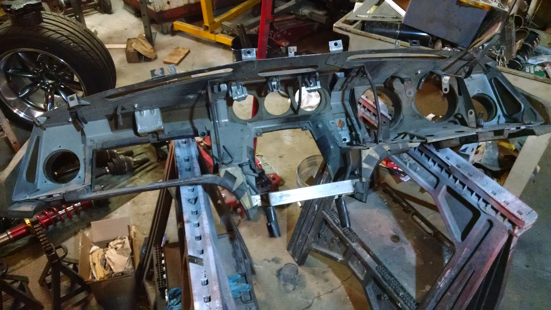

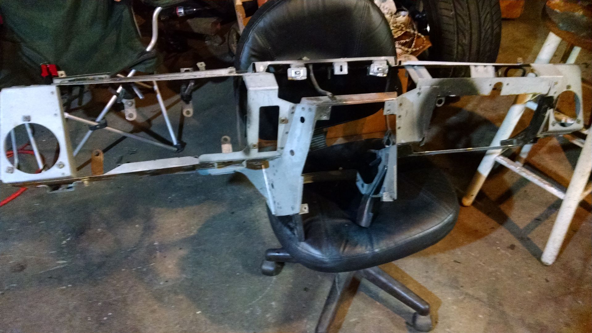

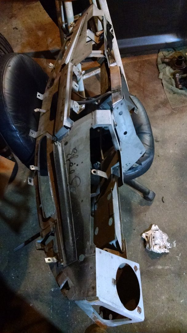

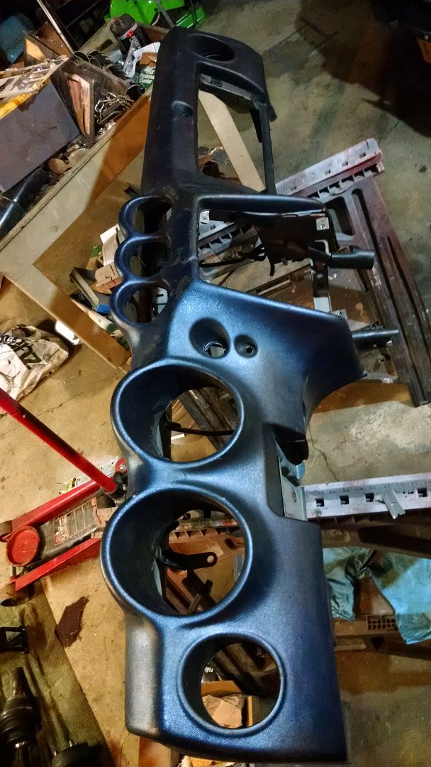

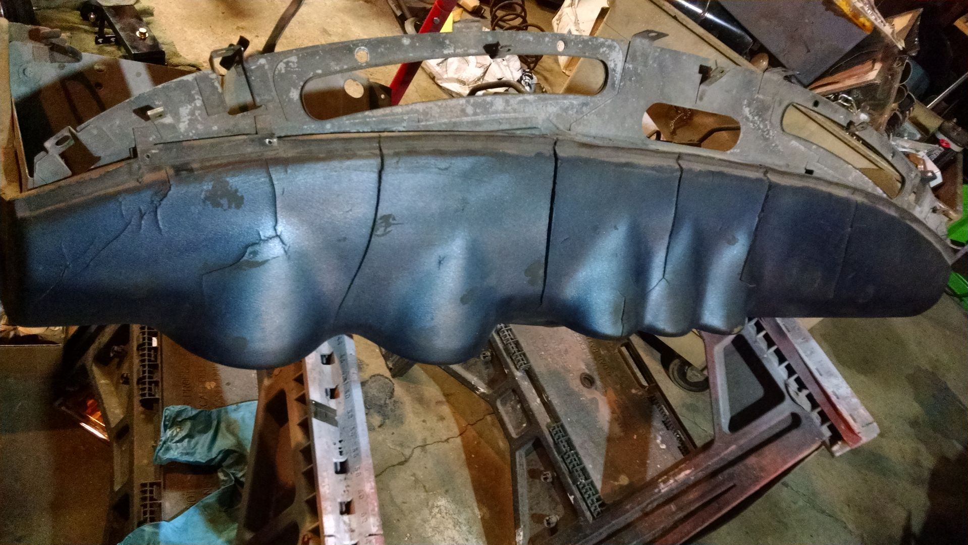

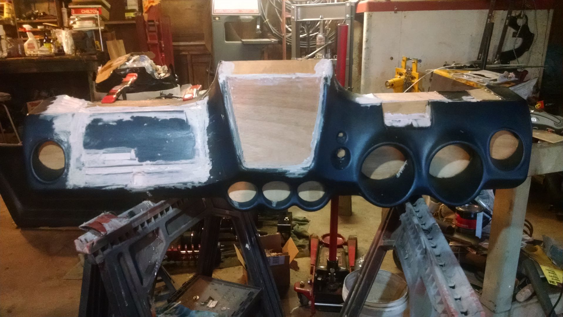

Starting out with essentially the worst plug in history. Literally falling apart in my hands.
Metal framework.
I'll be going back to this to chop mounting bits off for attachment points on the new dash. Weight savings is the #1 priority with this micro project. The OEM dash is heavy (at least 20-30lbs). I'm hoping to have my gauges weigh more than my dashboard. That's the goal.

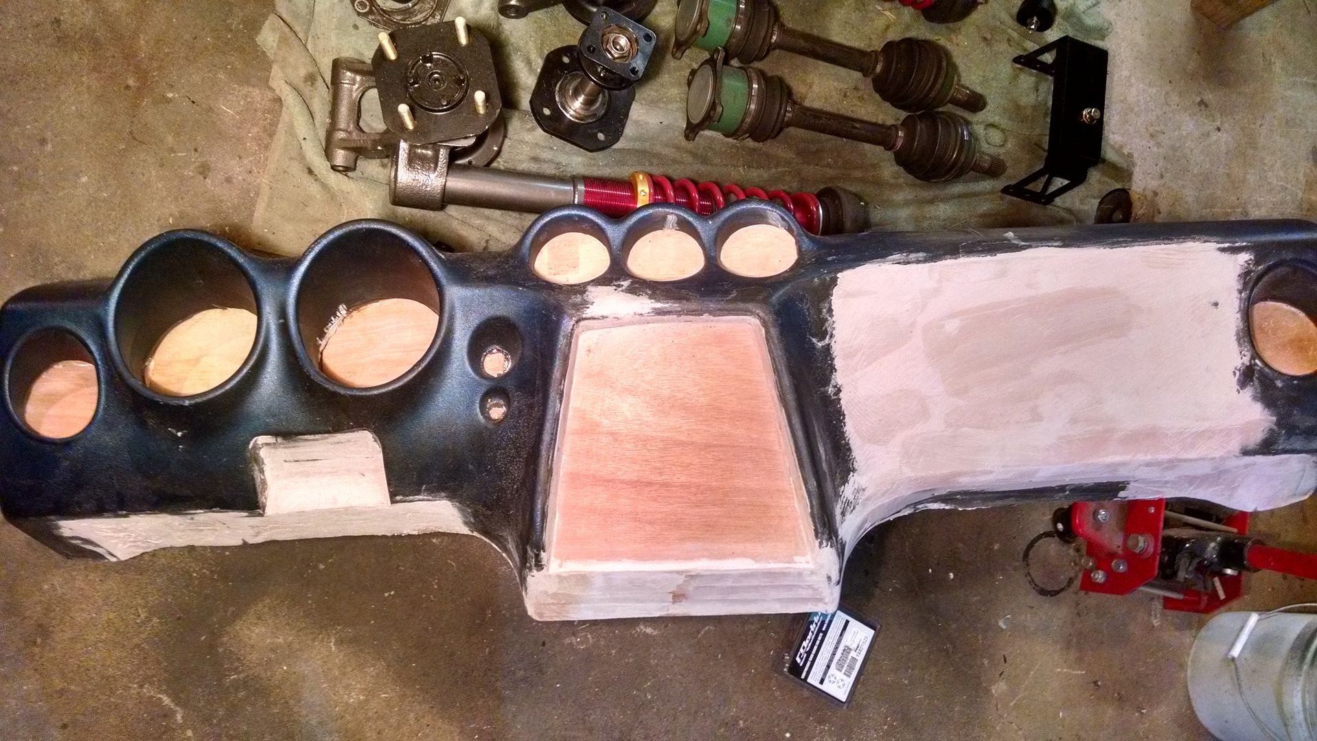

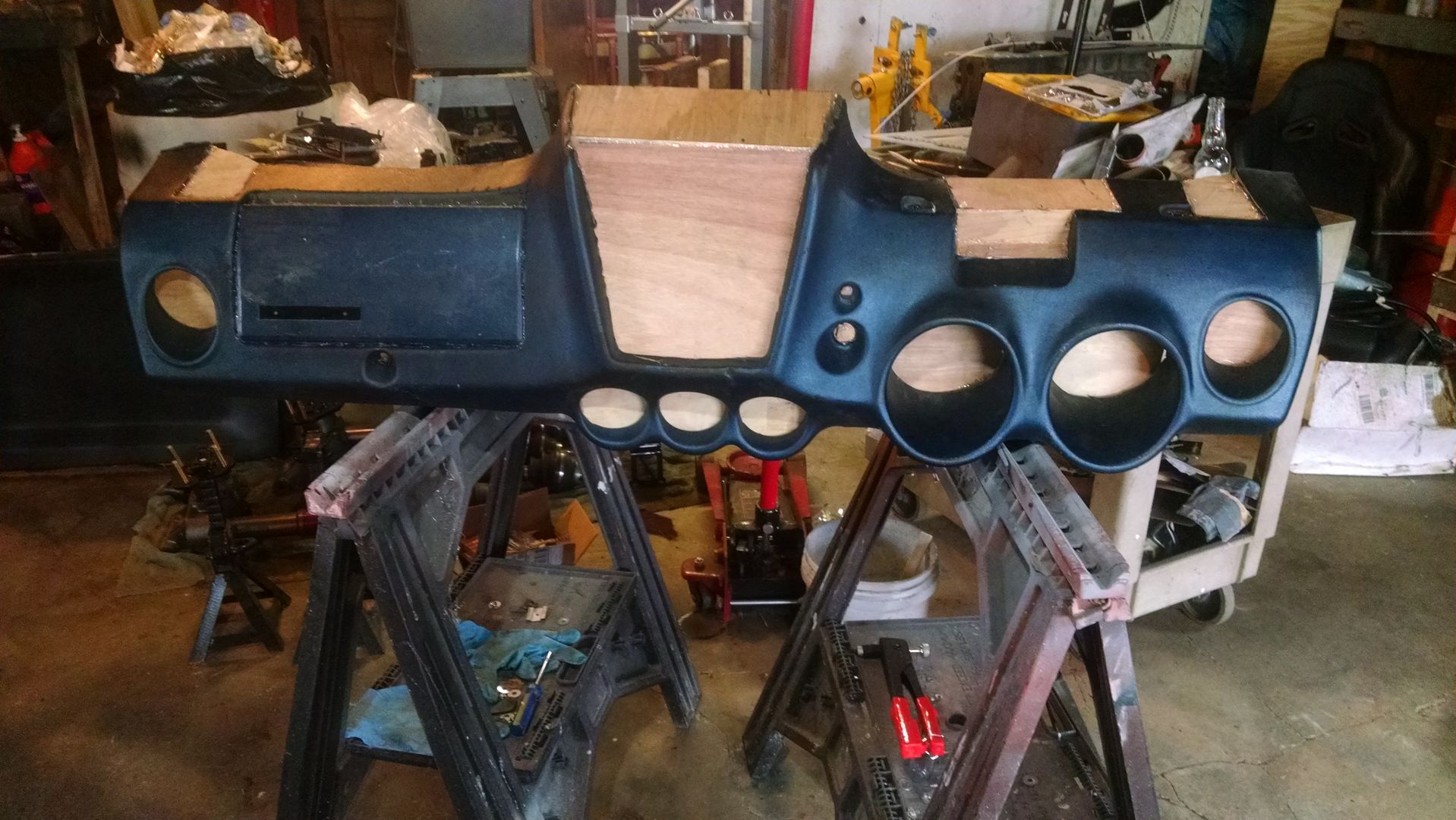

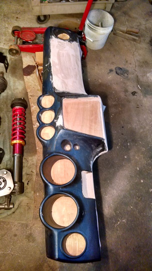

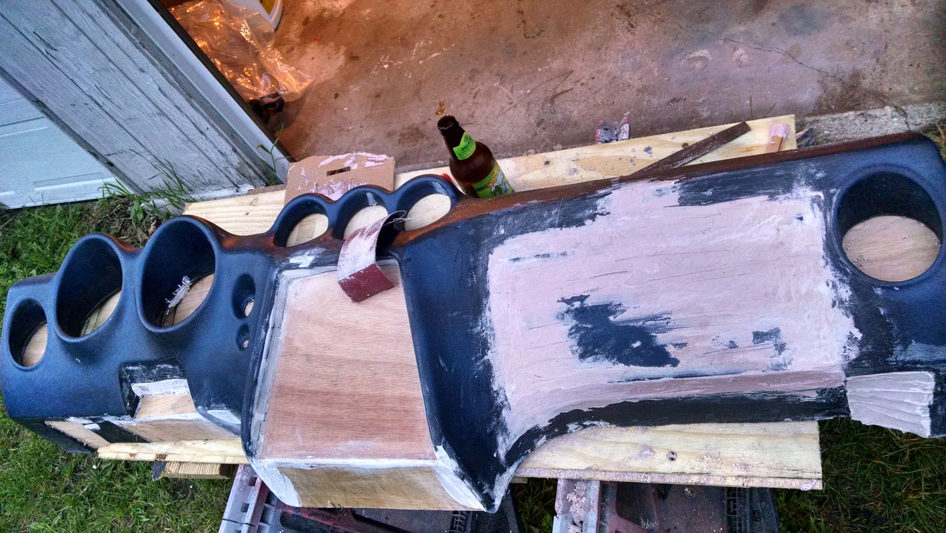

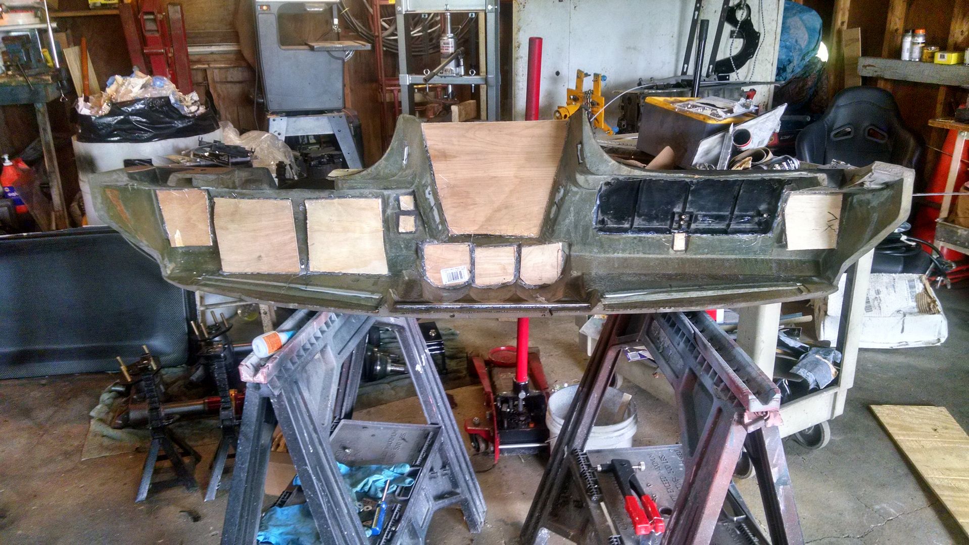

With room to spare, I started capping off all of the openings - No more glove box. hoping for a clean look. Grassroutes composites, glue gun, five minute epoxy and scrap wood. :D
IMG_20150614_150425913_HDR_zps3adza8ft.j

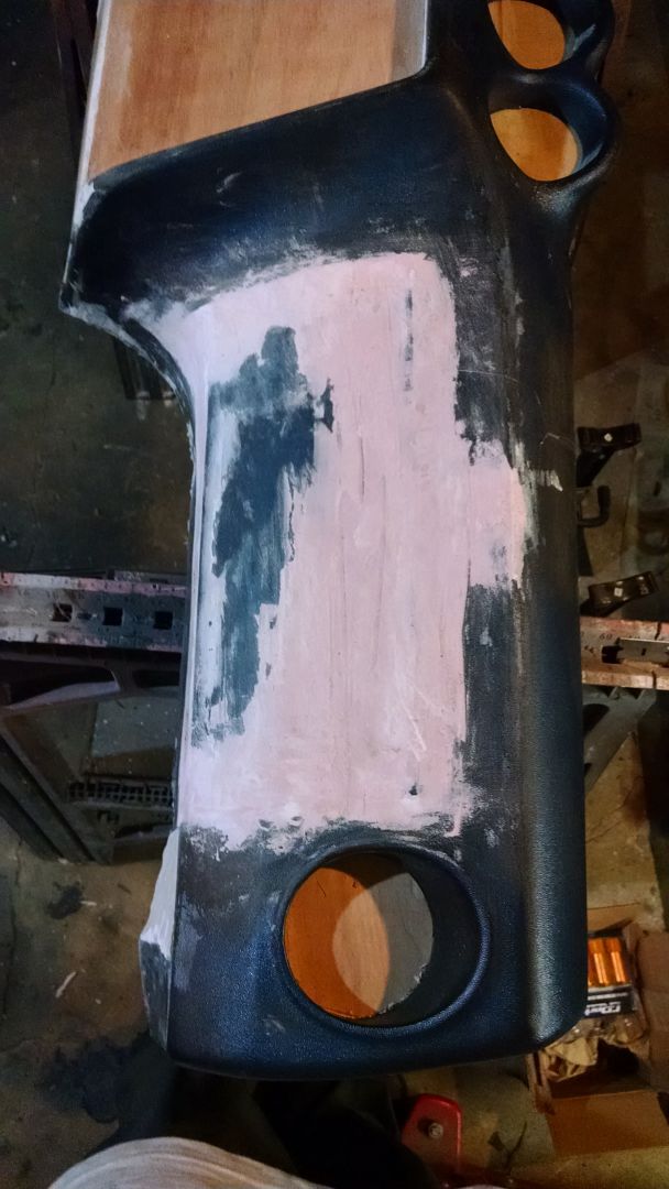

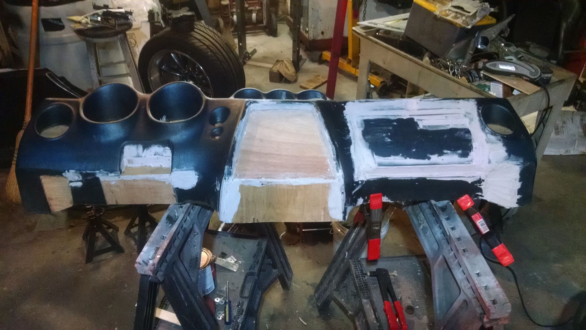

And where I've left off. Some filler - beginning to fair the plug.
Contrary to how I have been making parts in the past I am changing my approach with the dash.
With the dash, due to some complications in the geometry, I'm planning on having the plug be entirely sacrificial. Meaning that it will essentially have to be torn out of the mold, most likely in pieces. So obviously I won't be spending too much time beefing it up.
The same will likely have to be done to the mold. It will most likely have to be either cut, or broken in order to release my dash.
A couple things to note
- Only the bottom half has to be pretty, as the top will be flocked.
- These will be hand laid parts, instead of infused - I'm doing this from home, and not the composites shop.
- I only get one attempt at this, as the tools will have to be destroyed.

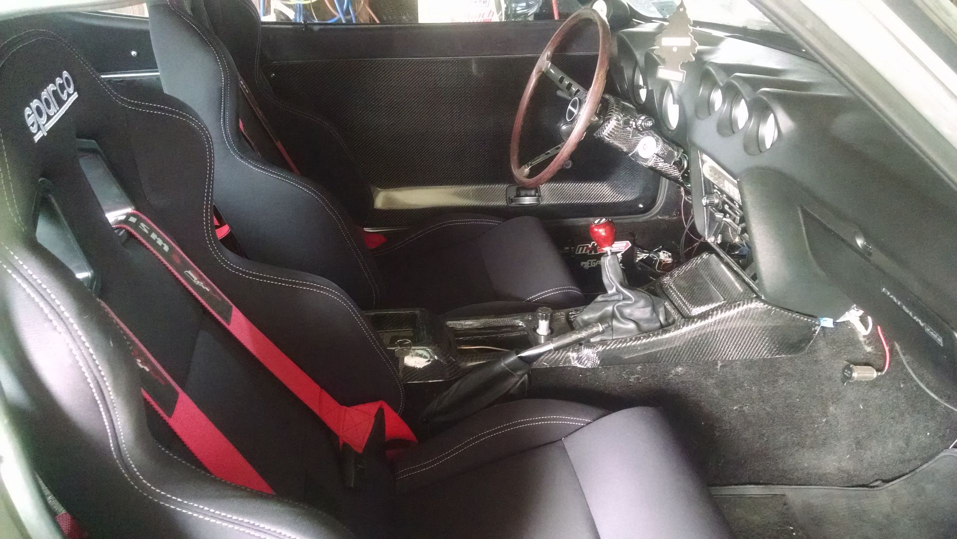

And one more bonus picture. Had a moment of light peak through the doors. Had to snap a picture as finally my seats and black trim no longer looked eggplant in color, due to my phone's confusion with the typical lighting.
Now imagine a two tone carbon dash there instead.

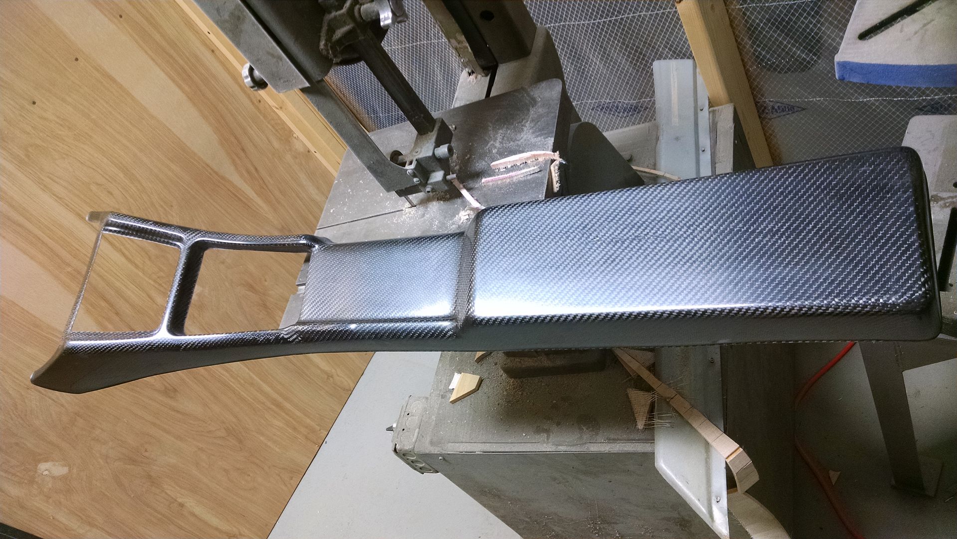

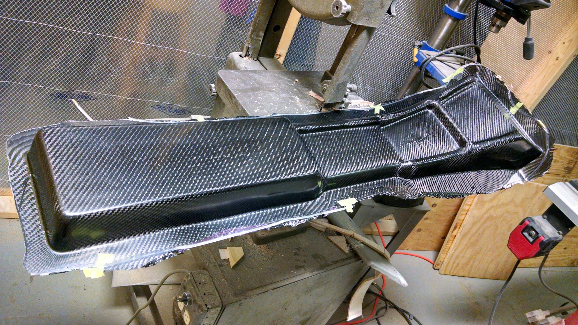

Moment of truth.
Cool! Looks acceptable. Certainly an improvement over the original console. Should be a nice replacement.
IMG_20150616_105257121_HDR_zpspcbstbv9.j
IMG_20150616_161025302_HDR_zpsilbwftop.j

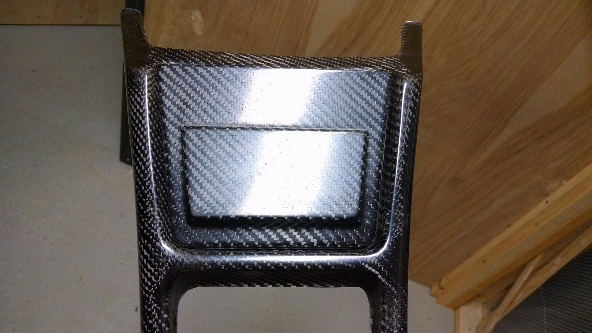

I made the insert for the console today. Contingent on it passing quality control, I will bond it to the console tomorrow. Then we can see it in the car. :)

So what about the frame, are you making everything fg ?
When I talked to my fg guy we kind of agreed that for what little weight saving we would keep the frame to simplify things. No chance of screwing up mounting points and a LOT less fab.
What about the deletes? Are you doing the glove box later ? Or is this just a race dash with no heater and glove box?
Edited by madkaw
You shouldn't need to replicate that framework, if you develop a proper layup. My initial plan is to only use bits of the framework, to retain the mounting points. I can chop and tab on whatever I find necessary.  Time will tell though.
Should that plan fail, I will always opt for using the frame in full, but I'm fairly confident that I won't have to use the vast majority of it.
I never use my glove box anyway, and designing a dash that has a glove box would mean at least 4 more tools, and that complicates things exponentially... Plus I like a nice solid plane of carbon.
I am however, keeping my heater function. It's cold up here, and defrosters are nice :)
