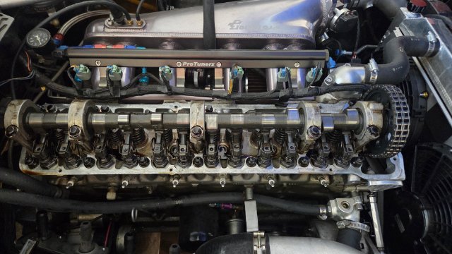

Haven't done a whole lot to the Datsun, but it's partially due to lightened sense of urgency. I've officially moved back to the use so I feel less rushed to get things done. Mexico was great for four years and time will tell if I regret leaving. I loved living there and will probably be making constant comparisons but mostly moved back for a better job and being closer to family. I bought a boring daily for commute duties. Still debating if I should have just committed to something much much cheaper with a bit more character, but I've enjoyed it so far and it already got me about 3k miles on my summer road trip. Didn't do the summer road trip in the Datsun due to a coolant leak. Was already doing some summer practices and parades with my new students so I didn't have a chance to track it down and didn't want to risk such a long drive in the well above average July heat. Finally had more time and still couldn't track down the coolant leak. It was only happening when hot, so figured I'd retorque the head bolts and see if it helped. Head gasket seemed like an unlikely failure right now, but I installed the block completely untouched so I figured it might help. Most of the nuts on the arp studs moved about 45-90 degrees to get them to spec! I power washed some of the greasy parts of the engine bay afterwards in case I still had the coolant leak to make it easier to track down. Seems bone dry after about a half hour drive. Don't know if they weren't retorqued after initial heat cycles and have just slowly gotten worse or maybe the head gasket is actually failing but I think it'll at least hold me over until I finally rebuild properly with more adequate compression and a better cam for earlier boost. -
