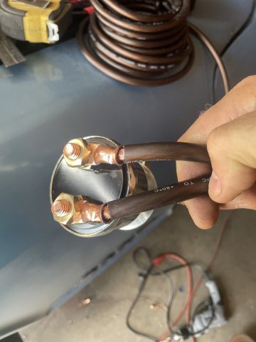

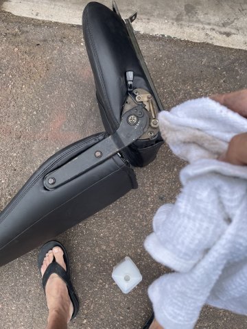

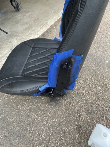

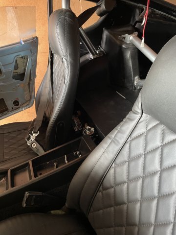

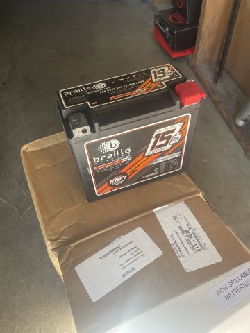

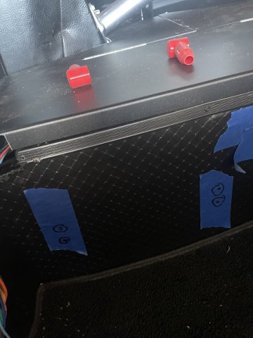

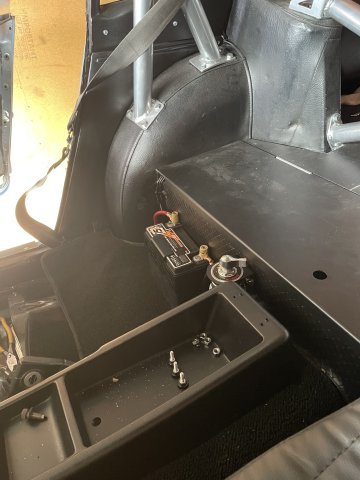

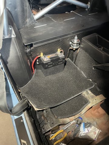

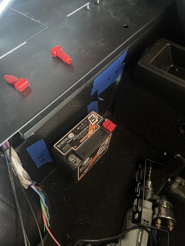

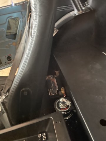

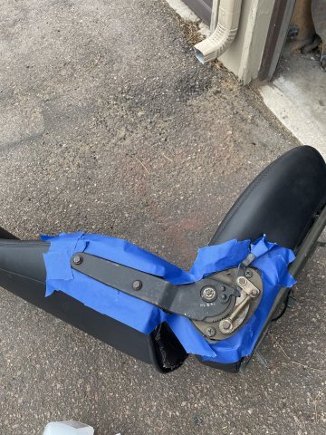

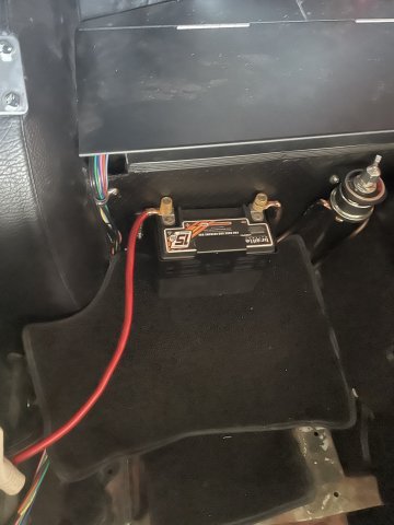

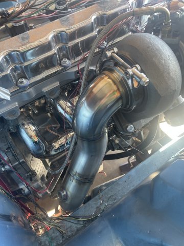

05-13-2026 ATLAS Z UPGRADE: I picked up my intercooler piping from the fab shop and dropped off at J&S Polishing to be all done up except the exhaust.....I have to finish the other half of it. The welds really look nice. My Braille Battery arrived to go with the Skillard battery hold down bracket. I went ahead and mounted the battery and the disconnect switch behind the passenger seat. I took the time to paint the areas in the foot well behind the seat, and painted the sides of the passenger seat and began putting things together for good. Pretty good for just a 3-4 hour break in the garage. PICS:
