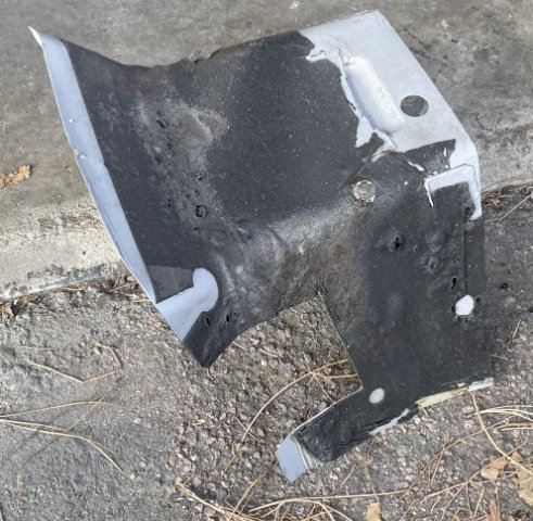

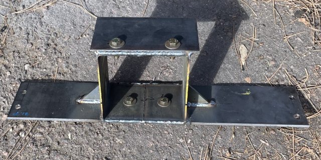

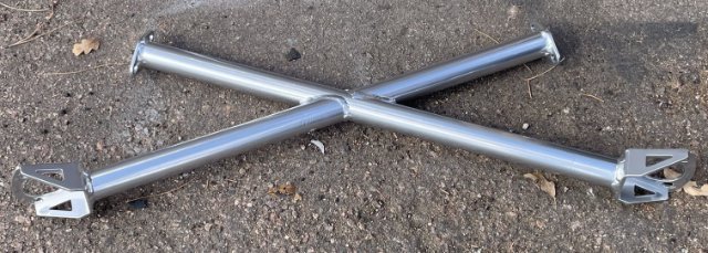

  2. 02-26-2026 ATLAS Z UPDATE: Today I got my rollbar and rear strut brace back from the powdercoater as well as the tunnel I dropped off to sandblast. The rubber is still on there, but this yucky sticky layer of honey look goos (glue) is gone. I also picked up my trans mount, he welded it up and added gussets on both sides out of 1/4" plate. I painted the back side quickly before I ran out of paint. Ready for the next day in the garage! P.S. self tapping screws and sheet metal (18 ga) here and ready to built it back, then the welder will stitch weld it and weld the plates over the top and over on both sides to the door jambs. 1/4" thick, 4 inch wide plate. Car will be overbuilt int his area like I did with the radiator support. 350-400 horsepower you really have to, even with the reinforced floor I have.

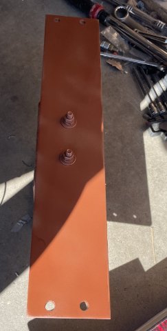

  10. 02-21-2026 ATLAS Z UPDATE: I made the template for the electronic, "drive by wire" throttle, and then started bolting together the parts of my Skillard rear deck flooring. I sits about 2 inches up from the hatch floor. There are some pieces that are missing, so I went as far as I could with that this time, and then I jumped on getting a transmission mount built. I used a 6" steel square piece as a spacer, since I have such a large space to fill up. I have it 90% done, I will have it welded up and a couple gussets cut and welded in, and then either powdercoat it or paint. Lastly, I started cutting on the old trans tunnel, and figuring out what I need to get as far as some 18 ga steel to cut and form in there. I will end up screwing it together and then the mobile welder can stitch weld it together, and fully weld then the plate that goes across, but that work didn't happen today....it was COLD and I got tired of my feet being numb. PICS:

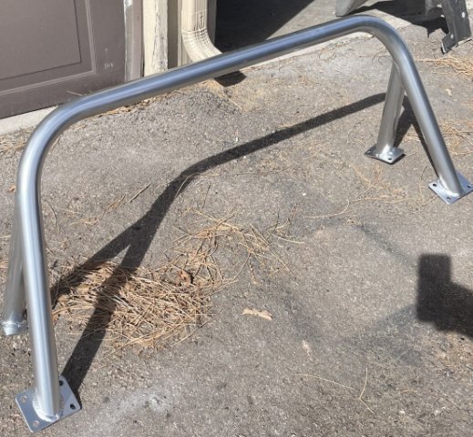

  14. 02-19-2026. ATLAS Z UPDATE. I trial fit the rollbar and rear tower brace, and then dropped them off to be sandblasted and re-powdercoated in "polished aluminum" which is what I had my bellhousing done in. Then I worked more on the dash, I still need to wire it, but I got all the gauges in, the dash plaque in....for the dash plaque I had to build up the back, as the hole makes it DEEP.......cardboard stacked up to the right height and glue, then silicone caulk to hold the badge on, looks pretty good I think. a 280 dash but the plaque says 260Z.....so pretty rare sight in the USA. So, you can now see how the dash will look in the car God willing. I also ordered the skillard lower piece that goes from the center down to the console and also serves as a stereo block off plate. I will be painting it matching gloss black hammertone finish, and the console floor will be that color as well. The gauges didn't go in totally as easy as the install makes it sound....I had to get inventive. Not too bad. PICS:

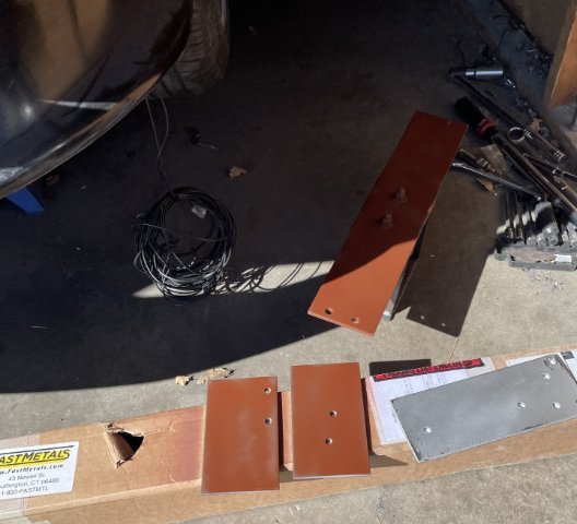

  17. 02-18-2026 ATLAS Z UPDATE: picked up my 1/4" thick steel plate for making the transmission mount, set out my seat belts for cleaning, and my rear strut tower brace from Apex and a Autopower Street rollbar from Motorsport Auto have arrived. So, I will decide what color I want to powdercoat stuff (gloss black of "polished aluminum") , and keep pressing forward. Will be COLD for a few days, so any work done will be indoor stuff. PICS:
