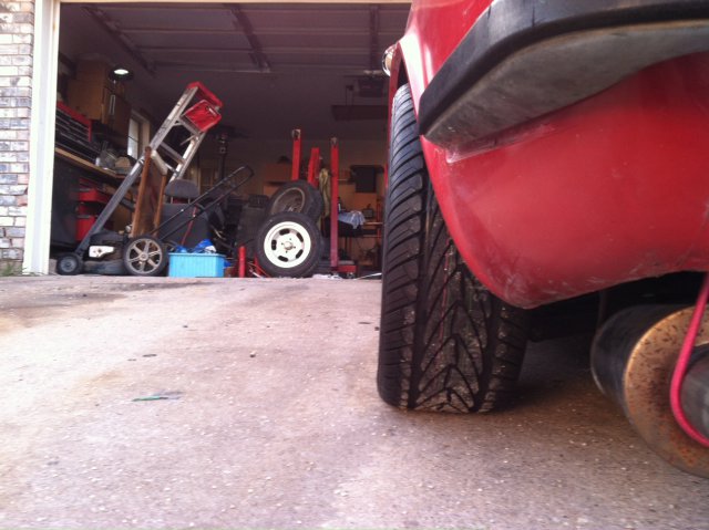

  1. I have 7 inch wide wheels, and I dont think I have more than a half inch of clearance (between the rim and spring perch) in the front.. food for thought.

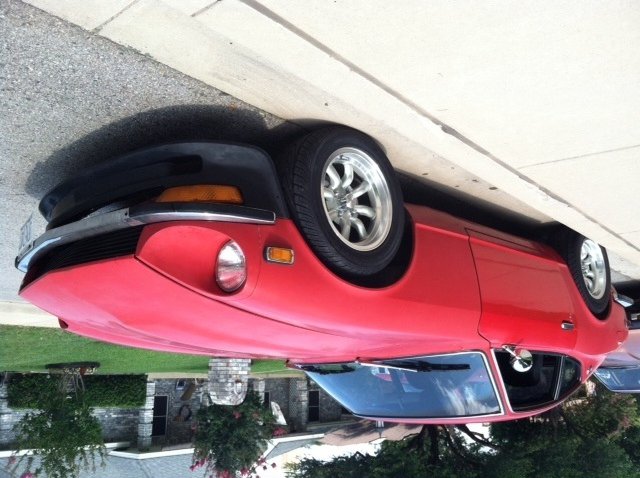

  4. With the new airdam on.. I like the way it looks.

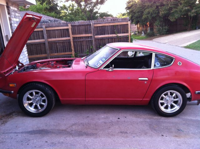

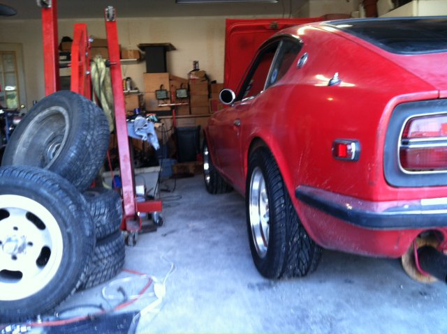

  20. Put new wheels on, 15x7(225/50s) with tokico suspension. I think it looks pretty good, happy I went with 225s over the 205s.
