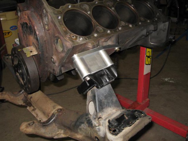

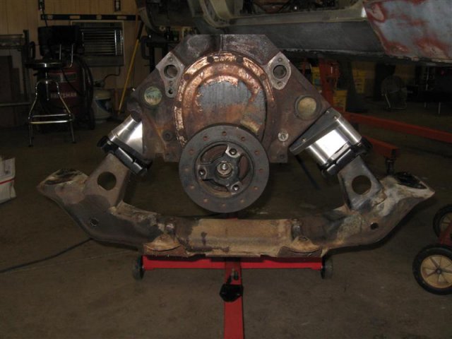

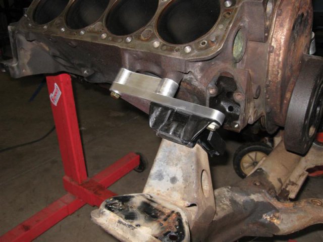

Well, I made a goodwill jesture to the herd of spiders that live in my parts car and they allowed me to remove the front crossmember. Here we have a front view with the 1-1/16 spacer on the passenger side and the 2-1/16 on the drivers' side. Here are each mounts as I assembled them. This makes the most sense to me. Passenger side: Drivers' dide: The mounts might could have been a little thicker but this combination fit without drilling out any holes larger for additional clearance. A level on the top of the block and on the crossmember indicated the block is level with the crossmember. chris
