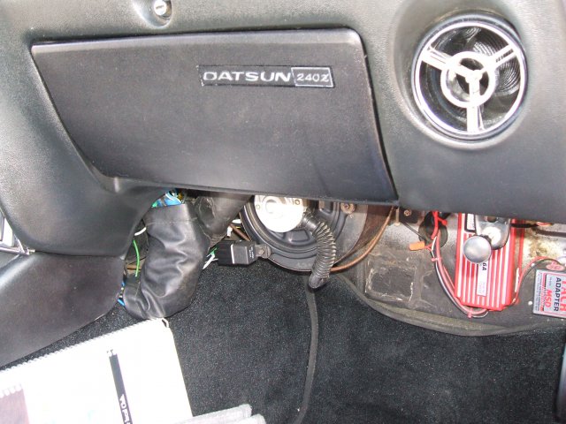

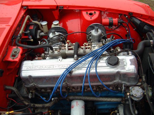

Moving back to the states meant a local Z support network, which meant more upgrades....we replaced the 2.4L with a 2.8L, using the same Sunbelt head, but now with a stage 1 port job, and a custom Isky Cam....also installed the PDK Fabrication Strut tie bars, and GC Coil-overs...upgraded the trans to a late ZX close ratio 5 speed, and a 3.5 diff. Also added was the Trip Weber package 40DCOE18...made in Italy Baby . We also did the Honda blower upgrade as well as the Headlight Relay Kit from Dave

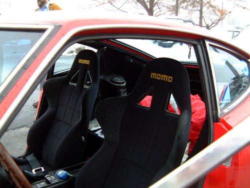

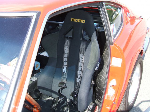

While stationed in Italy, We did a refresh of the body to repair some hail damage. The shop chose a beautiful Sikkens Ferrari Red for the paint. They really did a wonderful job on the car....who better to work on a 30yo sports car but a buch of Italian car nuts.. We had also installed some Momo seats and I had Sunbelt build a head for me....what a pin that was getting from Atlanta to Venice with that in my luggage..customs are , anyway we did a stock rebuild on the 2.4L and brought it home. We returned to the States in 2002...some pictures at Datsun Dynamics winter 02-03 These photos are courtesy of S30TRBO

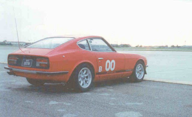

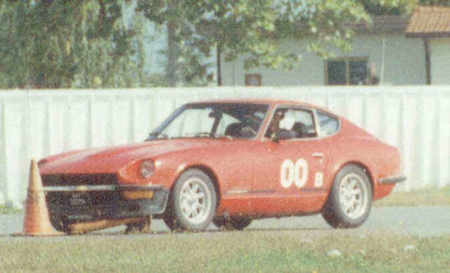

The first mods we did were basic....Stripped the tinting, lowering springs, new shocks, Air Dam, 6-1 Header, Z-therapy Carbs, 5-speed, Panasports, and swaybars. We had shipped it to Italy with us, and I started Autocrossing with the Aviano Air Base Sports Car Club.
Well, instead of starting this when I got the car, I decided to wait...then I waited some more. Fast forward 10+ years and I still have not posted any sort of progress thread on this project. I guess you could say that it has not been a project at all, but a continuing endeavor to improve the car and stay in a SCCA Auto-X class, and be competitive. It all started in May 1998, my bride to be decided to replace the 72 240-Z I sold (to buy the rings) with a "new" 240-Z.
