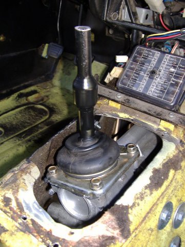

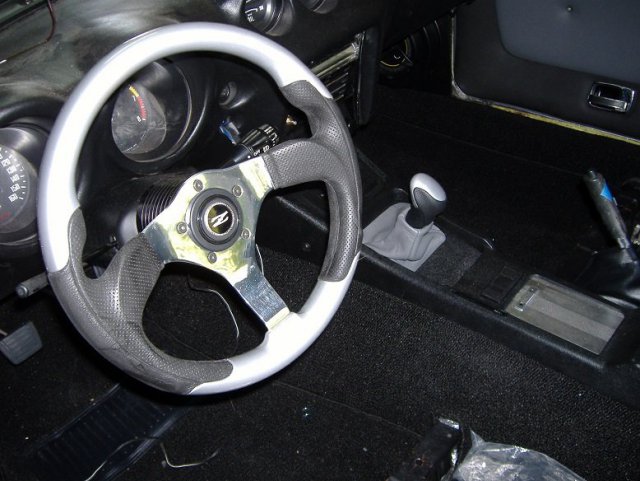

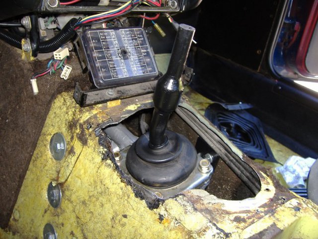

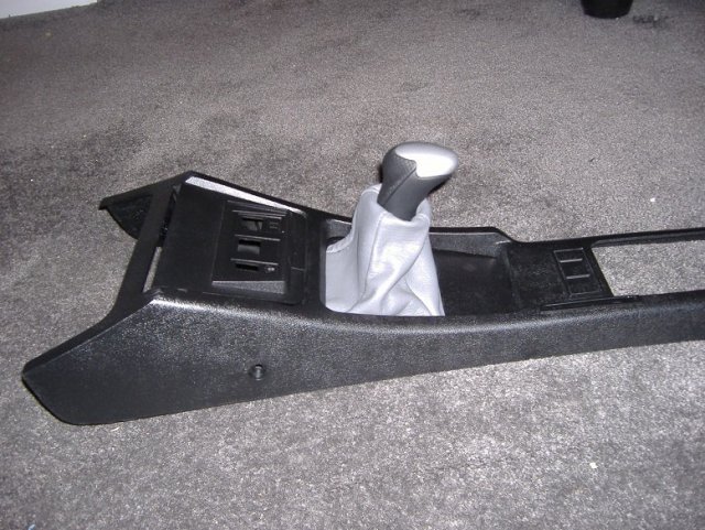

Welcome I have used the T5 transmission in two 240Z SBC projects. No problems and the transmission fits easily in the car. The transmission is tilted 15 degrees towards the dirver's side, but is not a problem and only requires trimming the left side of the shifter hole. Shifter location is close to stock. Useful information Download a Factory Service Manual (FSM). Download electrical schematics for your car. PDFs are easier to read than those found in books. Some are in color. Buy the book How to Restore Your Datsun Z Car by Wick Humble. It will save you hours of searching for "how to" info. Focus on searching Hybridz as 99% of questions have already been addressed. Start bookmarking Z car parts suppliers - there are many! Remember these are 40 year old cars and will need restoration to be safe and drivable. Join ClassicZCars.com website and search there as well. Become well informed about modifications before asking questions. People will be more inclined to answer informed questions. Search Google: "240z LT1 swap" etc. Tons of data on 240Z V8 swaps on-line. Spend a lot of time planning and costing the project system by system before starting the build. Useful Links: https://www.datsun-240z-upgrades.net/ Recommend the headlight relay harness. The owner is a HybridZ member who provides electrical upgrades and repair services. http://zhome.com/ https://www.zcar.com/ http://www.classiczc...com/index.html/ http://www.zcarparts.com/ http://www.arizonazcar.com/ http://www.jagsthatrun.com/index.html

The T5 is rotated 15 degrees towards the driver's side. Requires removing a small amount of sheet metal on the drivers side of the shifter hole. I also shortened to shifter. Once all of the trim is in place you don't notice the 15 degree tilt to the left. I used the MSA engine-trans swap kit so there may be some differences in shifter location with the JTR kit.
