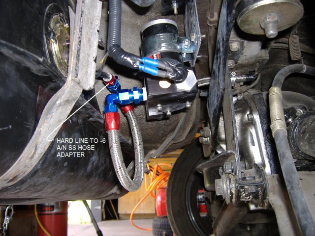

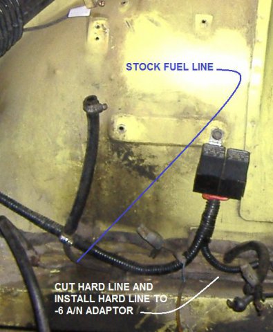

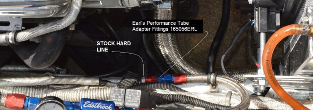

I do have a question. I have searched this site and not found the full answer. There are three fuel lines coming from the rear of the car. I believe the smaller one is a vent line from the tank, and the other two feed fuel and then return what is not needed (as FI systems like to do). To clean up the engine compartment a little more, I am thinking of eliminating one of those lines. My engine will mount a carb--a new, still-in-the-box Holley 650 that came with the car, so I won't need the return. If that's a bad idea, please tell me. And could I vent the tank back in the rear and bring only a single line to the engine compartment? That would really tidy things up. Is that done? For a carbed engine all you need is the fuel line. Trace the return and vent lines back to the gas tank and mark the tubes that they connect to. Any tubes not used on the gas tank will have to be brazed or welded closed. You can also eliminate the vent tank and all of the hose connections to the gas tank. If you eliminate the vent tank, you will need to drill a 3/32" dia hole in the gas cap to vent the gas tank as it empties out. There are several threads on this throughout the forum. Keep at least one of the vent tubes on top of the tank bulge and run a hose to the gas filler hose nipple. This allows air to escape while filling the tank to the top of the bulge. Attached are pictures of my 240Z fuel Lines. I haven't had any heat related problems, but I did run the fuel line the electrical harness through thermal protective sleeves on the passenger side near the headers. Since you will have to drop the tank to modify the various hose connections, you might as well install a new fuel gauge sending unit. -

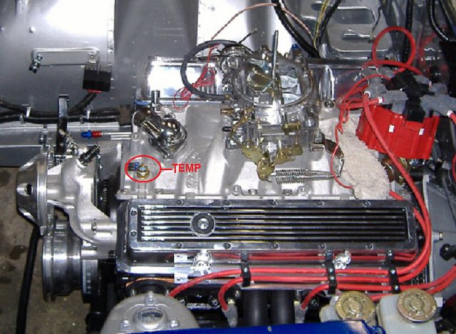

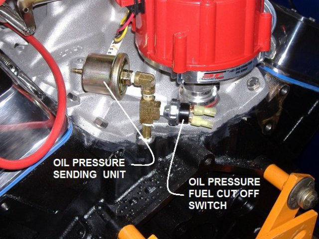

With the stock temperature gauge you have to use the original stock temp sensor with an adapter that screws into the manifold. If you use a temp sensor from a different car, the temp gauge will not read correctly. Same with the oil pressure sensor. MSA and JTR both sell the temp sensor adapter. MSA sells the temp and oil pressure sensors. So just buy everything from MSA. The plumbing for the oil pressure sensor and safety switch is all 1/8 in. NPT you can get at the local hardware store. My 240Z did not have a fuel pump relay, so I installed a Painless fuel pump relay kit and ran the safety switch to the trigger side of the relay. On the 240Z there is an unused green fuel pump wire above the passenger kick panel. The wire was intended for an electric fuel pump and terminates near the gas tank. Your 280Z may already be wired for an electric fuel pump. If not, Nissan may have also installed the green wire in the 280Zs as well. Note that the JTR manual is a little confusing on how to wire the oil pressure safety switch. PM me if you have questions. -
My new 280Z project -- advice, please
Miles replied to wingwalker's topic in Gen I & II Chevy V8 Tech Board
Note that "A" is next to the return outlet. The answer is "A" because it is in the stream of water returning to the radiator from both sides of the engine. Also, it appears that you have already installed the temp sender in the correct location. The oil pressure sensor installs next to the distributor. -

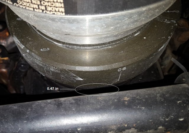

Note: This is a common problem. Search HybridZ , hotrod and chevy blogs. Damper to steering rack spacing with 6.25 inch damper and MSA engine install is 0.47 inch. An 8 inch damper will not work with the MSA install. -
So, here is the question: will the MSA kit allow me to keep the 8-inch damper? And will it drop the engine a bit lower to solve the hood issue? I installed a SBC 350 in two 240Z projects using the MSA kit. The MSA kit sits a bit higher and forward than the JTR kit. Here is the 6.25in damper I am using. Look at the the application tab and see if will work for you. https://www.summitracing.com/parts/flu-620101 Tomorrow I will take some measurements and pictures and post them here. -
