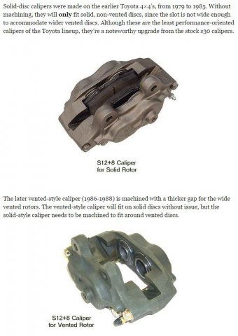

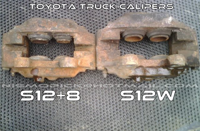

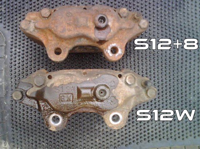

Some years Toyota S12 + 8 calipers (solid rotor application) were modified (wider slot) for vented rotors. The S12 + 8 caliper has two 43mm pistons and two 34mm pistons. -

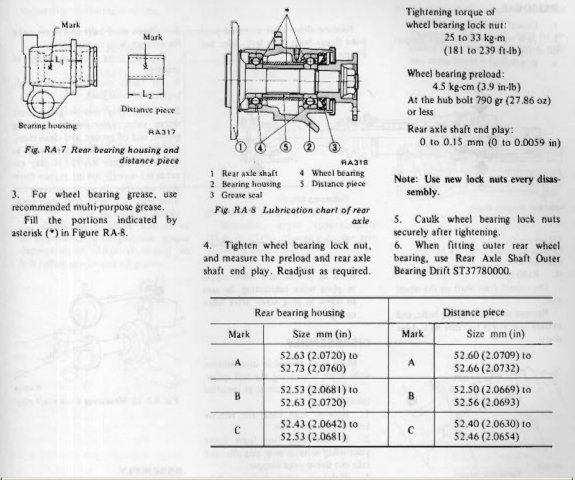

The letter on the spacer has to match the letter stamped on the hub casting. Assuming that the casting is original, look around the hub casting (see picture). Once you have the correct spacer, assemble the spacers and bearings per the FSM for the year strut you have.
