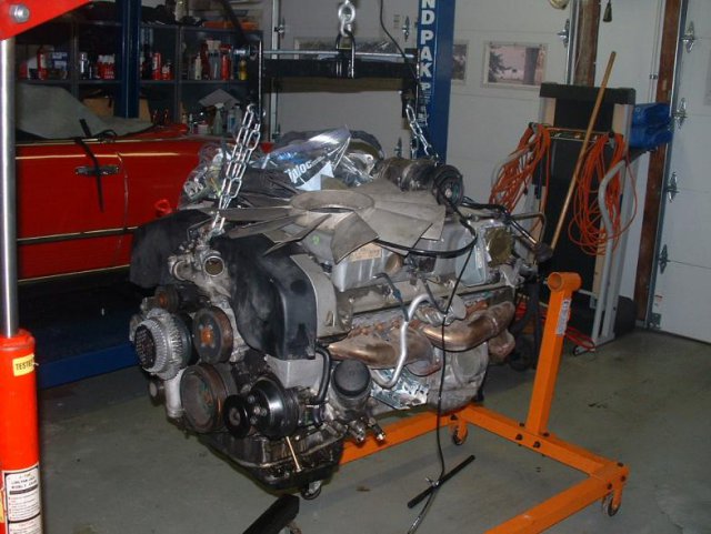

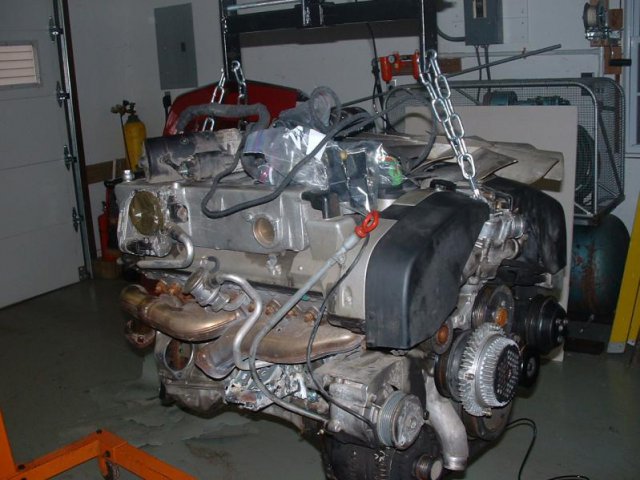

But for right now it has the most terrifying thing I've ever seen in my life, Bosch Electronic Constant Injection System (CIS-E). Priority 1 is throwing it away for EFI. I may add a camshaft and 600cc's of displacement while I'm at it....
Look at it, it's horrifying!
