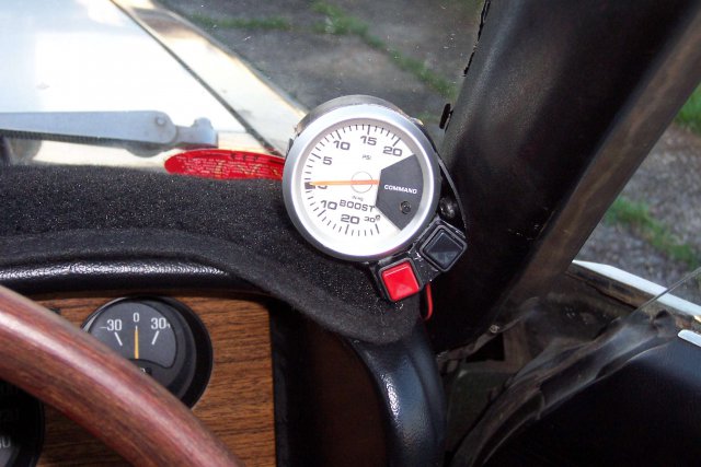

A cheap EBC that works!!! A full review of the HDi SBC-D-SE
Noddle replied to Nigel's topic in Turbo / Supercharger

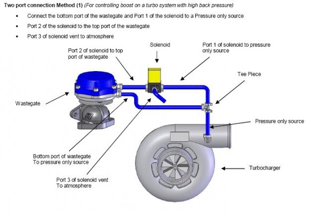

Hi, It appears the forth diagram above is correct one to use for a external waste gate. so, now I have 7PSI (waste gate default spring), with the unit off, 10 PSI on low, and 15PSi on high, I have fitted a remote on/off, and momentary switch to select between lo and high, work very nicely Nigel -
Hi, I'm about to connect my external waste gate, but the instructions don't look right to me, the internal one works by allowing pressure through the solenoid to the wastegate, to open it. the external one, looks like it allows pressure to the the wrong side on the diaphragm. it looks like it allow pressure to close it (?) my waste gate instructions show how I would think I should connect it. can some one give me a idea which is the correct way. I think the second, and fourth picture should be the same (I think the second picture is missing the connection to the turbo at the top fitting) Nigel -
I brought a second hand one, (1/3 the cost of a new one), I hooked up a momentary push button switch to the 2 contact that you showed, connected the unit to a battery (it's not in my car yet), and pressed the button, and lo and behold, it changed boost levels. also looks like someone read your post, mine had loctite on the 2 nuts. Nigel -

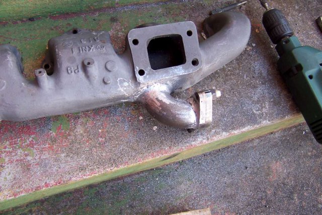

Hi, I spent most of the day outside working on this, as you can see I did pre-heat the parts before welding, not sure if it got hot enough, but it was enough to burn my finger. I just hope I did a good enough job.. Do you think I will have a issue with the vacuum / boost line to my wastegate ? (heat melting the tube) Nigel

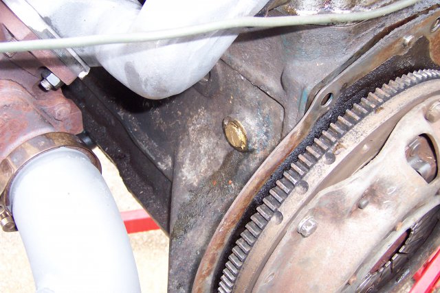

Hi, It's been awhile, the weathers starting to clear up (summer), anyway I was doing some test fitting, and this seems to be the best placement for my setup, I had some issues finding enough room, since my waste gate has such a large diaphragm area, I had to remove the head of the engine block water plug. I'm still very nervous about welding this, so I may just tack it, and take it to a professional. Nigel

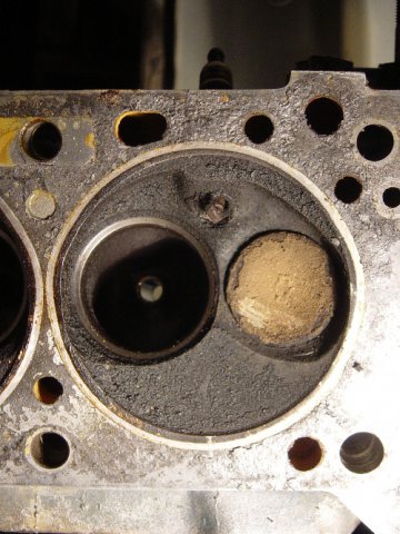

What would be the best head I have for a L28ET
Noddle replied to Noddle's topic in Turbo / Supercharger
Sorry about the confusion of the N47 , MN47, this head was off a MR30 L24e Skyline, and they all have this head ( N47 ), well the ones I have seen. My problem is that i have never seen any P90 heads, I did hear that some of Nissan Patrols had P90's, I will need to look into this more. thank you for your input. Nigel -
I disagree. the dirty one is a N42,the clean ish one is a N47, the N42 has a steep right around the combustion chamber, the N47 does not. the 3rd picture is a P90 Nigel -
A N47 would be more like a P90 (turbo head), than a N42, and when I unshroud the valves, it will remove a few more cc's from the chamber size. -
