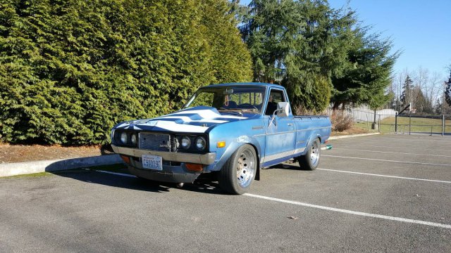

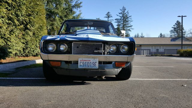

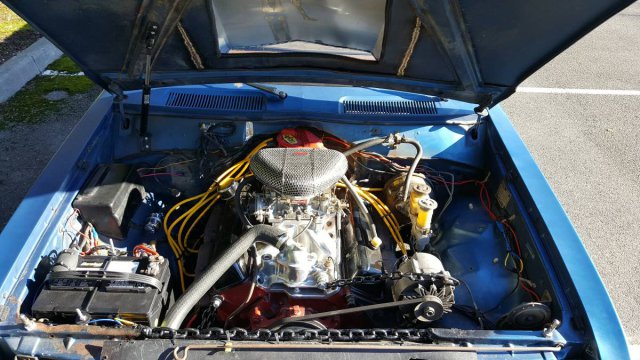

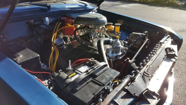

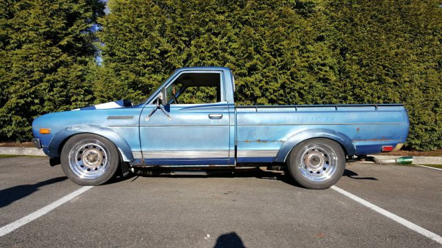

No big updates on the car currently since I'm away from it. But, for a while now, I've been looking for a small truck to carry extra things in, whether it's needing to take a couch home (I have wooden outdoor couches in my living room because I haven't had time/a truck to bring home comfortable indoor couches... granted they fit in with the fireplace and all hardwood floor) or just to be able to get rid of green waste around the house. I was looking at a lot of 22RE engine Toyota 4x4 trucks, but they're always pricey even at over 200k miles, so I started looking at older 620 trucks. After all, I don't need much, just something I can carry stuff in, plus a 620 was the first car I learned to drive in. Last night I made a $2k offer on 307 chevy swapped 620, and it's likely I'll be picking it up this weekend. Can any of you more knowledgeable people maybe point out areas of concern based on the pictures? I drove it a bit last night and it drives well and brakes hard. It doesn't look pretty, definitely a rat rod, but it would work well for what I need. Opinions? -

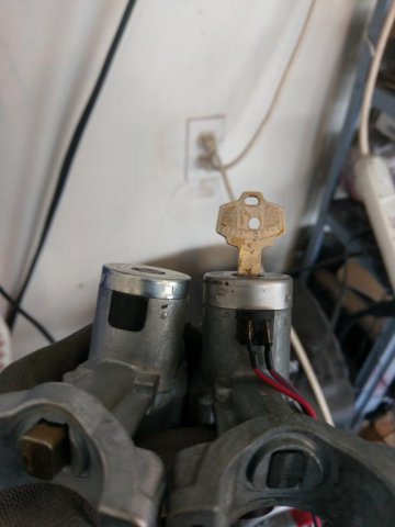

Been putting in some work just to fit the new passenger fender now that I'm home. Required a bit of pushing and bending and some grinding on some non visible spots to get it to sit right. Still need to take a Dremel to the lower fender openings to be able to fit into the now not-quite-aligned openings in the new rocker panels. I got a K&N filter and aluminum tubing so I wouldn't be pushing dust through the engine every time I tested something. It's satisfying! Got patch plates for the rusted frame rail spots in the wheel wells as well as delete plates for the holes from the old bumpers. Also got the ignition switch but it's not QUITE the same and I'm wondering if I should return for a different one, or if this is just how they come now. Was looking through the FSM and I'm not sure what the two wires on mine lead to. I'll add more pics once I'm back home with an actual computer and after I've done just a little bit more welding. -
