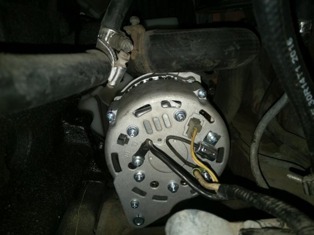

Got the car running with the zx alternator! Splicing was easy, but the bottom legs actually needed a tiny bit of shaving to fit on the bracket Steady 14v-ish with lights on and wipers moving. Garbage I have no idea how people fit the CS130 or 144. Will likely still go with it in the future but this one is already closer to the lower radiator hose. Battery tie downs and door work tomorrow -
Dang, should have thought of that! Might go buy some at the hardware store I guess. Will make things much easier. http://forums.hybridz.org/topic/67531-ac-delcogm-alternator-swap-part-2-cs144-installation/ This link for my own reference. I was finding it near impossible to find a CS130 without ordering. CS144 was about the same work but very heavy and required ordering another pigtail. The work and costs just seem to add up and I didn't want to have such an overkill alternator just hanging out by the engine if I wasn't making use of it, so I just spent a third the price on a later model internally regulated 60A one for the time being. Will be an easier and cheaper swap for now and get the car moving while I focus on other things. Fancy lights and audio won't be used for quite a while anyway.
