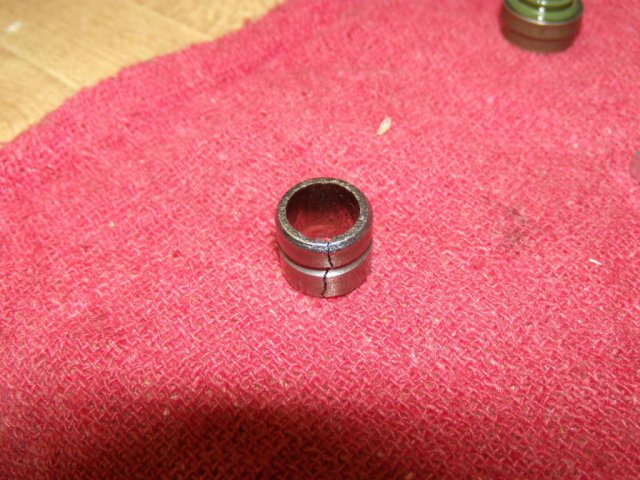

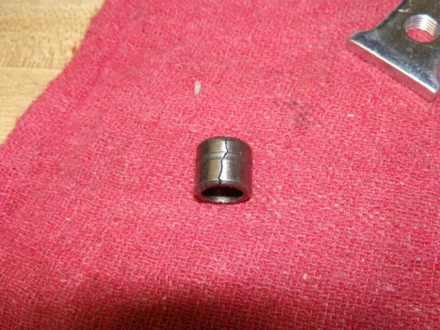

LOL, I think we have an answer! Just came back from the Rebello. The #1 exhaust valve guide completely failed and the rest of the exhaust guides were on their way. Motor has about 1500 miles on it. Dave blames the valves and maybe the stem seals. Going with new Nissan exhaust valves, Supertech intake valves, and different stem seals. All of this reminded me of this thread. Looks like you were right Steve!
The head is in Dave's hands, had a great conversation with him this morning. It's mid-season and man that shop is packed! The #1 valve guide was completely destroyed and the rest of the exhaust guides were on their way, very loose. Dave blamed the SI valves and possibly the valve stem seals so we're doing new Nissan exhaust valves, custom Supertech intakes, and different valve stem seals. Also getting some port-work done while we're at it. Should be fun once I get it back on the road! Edit: we did some calculations and realized that my compression ratio is close to 11:1 and not below 10:1, like I had thought! This is based on 44cc combustion chamber, pistons .020" above deck, and .020" piston-to-head clearance. Looking forward to getting this setup dialed in!

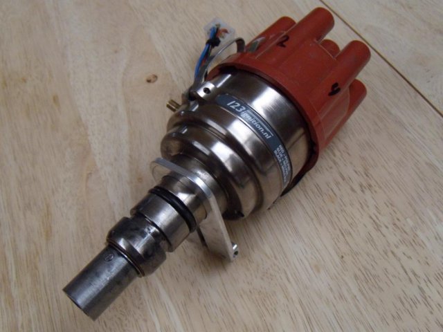

Bought this guy off of z240 (thanks Jim!) just before I made the valve guide discovery. I'd been planning to grab a 123ignition unit for a while now and got lucky with the timing ( ) of Jim deciding to upgrade to the Bluetooth version. Had time to take off the manifolds after work today so progress is being made. I can't have this thing sit again, hoping to have it ready by mid-July. I'm considering doing a few things while it's apart, like refining the fuel system, re-doing my carb linkage, and replacing the radiator (which I dinged when I left a wrench on the crank pulley and started it...).

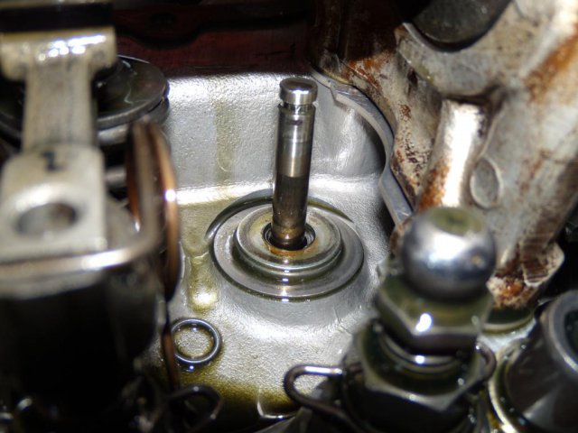

Well, had a bit of a setback today... I was hoping it wouldn't come down to this but the #1 valve guide was just flopping around underneath the valve spring. Not sure why it failed, maybe I was too ham-fisted when installing the stem seal? I did hammer them on with a socket, trying to be gentle as I could. I'm running the Ford seals which are good for 0.600"+ lift and my cam has 0.540". Anyway, looks like I'll be taking things apart again. Not that I mind much but time is hard to come by these days. I will be contemplating my options...

Got all my tools and parts in this week and finally had a chance to check compression today. Plug #1 was oily but the rest look OK. Compression #1-6: 192 / 180 / 170 / 192 / 167 / 180 I don't like the spread but the engine was cold, the hope is it's better warm. The numbers aren't terrible so things are pointing to the top end. I pulled the #1 rocker and lash pad out and that's where I'm at now. I plan to finish the job on Tuesday as I'll be gone camping until Monday. Happy Memorial Day everyone!
