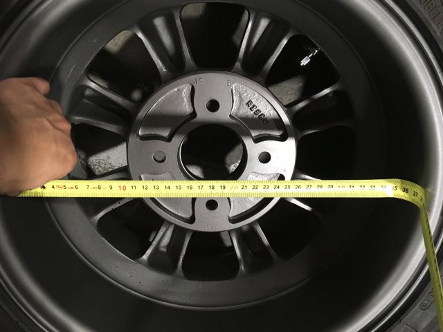

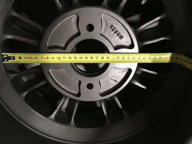

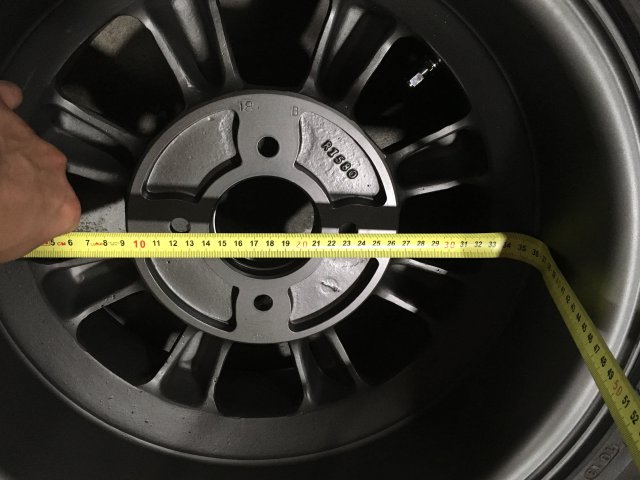

@lowrider Rough measurements are as follows: ID @ hub face = 315 mm ID @ ridge = 355 mm ID @ barrel = 365 mm 30mm from hub face to top of ridge I'm having the inside of the wheel 3d-scanned at work next week so that I can mock things up. I can send that data as well.

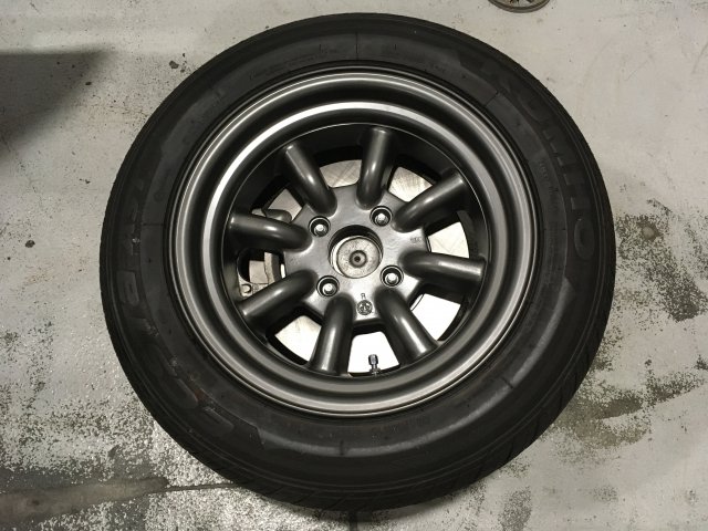

Thanks Ryan, frankly I didn't expect the brakes to fit. Just thought I'd try and see what happens. Test fit was done with 8mm spacers, it would probably clear with a 12mm spacer but the wheel poke would be ridiculous. I took a quick look at T3, looks like their kit won't fit 15" R-Types. In any case, I'm considering sticking it out with drums for now unless I find a cheap rear disk kit to hold me over. The end goal is to size some calipers and machine brackets and rotor hats to essentially make my own brake kit. I'm envisioning something similar to the ZCG "Big-Brakes for small wheels" kit but with an integrated rear park brake instead of the dual calipers. I also prefer blank rotors, especially on a classic car. I'd like to swap the struts over before the 26th and at this point, drums are looking like the path of least resistance (and cost).

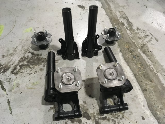

The struts are ready to go in! Laid down some paint and pressed in the bearings and Nissan Quest wheel studs. The bad news is that the rear disk conversion doesn't fit the 15" wheels... 😕 So the disk conversion is now for sale and I'm figuring out what to do about the rears. I've decided not to go back to drums so I'll be looking to get rear disks that fit under the wheels in relatively short order. I'd like to drive the car to Laguna on the new setup for the Monterey Historics on the 26th.
Well, turns out it don't fit! Anybody interested in buying this kit off of me? Everything is brand new, rotors are already re-drilled for 4-lug. $650 takes it.
