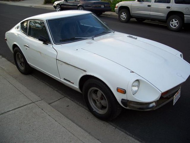

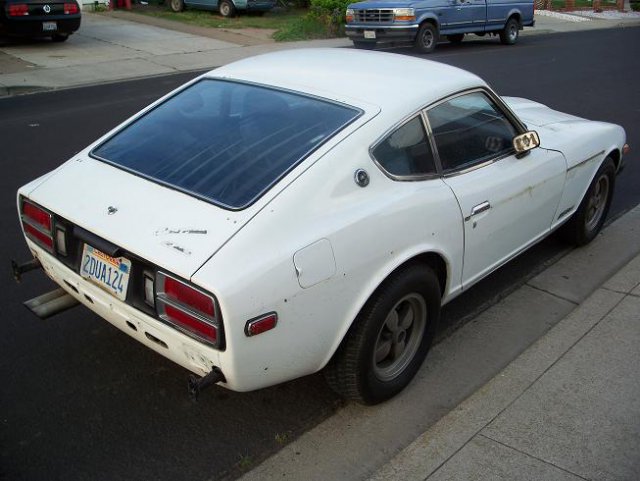

Yeah, if that is in fact my old car, there is some decent rust in the hatch area. I dont think it was all that bad though. Nothing that couldnt be replaced.
Thats got to be the same car. Does it still have the Falken tires on it? I can send you some pictures of when I brought the car home if youd like.
DUDE! No joke, I think that used to be my car, LOL. How long have you had it? I got the car stock and traded it stock, that bondo wasnt me . Would you be interested in selling me my cross member back ? This is too funny...

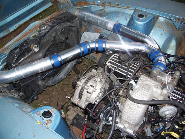

Another update found here http://forums.hybridz.org/showthread.php?t=129211 I went ahead and installed a regular T3 on the engine. The little IHI just wasnt physically big enough for a 3" exhaust. But now I should be able to acheive close to 300 HP at the crank. Its so close, I just need one more solid weekend to work on it, and it should be driving! 25 PSI here we come!

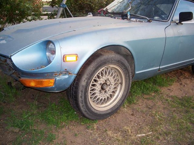

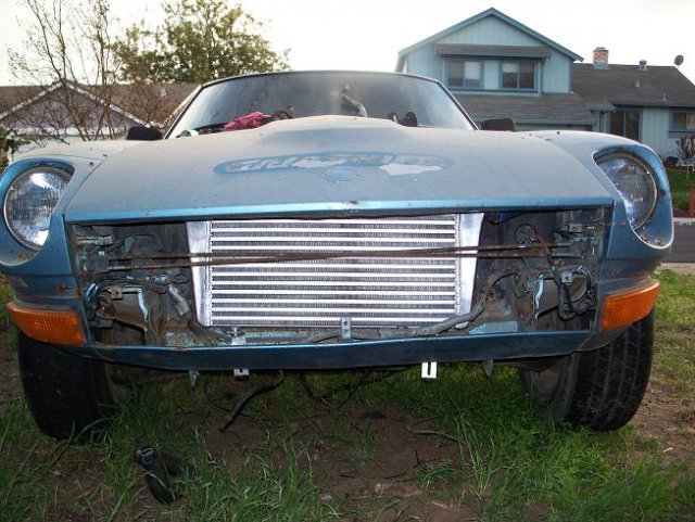

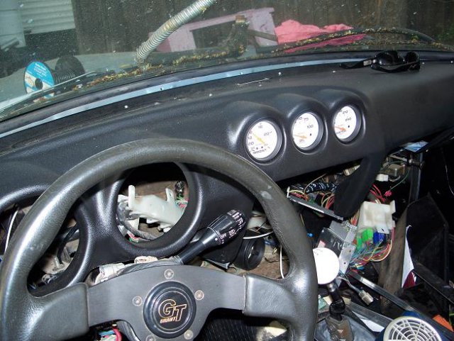

Update (Finally) 3-12-08 I have been working on the Z when I can. Its outside now, so I can only work on it when its nice outside, and Im limited to the weekends =( The gas tank is all done, the intercooler and piping are done, and all the wiring is done. It sputtered to life for a short while on starter fluid this last Saturday. It should run pretty sweet when I get around to putting gas in it You can see the wheels Im going to use. BBS 16x7 mesh wheels from a Lincoln Mark VII. They weigh about 17.5 pounds. Im converting to 5 Lug and using the vented Toyota 4x4 calipers. Im going with 225/50/16 in front, and 225/60/16 in back. The taller tire is on the wheel in the pic, so it looks really big. Also take a look at my dash. Its just the dash cap, I removed everything from underneath it and lost about 40 pounds. It looks great and its super light! I need to finish making brackets for the gauges, they are being made from alluminum. Im waiting for some brake parts to get here from Ross, and after I finish the brakes and make a driveshaft the car will be driving. I figure in the next couple weeks!

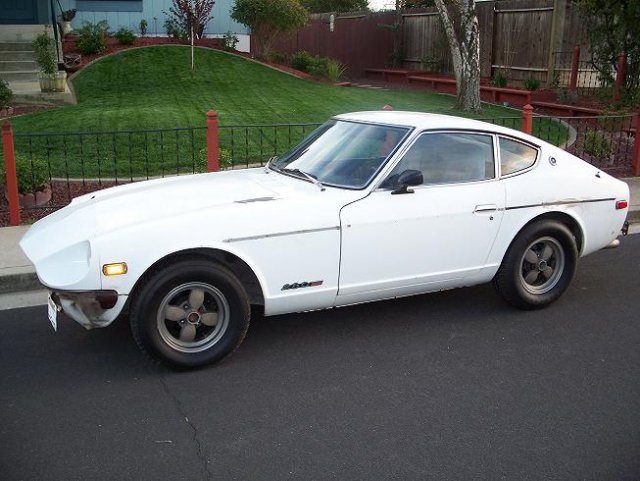

The car in the video had 280z style rear lights. Looks like an early 260z here in the states. -
For reference, I live in Central Cali and I bought a 260z about 4 months ago. Its an early one, has clean interior, not much rust, very few dents, and it ran great when I got it. I paid 1500 for mine. I would have paid 300 for a good rolling shell. I didnt need mine to run, but I paid extra for that and the interior. Assuming the rust isnt out of control (if its a CA car, Im sure its not bad) and there arent many Dmv Fees, I think its safe to say thats a good price.
