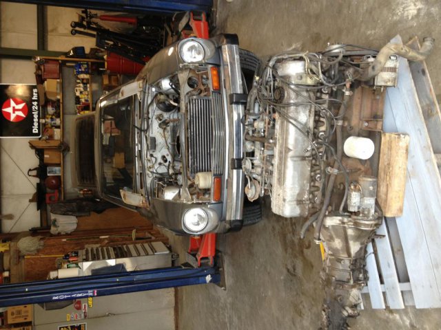

  8. Finally got down to business this weekend. I see a lot of work in my immediate future.
