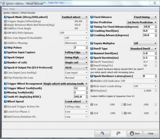

May have found something. Nominal Dwell in Ignition settings may be too low. Was set at 1.8ms in tune you downloaded. Guy may have been using a fast saturation coil like a Crane E-Coil. Should be around 3.0 ms for a standard coil ( Canister oil filled ) Pull the coil dizzy lead, crank it over and see how strong of a spark you get with setting at 1.8ms. If it is very weak it is likely the dwell is too low. If you have a good spark then leave it alone If spark is weak, change " Nominal Dwell " to 2.5 to 3.0ms. Start off low then slowly add time ( .2ms per change is good ) . Burn and cycle ignition. Then repeat spark quality test. Spark should be much stronger now. Coil saturation times vary greatly. Older style coils tend to be slower charging. You don't want to go too high though, as you can over heat the Coil and the Coil Driver ( BIP373 ) Spark duration of 1.5ms should be fine. DIY has an article on the BIP373 where they discuss coil dwell. They have a simple method to check if you've gone too high with dwell. The BIP373 do have built in thermal protection, so they won't burn out. They'll simply shut down. Here's the link to the article and the pertinent excerpt from the article: https://www.diyautotune.com/support/tech/other/bosch-bip373-ignition/

That sentence was why I thought the Fuel Pump was not working. Never mind the question about the Spark Output. Using D14 was on one of the drop down menu's in Decoder Wheel settings... but I think it's a misprint. All other MS Extra instructions say to use JS10. Edit: Confirmed it's a misprint in drop down menu. Archived Instructions for older build used D14. The 12v wire to the Dizzy CAS assembly handles milliamps. You don't want to run the trigger wires close to higher amperage 12v wires such as the injector 12v feeds, the ignition coil 12v lead or any main 12v power leads. That can give cross talk.

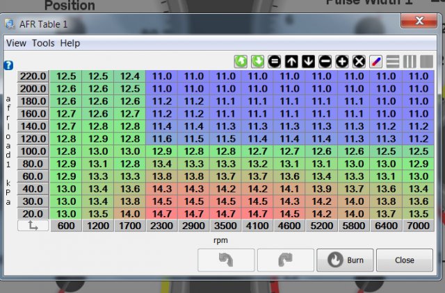

In case any one wants to take a gander, here are the AFR tables that I built. Pretty conservative, with cruise and low load cruise to be around stoic. Idle is always set a bit richer than stoic. As soon as the boost starts coming in I throw the fuel at it. 11.0 AFR is going to be nice and safe under boost. Should be fine for much higher boosts than he will be initially running. MerloZTune3.msq 2D Fuel Table: 3D Fuel Table:

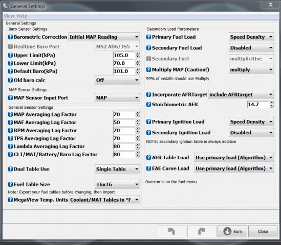

And see, I did miss post #22... cause I'm old and frequently post way too early in the morning. Yeah.. I went through all the fuel maps and ignition maps and corrected all the errors in the general settings. It's now a 2.8 liter motor with 260CC Turbo injectors. Garbage In... garbage out. A permanent fuel pressure gauge is a must have as SJ mentions. All the tuning in the world won't fix a hardware failure like a faulty FPR. Do get a Fuel gauge tee'd in there somehow, even if just for temporary use. You have to confirm the exact Fuel Pressure or all the fancy calculations goe out the window. An aftermarket FPR will be needed somewhere down the road, as I trust you will eventually be turning up the wick. Lack of CTS and having the warm-up enrichment enabled ( which was also scaled way too high ) would also make it Pig Rich. That was one of the biggest problems in your original tune. To OP: Don't tune by VE tables or change their values. You leave those alone ( once set correctly ) . You tune by altering the AFR tables. I've built you a good AFR table right off the bat. It will be safe and should run smoothly. Don't muck with it too much.... unless I built a pile of dog poo.... which I don't think I did. Same with the Spark Maps. I have idle set at 15 BTDC for a good reason ( Anti-Stall ), Car will run fine with that setting and Tune is built around it.
