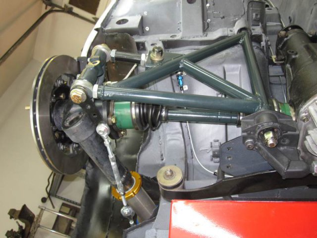

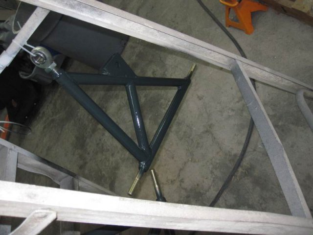

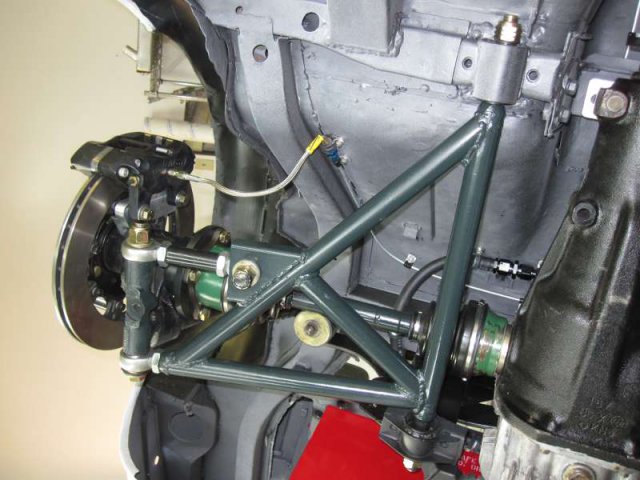

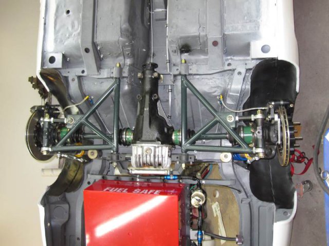

Finally back at work on the Z, these control arms were off the car while I was measuring for CV fitment, etc. Went to put them back on and decided to fix these. They were loaded radially on the threads, and I just didn't want to take a chance seeing as how I'll have 13" wide rear tires... I'll get better pics after the paint dries and I get them reinstalled, but here is a quick shot. Only took a couple hours to get them fixed up the way I wanted. Word of warning; if you hold onto a big ass corded 1/2" drill one handed and it grabs the threads, it will try to rip your friggin arm off. LOL If you hold it with two hands it might also rip the control arm out of your vice and slam it on the workbench. -

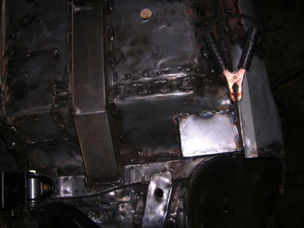

On a 240 they connect to the same frame rail that the front diff crossmember attaches to. In the front they slide over the frame rails up to the TC box. Here is a pic of the rear: -
