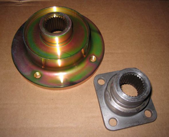

The problem with the 930 conversions is that they attach to the stock companion flange on the outboard end and the stock diff stub axle on the inboard flange, so you have huge CV's attached to a pretty flimsy flange. Attached pic is at the wrong angle to really see it, but the stock companion flange is about 3/16" thick at the flange and has a squared off connection to the splined part. Your CVs might hold 1000 hp, but that part won't. Sunny, if your car is bottoming like I think it is, that can sharpen the impact of driveline shock and cause more problems. -
