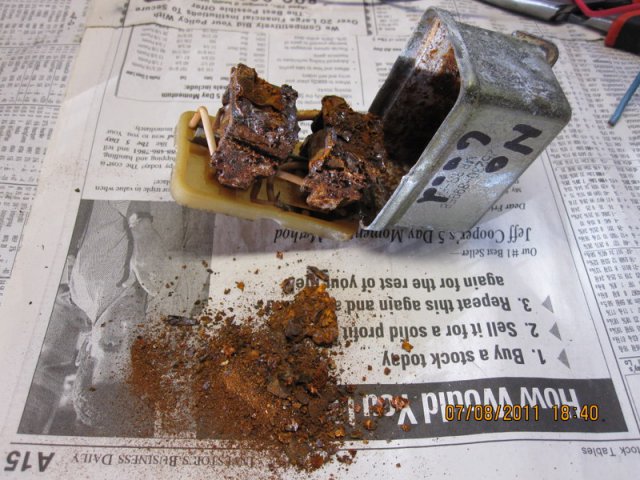

Where do you buy a Fuel Pump Control Relay?
NewZed replied to k204drek's topic in S30 Series - 240z, 260z, 280z
Have you tested the one you have? Pretty easy to do with a battery, some jumper wires and an ohm-meter. You can pry the tabs back on the case also, and take it apart if you want to check the guts out for rust and corrosion. -
