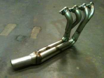

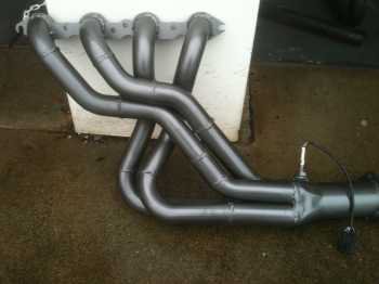

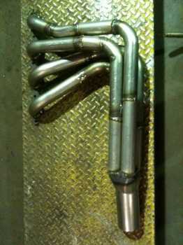

your extractors are look great been long time coming to see this happen in a group buy but sure you will all love results when you get them fitted I was very frustrated burning plug leads with my JTR lhd header so finally bit bullet and built my own long tubes to suit rhd car just a suggestion and not sure if it is possible with your lhd cars have pic below of how i made my lhd side trying get as close as possible to equal length tube does mean i have to remove oil pressure sender to fit to car but other wise it slides in from bottom fine also picture of rhd side showing gap for steering made in 3/4 tube -

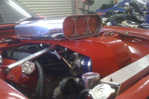

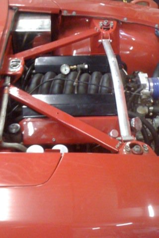

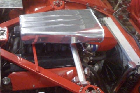

One thing i never liked about the ls1 was the coils on the rocker covers so i made some covers up thought might cover some of the wiring and heater hoses while i was at it at same time decided to put bug catcher back on car missed that lump in the bonnet and should be best cold air induction What do u think im very happy with way it all turned out mick
