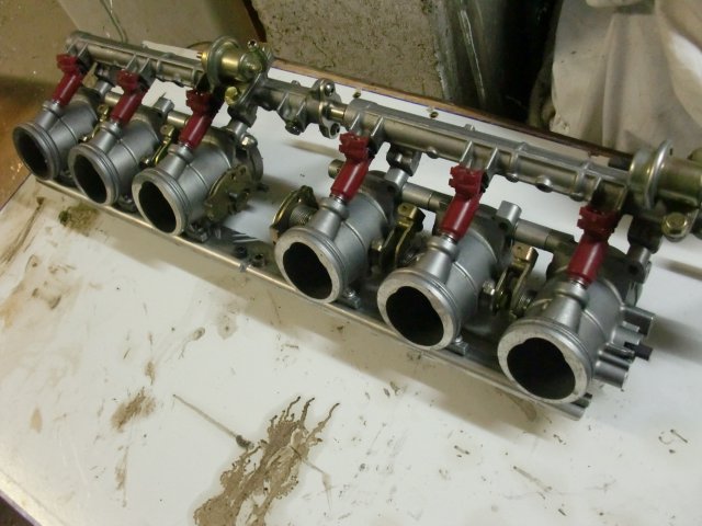

z-ya Posted September 14, 2011 Share Posted September 14, 2011 (edited) Stock N47 head (no porting), .460 lift / 280 deg duration cam, stock springs and valves, cast flat tops: Solid line is dual TB SU manifold. Dotted is stock EFI manifold. 180WHP is easy, streetable, and reliable. Edited September 14, 2011 by z-ya Quote Link to comment Share on other sites More sharing options...
