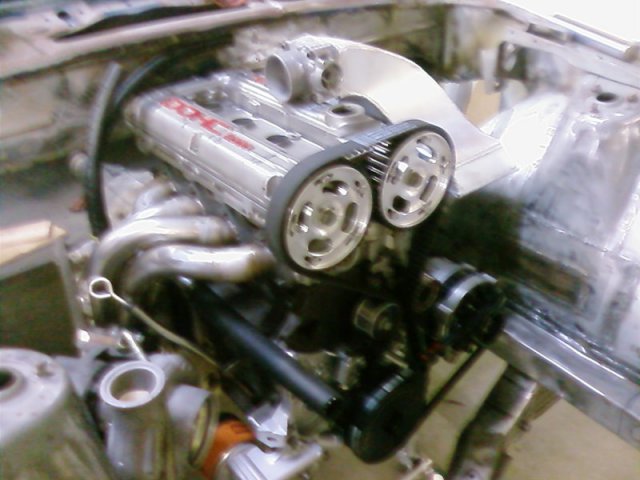

ckrell Posted February 11, 2012 Share Posted February 11, 2012 4G63 and I'm moving the battey and cooling system to the rear of the car Quote Link to comment Share on other sites More sharing options...
BlackdogNY Posted February 11, 2012 Share Posted February 11, 2012 I would be interested in any info/pics of your cooling system relocation. I had always thought it would be a good idea. I thought thru radiational cooling of the lines, only a small radiator w/electric fan would be needed(at low speeds). Once you get going, ducts from quarter windows would handle air flow to the radiator. A concern may be how to get the hot air out. vents in the hatch would let water in and aero wise I am not sure. Vents to behind rear wheels may work, would look cool if done right. Anything to rear of car I think would not work, from everything I have read about smelly exhaust in cars. Should be a great way to move weight back/ clean up engine bay. Not a daily driver mod. Quote Link to comment Share on other sites More sharing options...
