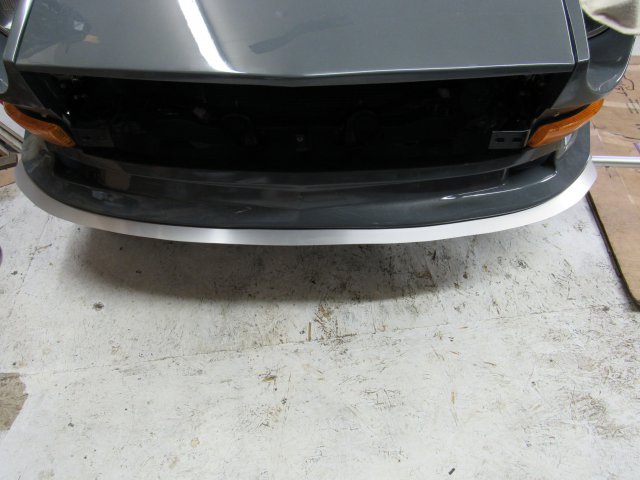

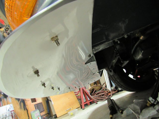

grannyknot Posted July 24, 2017 Author Share Posted July 24, 2017 The splitter looking lip attaches to the bottom of the air dam and extends back to the frame in front of the radiator, the real job it's doing is keeping the flexible urethane air dam from flexing. Without the lip I put on it there is no rigidity. Quote Link to comment Share on other sites More sharing options...

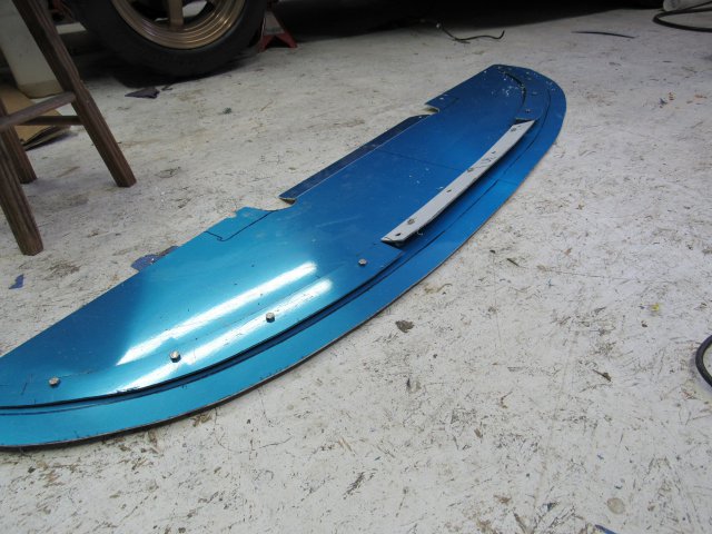

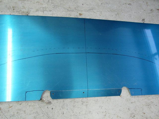

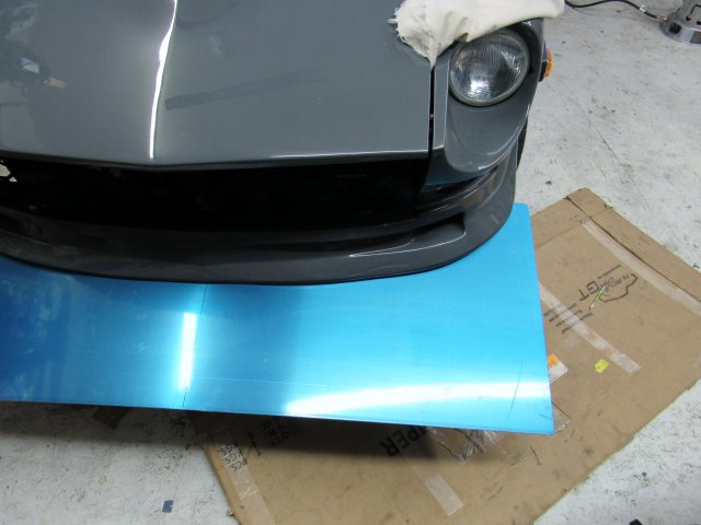

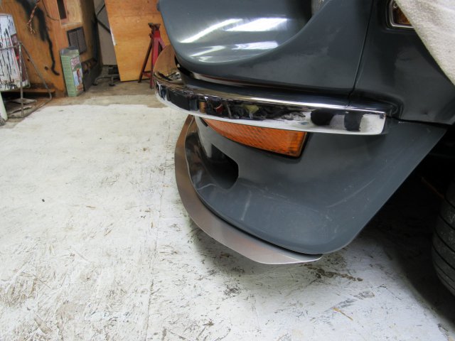

grannyknot Posted February 18, 2018 Author Share Posted February 18, 2018 Been a long time since I up dated this thread, since the last post I spun a being at the track, had the engine rebuilt. That's what the track is for, to break things. Over the winter got a chance to clean up some things that I fast handed last year just to get it on the road. The last oil analysis reported a lot of sand and dirt in the oil so I got rid of the K&N filter and picked up a real paper filter from a 2008 Mustang, On 7/24/2017 at 1:27 PM, Neverdone said: What did you put on the front lip? That looks great btw! You know I never liked that splitter that I made last year, it wasn't wide enough to reach to the sides, so had another go at it. I'm going BOSOZOKOU ! Made some new clam shell pieces to clamp onto the bottom lip of the air dam, Quote Link to comment Share on other sites More sharing options...

rossman Posted November 1, 2019 Share Posted November 1, 2019 On 2/18/2018 at 5:41 PM, grannyknot said: You know I never liked that splitter that I made last year, it wasn't wide enough to reach to the sides, so had another go at it. Wow, that looks great! Does it simply clip over the top and bottom of the lip and capture it? I also have the same flimsy urethane air dam. Quote Link to comment Share on other sites More sharing options...
grannyknot Posted November 1, 2019 Author Share Posted November 1, 2019 6 hours ago, rossman said: Wow, that looks great! Does it simply clip over the top and bottom of the lip and capture it? I also have the same flimsy urethane air dam. Yes, it's very simple or maybe even crude but it does keep the urethane air dam from bending at speed. Quote Link to comment Share on other sites More sharing options...

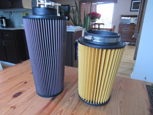

grannyknot Posted December 16, 2019 Author Share Posted December 16, 2019 Okay so I'm dragging this one back out because big changes are happening, the S38 engine experiment was a success in many ways and in a few ways not so much. So I pulled it and sold it on BaT, wonderful engine but it is just not supported anymore. I have rebuilt the e46 S54 M3 engine and that will be the new power plant. So far the swap is going well, the engine is in, transmission and diff are lined up and the custom driveshaft is being built right now. I should have it back in a week, next step is to have the BMW ECU re programed to eliminate all the extras that aren't needed and set to wiring it up. I finally got around to making the top of the radiator support removable, considering how often the engines come and go it will be a big help, just have smooth it out, do some filling/sanding and try to match the paint. The original intake airbox sticks right out into the shock tower and also had problems with the #1 and #6 cylinders having uneven access to air so I have opened it up will try to fabricate a custom funnel to the air filter. @carbuilder723, was nice enough to sent me the drawings for Ron Tyler's BMW engine mounts and after making cardboard mock ups of them I could see they just weren't going to work for my swap, not sure why. So I made a couple of rough mounts and once the bulk of the work is completed on the swap I will take them off and clean up the welds and finish them a bit more. Quote Link to comment Share on other sites More sharing options...
