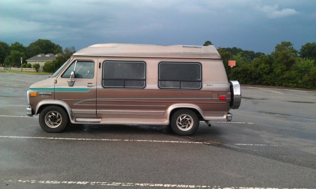

jhm Posted May 7, 2015 Share Posted May 7, 2015 Ditto what RebekahsZ and JohnC said. I use a '92 G20 conversion van I picked up for less than $3K. It's long and heavy for towing; it's got a 350 with a 700-R4 for semi-decent mileage; and it's decked out inside for weekend camping at the track. I also use my 3rd gen 4Runner for occasional day trips to the track, but would never use it for trips with a lot of elevation changes. The auxiliary trans cooler (for auto) is pretty much a must. And contrary to what you may hear from some folks, it's better to run it inline with the side- or bottom-tank trans cooler integral with most modern OEM radiators. The coolant on the cold side of the radiator is typically 30-40 degrees cooler than your engine temp, and contributes significantly to cooling the trans fluid. It also assists in getting the trans fluid up to correct operating temperature after a cold start. Always route your trans cooling lines so that the fluid is being pushed up (against gravity) whenever possible....that will ensure maximum cooling effect from your cooler(s). Quote Link to comment Share on other sites More sharing options...
