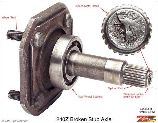

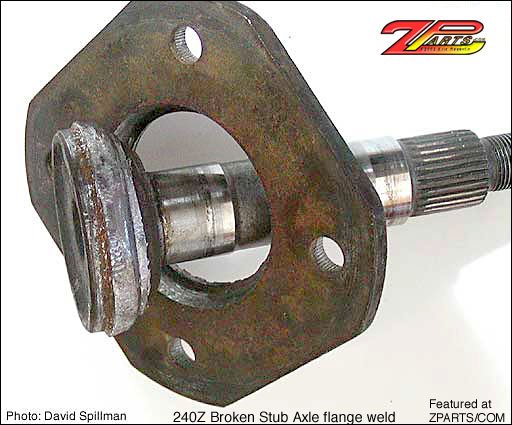

Miles Posted July 29, 2015 Share Posted July 29, 2015 (edited) NewZed is correct. My stub axle broke where the threads meet the splined portion of the axle. They also fail where the wheel mounting flange is welded to the axle. See pictures. Also, the flange is soft and easily bent. Not so much of a problem with drum brakes, but with disk brakes it caused the pads to drag on the rotor so I replaced them Modern Motorsports stub axles: http://www.modern-motorsports.com/stub-axles.html Edited July 29, 2015 by Miles Quote Link to comment Share on other sites More sharing options...
Eric JB Posted July 29, 2015 Author Share Posted July 29, 2015 Thanks for the responses. Looks like either way, the wheel and tire are going to do some damage to the fender well. Or walk out and exit the vehicle. Not good. The bad thing about doing CNC turning for 25 yrs+, Is justifying $750.00 for something I could knock out in 4 to 6 hrs.(not including splines and heat treatment) But where does one find the time. Seems like the MM/ Checkered flag stubs are good insurance. I run the car in NHRA div 6 in sportsman. The cutoff is 12.00 flat, so if I do any upgrades to it, it will be too fast for the class. So I'm at the crossroads on whether to touch it or not. Quote Link to comment Share on other sites More sharing options...
