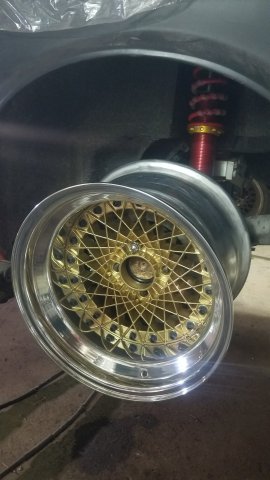

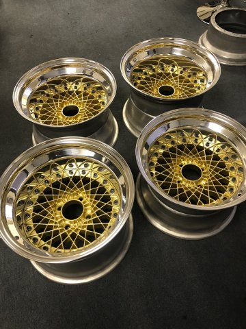

Exposed Posted March 8, 2018 Author Share Posted March 8, 2018 (edited) For the past little bit I was bouncing back and forth between the idea of cutting up the body and adding flares or leaving them as is. I had bought myself a set of diamond racing wheels but they ended up rubbing on the caliper after switching to wilwood calipers. So instead of running a little spacer I figured I'd just waste money on a proper set of shoes. Placed an order and the guys did a great job on the barrels and the refinish, the wheels came out amazing! now I just need to find or make a decent set of flares to go with it. And just when I thought winter was over, BAM a blizzard hits.... Edited March 8, 2018 by Exposed typo Quote Link to comment Share on other sites More sharing options...

softopz Posted March 8, 2018 Share Posted March 8, 2018 Those wheel are timeless ! what size are they and if you dont mind me asking. Quote Link to comment Share on other sites More sharing options...
Exposed Posted March 8, 2018 Author Share Posted March 8, 2018 @softopz two of the wheels are 16x10 with 5" outer barrels the other two are 16x10.5 with 5.5" outer barrels. It leaves me with about 1.5"~2" of space from the coilovers. I can take exact measurements if you'd like. Quote Link to comment Share on other sites More sharing options...
Zetsaz Posted March 8, 2018 Share Posted March 8, 2018 Those look so good! I've always loved 3 piece mesh wheels. SSR Formula and the Southern Way Epsilons are so good. I've been considering pretty much the same scheme you went with but have never been able to mentally commit to cutting for flares so I'd probably do it under stock flares with narrower wheels. Great purchase! Excited to see how they look once the whole thing is on the ground. Quote Link to comment Share on other sites More sharing options...

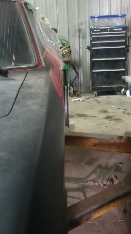

Exposed Posted March 8, 2018 Author Share Posted March 8, 2018 (edited) 7 hours ago, Zetsaz said: Those look so good! I've always loved 3 piece mesh wheels. SSR Formula and the Southern Way Epsilons are so good. I've been considering pretty much the same scheme you went with but have never been able to mentally commit to cutting for flares so I'd probably do it under stock flares with narrower wheels. Great purchase! Excited to see how they look once the whole thing is on the ground. I know where your coming from, I've been trying to prepare myself to cut the fenders up. I'm probably going about it all wrong though, I haven't committed and buying wheels like this.... That's also why I wanted to try making some metal flares and keeping it looking stockish Edited March 8, 2018 by Exposed Quote Link to comment Share on other sites More sharing options...
