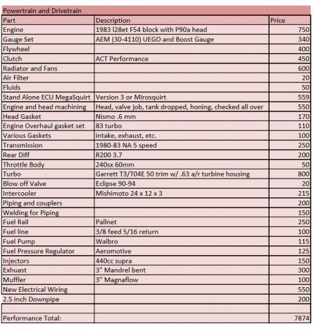

Shanks Posted May 31, 2017 Share Posted May 31, 2017 This is my 2nd 240Z project. First one was kept original, this project is a restomod. Car will mostly be driven on the road and taken to shows and a track occasionally. Really don't want to do a build project if it's going to end up being slower than today's stock sports car from the factory. I put together a L28ET build a while ago for my 71 240z. PDF attached with the rough details. My goals were to try my best at breaking 400hp at the dyno, but after reviewing similar set ups here on this forum I am wondering if I can really make those numbers with my build plan. What say you? If not, I am considering doing a 3.0 stroker, which would add at least 3-4k to the cost based on my current estimates. At that point, the total performance expenses would be around 12k or more plus unexpected costs. The stroker would put me well over 400hp (which I would be very happy with), but I would also need to spend more money on strengthening the chassis at that point, and if I wanted more HP down the road it would be tough to squeeze any more out of it. If I am willing to spend 12k on the engine alone, would I not be better off going with an RB25DET or 2JZ? It seems like either of those platforms would actually be cheaper than a stroked L28ET and for the same money I could get a lot more power. (I have separate sheets for my brake and suspension needs, but ignore that for the sake of this topic.) Quote Link to comment Share on other sites More sharing options...

malibud Posted May 31, 2017 Share Posted May 31, 2017 Damn when you spell it out like that cost add up quick. (note: I am no expert but...) at 400hp that trans is going to break. I think 300 is really doable and damn fast for 2300lb car. That is where I guesstimate mine at 15lbs. At 400lb you are pushing cast pistons and may need some port work and a good tune/meth injection. 12000k to spend you might as well go 2j or rb30. TimO knows high HP L28 Quote Link to comment Share on other sites More sharing options...

Shanks Posted May 31, 2017 Author Share Posted May 31, 2017 At this point I think I am really just looking for someone to confirm that for around 12k I would get more power out of a 2jz than a L28et. Not really interested in other platforms I think. Transmissions for 2jzs are stupid expensive. Quote Link to comment Share on other sites More sharing options...

seattlejester Posted May 31, 2017 Share Posted May 31, 2017 Honestly do what you want. Will you be happy with the, easier, cheaper, faster, different option? Unless your end game is just a number, sit down and think what you want to do. A couple points: Complaining about transmission options is moot. Once you step out of the 200-300hp range chances are regardless of the engine you are going to have to step up to a beefier transmission option whether that is the CD009, R154, T56, etc. The 0.2 Liters of displacement really isn't going to push you over the edge there. That money would be much better invested in a better flowing turbo/performing turbo. Spend $200 more on the turbo and save 3-4k... Obviously I'm biased, for bang for buck, probably the 2jz is going to be an easier route once all is said and done. More parts readily available, machine shops can order bearings and such straight out of a catalog, etc. My list approximated 1jz bell housing - 300 1jz flywheel - 300 stage 1.5 clutch kit - 400 rear sump oil pan - 300 engine mounts - 300 oil feed and drain kit - 150 FFIM - 100-700 Turbo manifold - 400 Turbo - 900 Gaskets - 450 That is 4k or so right there not including the motor That doesn't even include the parts I already had Coil packs - 150 ECU - 500-2000 Injectors - 100-400 Throttle body - 50 Intercooler piping - 150 Blow off valve - 50-150 Intercooler - 50 Starter -100 R154 transmission - 800 Custom drive shaft -300 Exhaust - 150 AN fuel lines -150 Fuel cell -200 Diff - 200 Axles - 600 ~5k or so? So possible, but you are going to get hit with a lot of unexpected expenses. I really wouldn't try and do a big swap like that, you definitely are going to loose motivation. At the end of the day it depends on what makes you the happiest when you open the hood. Quote Link to comment Share on other sites More sharing options...

Chickenman Posted May 31, 2017 Share Posted May 31, 2017 I'll throw my Hat into the ring. 1: Buy 2 F54 Turbo blocks. Freshen one with just rings, a quick ball hone and bearings if needed. This is going to be your " Mule " testing block while you sort out your Fuel injection and Tune. Don't spend a lot of money on this block as it will be a scarificail Lamb for mistakes. 2: Slowly build your " Good " engine block with all the good components. If you want a reliable 350 to 400+ HP, this is the engine that your put the Forged pistons in. With a Turbo, you don't need a stroker and you don't need to turn big revs . Revs = $$$$$ Stock polished rods with ARP bolts are very strong and can easily with stand 500 HP. 3: MS 3 is OK... but there are better systems out there. Try and pick up a used Haltech, Link or Adaptronics. 4: ACT clutch would be my last choice. Seem to be a lot of quality control issues with ACT. Same with Spec. Go with South bend or Clutchmasters. BT VW/Audi guys find that South Bend and Clutchmasters seem to be the most reliable, short of Multi-Plate Tiltons. Quote Link to comment Share on other sites More sharing options...
Chickenman Posted May 31, 2017 Share Posted May 31, 2017 Here's a video from one of out local Road racers using an L28 with a fairly simple Turbo setup ( T3/T4 ) . 400 HP reliably at 15 lbs boost and basically a stock block with forged Pistons. No trick internals ( other than good Forged Pistons ), stock stroke and bore .040" over. Stock rods ( Polished and shot peened ) with ARP studs. Stock crank. Everything has been balanced of course. Note: Trans-AM that passes him is a local Hillclimb car with over 500 HP. Keeping revs down ( 6,500 max ) is one key too longevity. Turbo cars do not need big revs to make power. Watch at 1.14. That's what 400 HP does on a Race Car with soft Goodyear race slicks. Should be enough for any street car. https://www.youtube.com/watch?v=1BiF8-kIZCk&feature=share Quote Link to comment Share on other sites More sharing options...

Shanks Posted June 1, 2017 Author Share Posted June 1, 2017 (edited) I really dived into creating a parts list for the 2JZ build tonight and would love to do it, but the more I look into it the more I am realizing, while I could do it and would love it, I am not sure I want to spend that kind of time and money on the 240z, no matter how much I love it. For the 2JZ it would involve a significant amount of additional fabrication as well as higher costs all around in other departments, especially labor as I just don't have the time to learn and do this myself. I would rather make sure I take care of my retirement goals every year and have a kick ass L28et I can put right in myself and have the project finished in a few months if I want to. The diminishing returns I would get for the amount of work for an extra 100 or 200 HP doesn't make sense on the 2JZ, but I did enjoy the feedback from you guys so thanks for your input! There's nowhere like here to have a good convo about these cars. I tried to give out some likes but I don't have the rep I'm afraid. Edited June 1, 2017 by Shanks 2 Quote Link to comment Share on other sites More sharing options...

Alex_V Posted June 1, 2017 Share Posted June 1, 2017 400hp is fairly straight forward with an L28 I don't know why people make it such an impossible task. Really its just a airflow bottle neck problem, which with a stock L28 is the ports themselves which a lot of people take care of, then the stock tiny cam and then the intake manifold runners need ported themselves. There is TONS of info on making a powerful L series here on this very forum. I've done months and months and months of research and Im building a 500+hp L28ET. No stroker yet, but a rebuilt stock bottom end (arp rod bolts is the only real upgrade) and I'll be playing around with porting the head, intake manifold, exhaust manifold will easily get me over 400whp, with a nice balanced power band. Ie similar HP and TQ and not an over abundance of torque down low and fading in the top end. I also have will have two L28ets and the second one will be forged. First one is to get in the car and back on the road again after a few years of sitting. ~Alex Quote Link to comment Share on other sites More sharing options...
