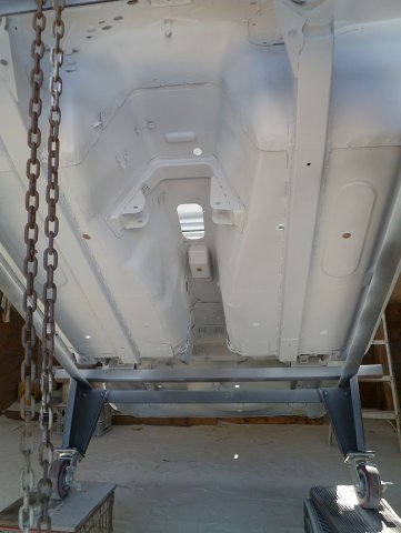

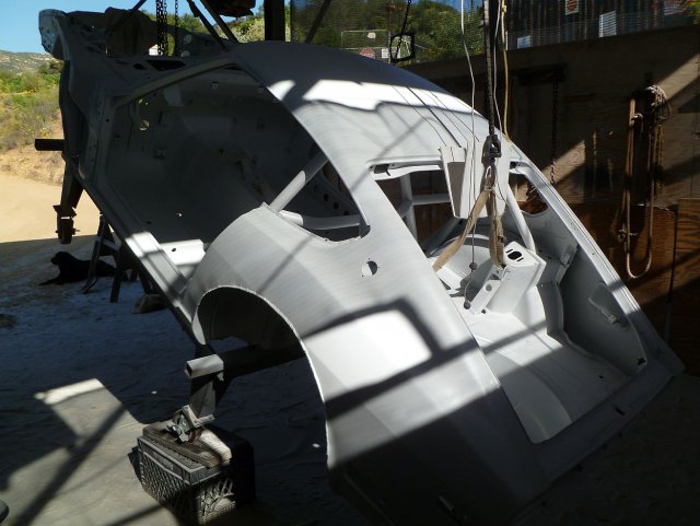

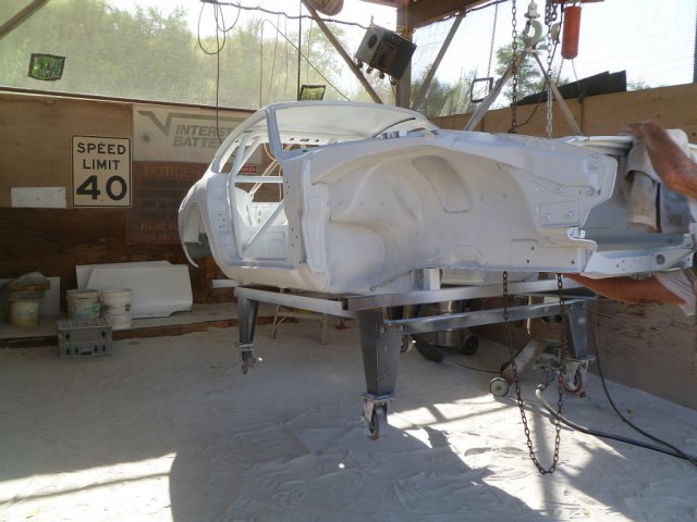

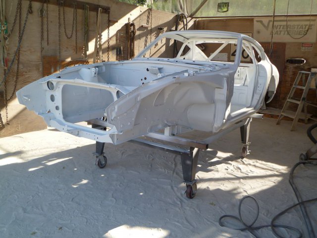

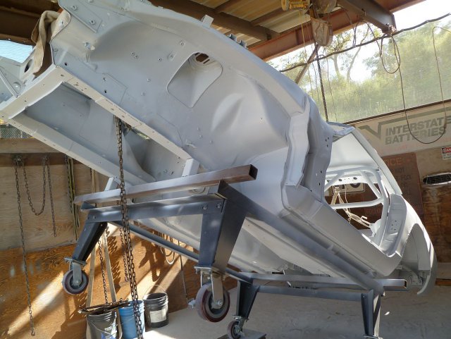

It would be a tough pill to swallow going back on what you have already achieved, however all metal would be rid of rust. I know all too well about one step forward and three steps back as I have made a few costly mistakes along the way on my build, er, um Z build education. I had my car immediately epoxy primered by Bob the blaster using Endura epoxy primer. The car was on his car port in Jamul with body repair started for roughly 4 months with only a blue tarp and bungee cords holding it on. I then moved the car to my body/paint guys garage in El Cajon for a long while then had to move it to a rental garage in Chula Vista close to the San Diego harbor/ocean where it has been for at least 2 years. I have not had any re-rust issues I am happy to say so far. I have had alot of sand come out of the hidden cracks however as the car has been flat bed or moved on a car hauler from south SD to North county SD no less than 4 times n the highway. Hopefully most has shaken itself loose by now.
I had an older gentleman who has been blasting for most of his life do the work and still had minor signs of warping. My body guy was not that pleased with the work ahead of him to get all straightened. It would be a tough decision to make to dip then epoxy, undercoat seam seal, but without a doubt will have eliminated all internal rust without warping any panels in the process.

Actually I suggested blasting because you had already done the bottom, I had my Z dipped, the shell and the hood. If I were to do it again I would have done as much as I could of the body work and rust patching BEFORE the dip. The car was sprayed with a water soluble rust inhibitor immediately after the dip which is good for a week maybe two then it starts to rust so you have to be fast.
I used the Eastwood inner frame spray to coat all of the areas you can't see or get to then 2 part epoxy primmer for the rest of the car. These pics were taken hours after it came out of the neutralizing tank.
