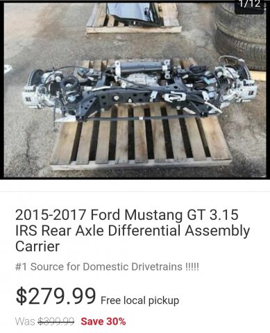

Invincibleextremes Posted November 8, 2019 Author Share Posted November 8, 2019 Entire rear subframe can be had for anything from 500 to 1200 plus freight. Just the bare diff itself ranges from $100 to $900 and is available in 3.15, 3.31 all the way up to 4.09 factory. Aftermarket 4.56 gears are also available. The most common ones are 3.15 from a v6 rental and 3.31 off an ecoboost. Ebay is full of them, ALL have lsd but some even come with torsen. Quote Link to comment Share on other sites More sharing options...
Invincibleextremes Posted November 8, 2019 Author Share Posted November 8, 2019 Here's a couple examples I pulled off ebay... took less than 5 min to find. Quote Link to comment Share on other sites More sharing options...
Grpkewlaid Posted November 8, 2019 Share Posted November 8, 2019 (edited) 19 hours ago, Tonythefish said: Have you sourced the super 8.8 assembly? Just curious what they get for them and what stock gear ratio are available out there.. Yes, I got a 3.31 iron housing (manual trans car) from LKQ. Prices at LKQ for the diffs alone are pretty cheap, they go from $220-$600. Mine has 67k miles on it and was advertised at $260. They charge more for those labeled "clutch type lsd", but as said above, that's what they all are aside from the torsen ones. Edited November 8, 2019 by Grpkewlaid Quote Link to comment Share on other sites More sharing options...

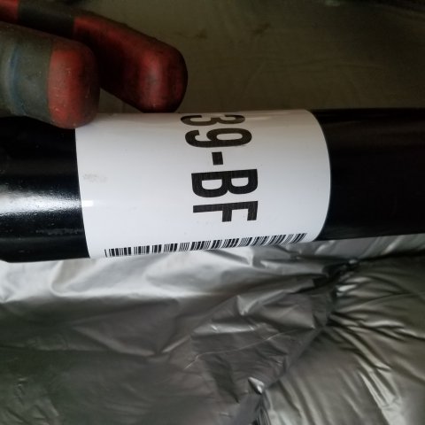

Invincibleextremes Posted November 8, 2019 Author Share Posted November 8, 2019 (edited) Btw... axles ending in BF also work. Here's a video on the updates. Edited November 8, 2019 by Invincibleextremes Quote Link to comment Share on other sites More sharing options...

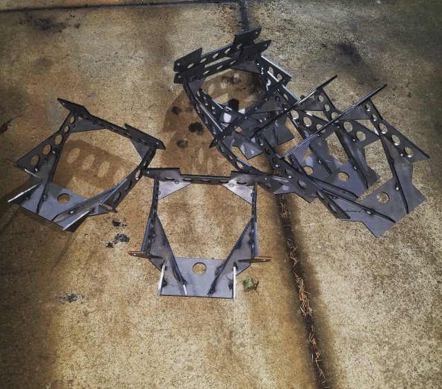

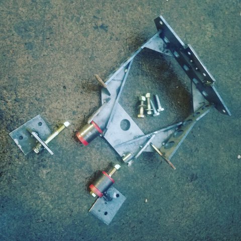

Invincibleextremes Posted December 12, 2019 Author Share Posted December 12, 2019 This one going out in the morning, itll still need to be tied into the notched crossmember, and fully welded up. Jig for the cradle is built so it's going very smoothly so far. Quote Link to comment Share on other sites More sharing options...

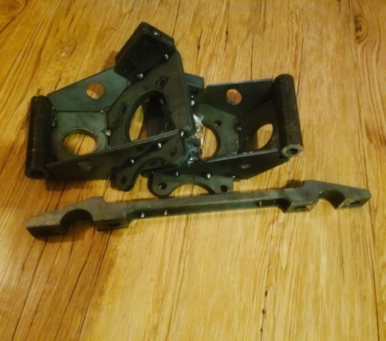

Invincibleextremes Posted January 29, 2020 Author Share Posted January 29, 2020 V 2.0 of the uprights. Same design, even more camber adjustment and shed a little weight while still keeping most of its strength. And let's face it, "most" of it's strength is still head and shoulders over what else is out there. Quote Link to comment Share on other sites More sharing options...

Invincibleextremes Posted February 3, 2020 Author Share Posted February 3, 2020 Test fitting kits on my spare 3.31 lsd diff. That crossmember is optional and is for people not wanting to notch their own factory front LCA mounts like we did on David's car. Quote Link to comment Share on other sites More sharing options...

Invincibleextremes Posted March 9, 2020 Author Share Posted March 9, 2020 Heck ya, axles looking good. Btw, 2018 mustang stick v8 cars are using gt350 axles. Gt350 axles are basically the same right axle, but the left has been increased in diameter and cv size. They will not work for this conversion. So you need v8 axles 2015 to 2017 and 2018 must be v8 automatic axles. 1 Quote Link to comment Share on other sites More sharing options...
