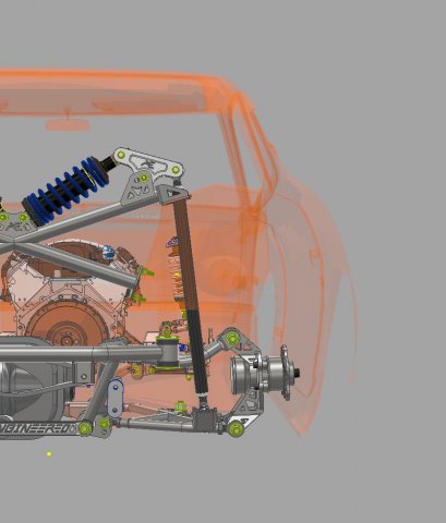

Jeff Posted July 26, 2019 Share Posted July 26, 2019 Nothing really anything to add but here is video of the first one that went into a customers car. Hellcat Z Link to comment Share on other sites More sharing options...
LooseRocks Posted July 26, 2019 Share Posted July 26, 2019 The OP is looking at the "Rear Suspension Conversion". The HellZ uses the "Track Attack - Complete Rear Suspension". Link to comment Share on other sites More sharing options...

LooseRocks Posted August 2, 2019 Share Posted August 2, 2019 First block of quotes references my questions with regards to Rear Suspension Conversion. The second block of quotes are answers for the Rear Track Attack. There are no push rods in the Rear Suspension Conversion. You would probably get a better response from him if you contact Apex directly through e-mail. He's very responsive. Kudos on him for that. Link to comment Share on other sites More sharing options...
toolman Posted August 2, 2019 Share Posted August 2, 2019 (edited) To me, Apex Engineering did an excellent job on both front and rear suspension upgrades. Considering the upgrades are basically a bolt on kits, a lot of thought went in its design. The only problem that I can see is having the rear coil overs operating in the hatch area. In a race car, the noise and danger from moving parts in the passenger compartment would not be a problem. In a street car, those problems would arise. However, maybe they thought of it and have conventional struts that would work instead. Awesome design. I would consider using the rear upgrade as I will have a Rocket Bunny Body Kit. Edited August 2, 2019 by toolman text Link to comment Share on other sites More sharing options...
Ereschkigal Posted August 2, 2019 Share Posted August 2, 2019 (edited) From the pictures on the website (normal conversion kit) and the posted race kit, it looks like only the race kit has the coil overs in the hatch area because you can see the typical flange on the hub for coil overs compared to the picture in this thread with a different position and the higher arms for the hub. Edited August 2, 2019 by Ereschkigal Link to comment Share on other sites More sharing options...
