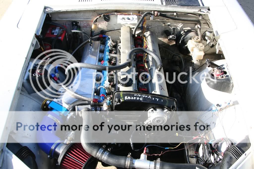

MERCDRAGON Posted October 6, 2009 Share Posted October 6, 2009 I finally got to drive my car for the first time this past Saterday. After 9 months of off and on work on the weekends while also going to school, the car is pretty much done (for now), and it feels great. There are still a few things to do before I drive it regularly but the car is a '72 240Z and the engine is an RB30DE with the non-VVT RB25DE head and it has lots of other goodies as well. The Engine: The Car: Thanks to everybody for all the information you have posted over the years and to those that helped me on my specific questions, you have all been a great help in completing my project. Quote Link to comment Share on other sites More sharing options...

monster260z Posted October 6, 2009 Share Posted October 6, 2009 Im building an rb30dett at the moment i was just wondering how you went with the na engine we get them very cheap here i picked my short block up for 10.50 on ebay I had thought about an n/a rb30de and to run the triple throttle bodies from the rb26 It would look and sound awesome This is my rb30/26 dett combo Quote Link to comment Share on other sites More sharing options...
MERCDRAGON Posted October 6, 2009 Share Posted October 6, 2009 You should recheck your info kramerbuccs24. The RB30 was sold in the R31 Skyline and the Holden Commedore, and that was with a single cam head. Dual overhead cam RB30's were put in the Tommy Kaira M30 and used in racing applications. Somewhere, I think it was in New Zealand, there is a guy with one like mine except set up for track use and he made something like 380hp (I think at the wheels), so I would say that they can make pretty good power in NA trim. Quote Link to comment Share on other sites More sharing options...

MERCDRAGON Posted October 6, 2009 Share Posted October 6, 2009 -monster260z I imported the 30 block and then just dropped the non-VVT RB25DE head on. this head is a direct bolt on, no mods required. The 26 and 25DET heads can be used with some modification (for the 25DET it's pretty easy but I got the 25DE motor for $250 so that was a simple choice, and the 26 head requires quite a bit more modding than the 25DET head). The only problem is that the intake manifold bolt pattern on my head is that of the RB20 but with bigger ports so to get a nice manifold I had the ports and about 3 inches of the runners cut off the original manifold and welded to the aftermarket plenum (you can see the welds in the picture). Quote Link to comment Share on other sites More sharing options...
